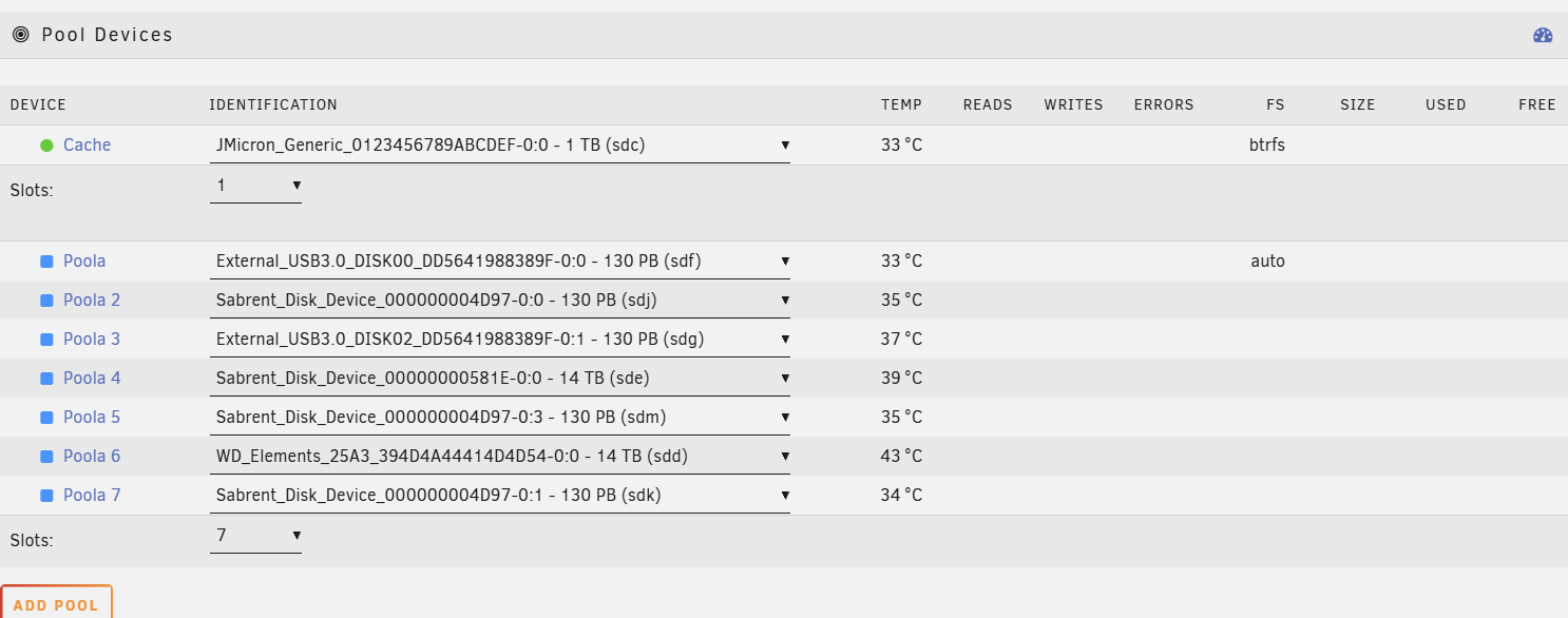

I stopped the array, removed the pool, shut down Unraid. Changed a drive to a new caddy slot.
Restarted Unraid. Recreated the pool with seven slots. I added each one back (including the now renamed one). I did stick with the same order.

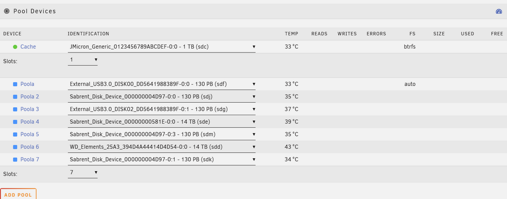

When I started the array, it dropped to SIX devices - leaving off the LAST item I added!

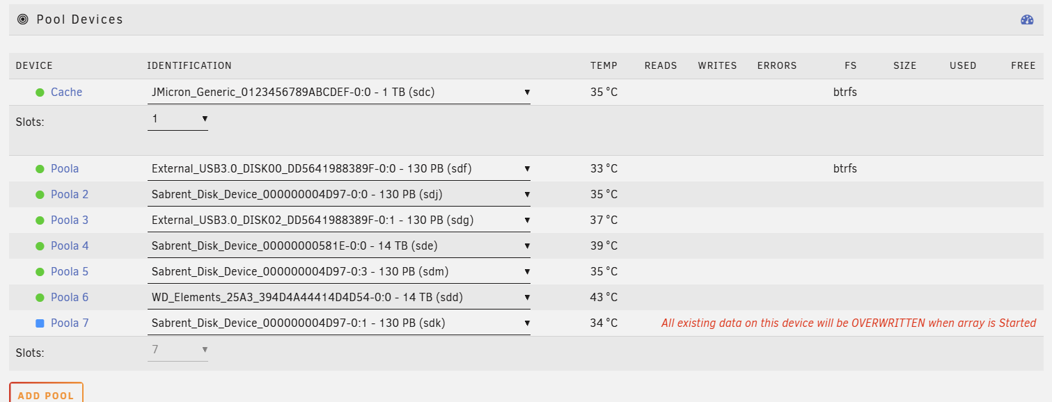

So I added a seventh slot and readded the missing drive. NOW it wants to format it!
Removed the pool, shut down unraid. Put the drive back where it was and rebuilt the pool again using 7 slots.
When I started the array, it dropped the last drive ... again.
So at this point I cannot get back to where I was. The best I can muster is six of the seven drives. The next thing I'll try is to put a scratch disk in - make a pool of 8 with the scratch disk in the last slot and see if I can get it back that way.
Edit: Didn't work either .. I'm stuck with 6 drives.
I tried to add the drives in different orders - that last drive is always dropped.

The drive in question now sits in Unassigned wanting to be formatted. Is it possible I added it to the pool and the pool just never got around to using it?

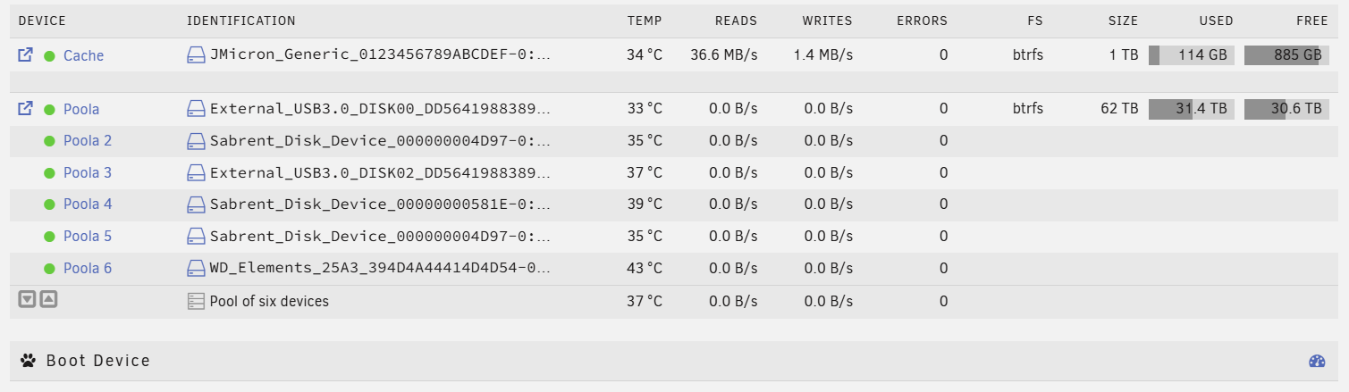

But I 100% know the drive was listed as part of the pool (see an earlier screenshot). That lends to my confusion. :)

Pool only has 6 devices at the moment:
Id Path      single    DUP      DUP      Unallocated Total    Slack
 1 /dev/sdk1 910.00GiB  2.00GiB        -     4.57TiB  5.46TiB  3.50KiB
 2 /dev/sde1 913.00GiB  4.00GiB        -     4.56TiB  5.46TiB  3.50KiB
 3 /dev/sdl1   8.13TiB 16.00GiB        -     4.59TiB 12.73TiB  3.50KiB
 4 /dev/sdj1   7.97TiB 16.00GiB        -     4.75TiB 12.73TiB  3.50KiB
 5 /dev/sdh1   2.71TiB  8.00GiB        -     4.56TiB  7.28TiB  3.50KiB
 6 /dev/sdd1   7.97TiB 14.00GiB 64.00MiB     4.74TiB 12.73TiB  3.50KiB
   Total      28.56TiB 30.00GiB 32.00MiB    27.77TiB 56.39TiB 21.00KiB
   Used       28.51TiB 29.66GiB  3.09MiB

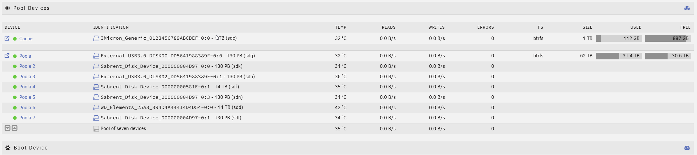

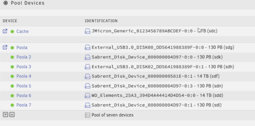

My dude.. you would be so proud of me. Had an issue .. figured it out on my own ... The DAS is up, the pool has been restored, cache drive restored.
This is really damn exciting. My cables are too short so I almost have everything welded together, but it frigging works.
