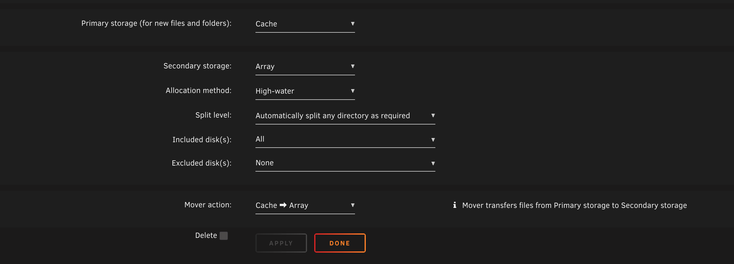

I recently added a file to test the mover for the share (p-----k) and the mover successfully moved that file. However, the files within the share l-----y were still not moved. Is my configuration wrong for this share?

That share has duplicate configurations, probably caused by specifying it with different upper/lower case. The share which has contents is not configured to be moved, but the configuration in your screenshot has no contents.
What do you get from command line with this?
ls -lah /boot/config/shares

When I run that command that share (l-----y) is capitalized even though in the unRAID gui it is lowercase.
Delete the .cfg file for that share, then configure it again from the webUI.
Linux is case sensitive, so make sure you don't have a docker or something else configured to reference it with the wrong case.
