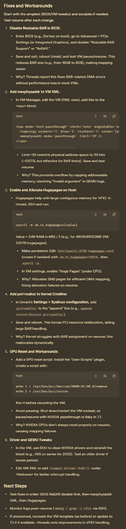

October 2, 20251 yr Upgraded from 6.12 to 7.1; with older version, I was able to sleep & wake my Windows VM, but now unable to do wake the VM. I have tried 1 & 2 here in this screenshot from AI, but these didnt work. Before proceeding, I am wondering if someone might be able to spot something and help me out here. Thank you for any & all help. tower-diagnostics-20250925-1526.zip Windows VM log.txt

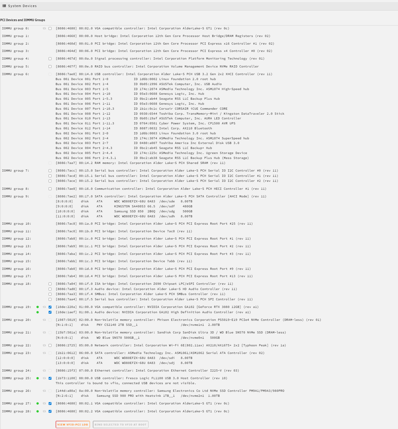

October 11, 20251 yr Author On 10/7/2025 at 1:15 PM, JorgeB said:Looks like it may be passthrough related. Does it work if you run the VM without any passed through devices, just as a test?When i clicked the Windows button, there was no actual "Sleep" option, just Lock, Shut down, Restart; thus, i have no idea if the Sleep/Wake cycle works w/out passed through devices. I checked the Power Settings to see if i can enable advanced option to sleep or anything, but i found nothing. Pausing the VM through the Unraid GUI does not suffice since/when i pause the VM w/ passed through devices, it freezes functionality, but doesnt actually turn the screens off - so its not a proper sleep. I look forward to your further help. Thank you very much for everything as always!PS: I do not have the NVDA community apps installed. And here is my System Devices. Edited October 11, 20251 yr by xlucero1 Added image of system devs
October 11, 20251 yr Community Expert 3 hours ago, xlucero1 said:When i clicked the Windows button, there was no actual "Sleep" optionYou need to install the guest tools.
