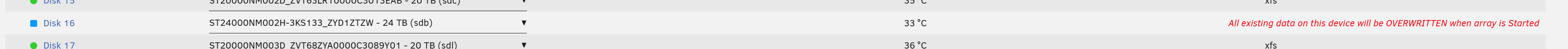

New diags attached. Here is a screenshot of what happens when I assign the disk to its slot in the array now:
And when I don't select it the option is either one of my unassigned disks or "unassigned" where previously it was a disk or "No device".
bigboy-diagnostics-20251016-1119.zip
Disk16 is disabled (being emulated), so
