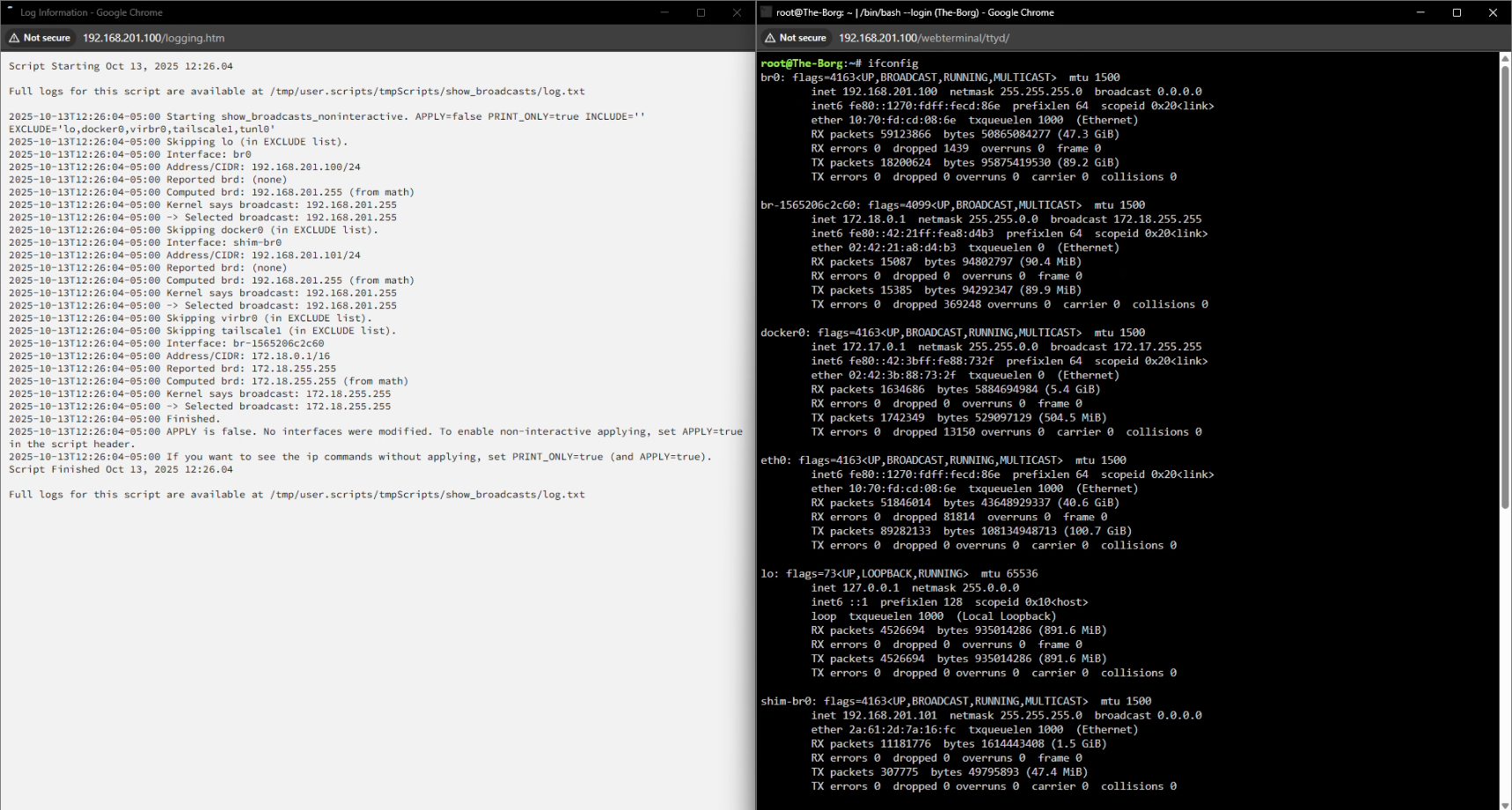

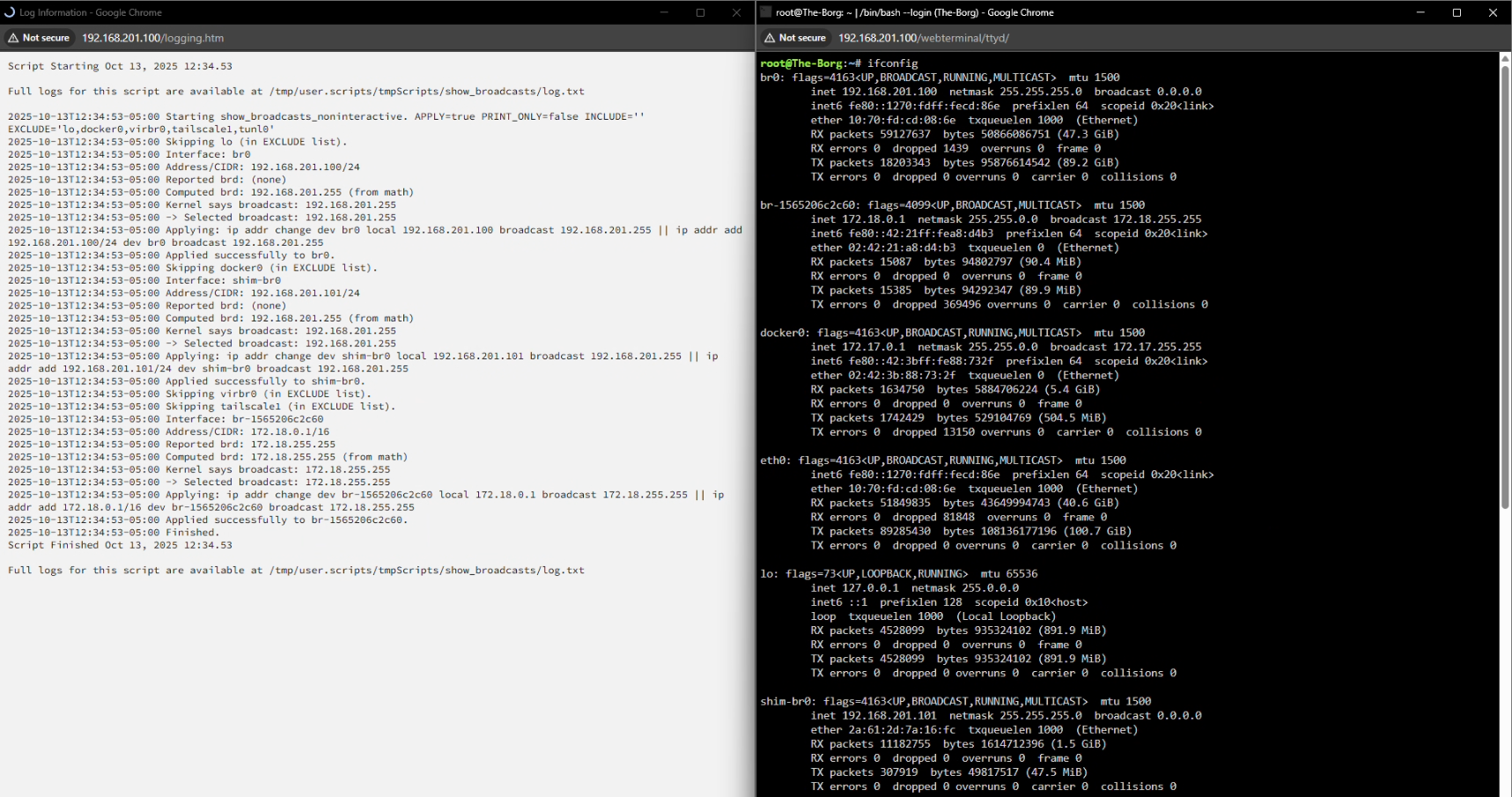

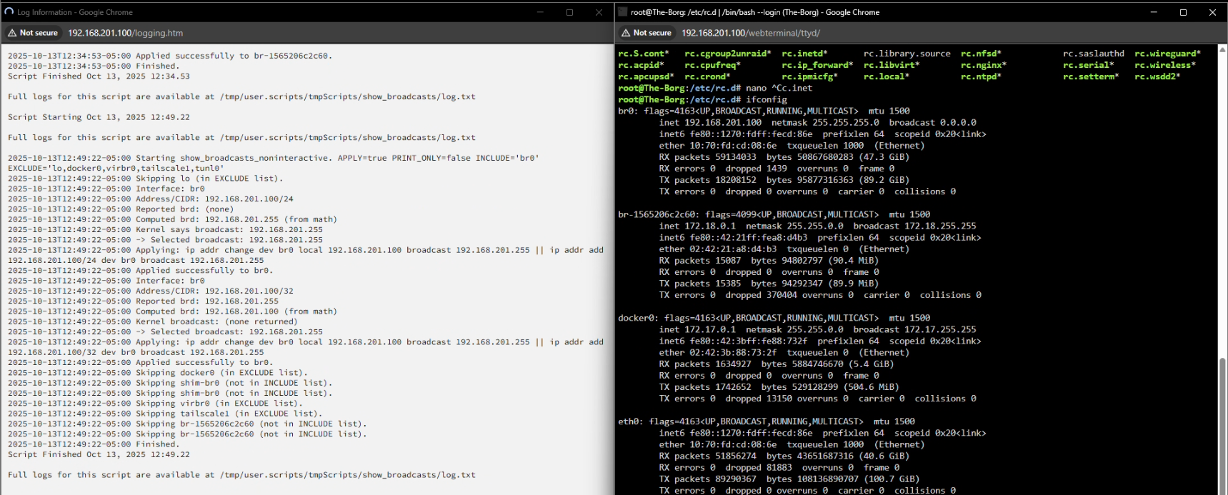

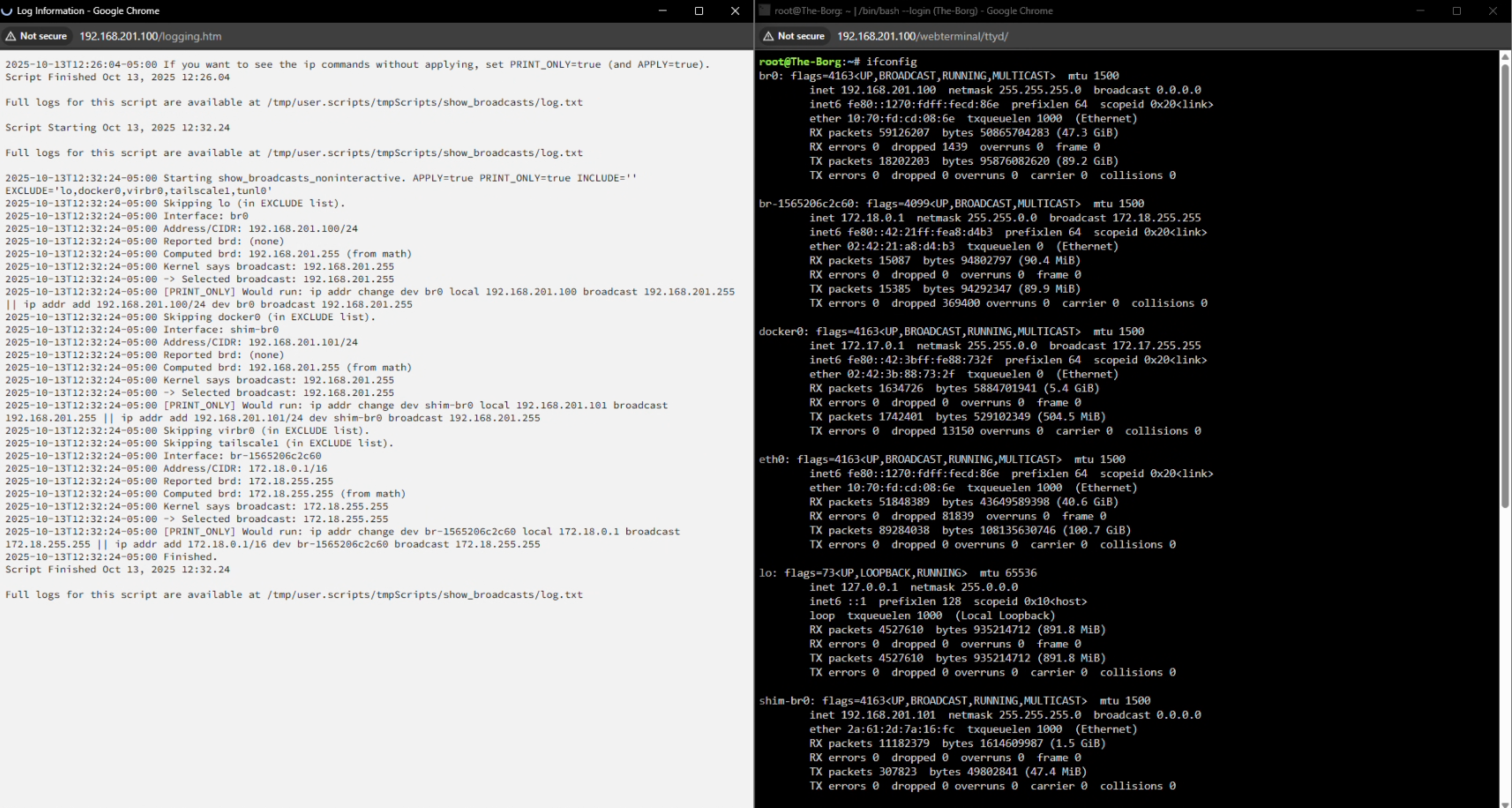

You have me invested now in this quirk... so here are some musing and quick thouhts...
Yeah. Redundant if you need to know and a end users doesn't know how to calculate and the linux commands that are suposed to share are not working as they should... and the true broadcast is buried and there in the ip route and how the kernel/network interpert... Its a mess...
Throwing here to the wall as i would assume simalr to how docker 0 was cretaed i should be able to run a ip coamnd to set the curent IP and boradcast...
The Best I can recommend is running a script via user script plugin to predo some of this calculations, get confirm and run the ip command similar to what docker does to inform and tell the kernel this is the broadcast... so later runs of the command ipconfig will show... I guess this could be an annoyance bug report.
As after some testing...

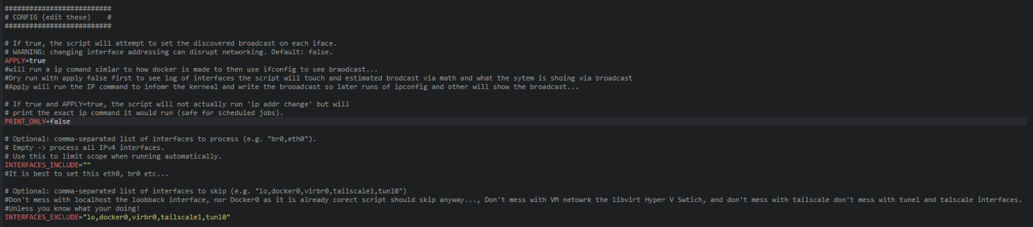

Made a script to do the broadcast caulations. And the iproute get check the broadcast...
The script hat shold fix...
#!/usr/bin/env bash
# show_broadcasts_noninteractive.sh
# Non-interactive: find (and optionally apply) IPv4 broadcast addresses for all interfaces.
# Designed to run from Unraid User Scripts plugin (runs as root).
# CONFIGURE only the variables in the top section.
set -euo pipefail
# CONFIG (edit these)    #
# If true, the script will attempt to set the discovered broadcast on each iface.
# WARNING: changing interface addressing can disrupt networking. Default: false.
APPLY=false
#will run a ip comand simlar to how docker is made to then use ifconfig to see braodcast...
#Dry run with apply false first to see log of interfaces the script will touch and estimated brodcast via math and what the sytem is shoing via broadcast
#Apply will run the IP command to infomr the kerneal and write the brooadcast so later runs of ipconfig and other will show the broadcast...
# If true and APPLY=true, the script will not actually run 'ip addr change' but will
# print the exact ip command it would run (safe for scheduled jobs).
PRINT_ONLY=true
# Optional: comma-separated list of interfaces to process (e.g. "br0,eth0").
# Empty -> process all IPv4 interfaces.
# Use this to limit scope when running automatically.
INTERFACES_INCLUDE=""
#It is best to set this eth0, br0 etc...
# Optional: comma-separated list of interfaces to skip (e.g. "lo,docker0,virbr0,tailscale1,tunl0")
#Don't mess with localhost the loobback interface, nor Docker0 as it is already corect script should skip anyway..., Don't mess with VM netowrk the libvirt Hyper V Swtich, and don't mess with tailscale don't mess with tunel and talscale interfaces.
#Unless you know what your doing!
INTERFACES_EXCLUDE="lo,docker0,virbr0,tailscale1,tunl0"
# Optional: path to a logfile (script will append). Empty -> only stdout.
LOGFILE=""
#user scirpt plugin has a log...
# end CONFIG             #

_log "Starting show_broadcasts_noninteractive. APPLY=${APPLY} PRINT_ONLY=${PRINT_ONLY} INCLUDE='${INTERFACES_INCLUDE}' EXCLUDE='${INTERFACES_EXCLUDE}'"
# Iterate IPv4 addresses
while IFS= read -r line; do
  # sample 'ip -o -4 addr show' line:
  # 7: br0    inet 192.168.0.4/23 brd 192.168.1.255 scope global br0
  iface=$(awk '{print $2}' <<< "$line")
  iface=${iface%:}
  # enforce include/exclude
  if in_list "$iface" "$INTERFACES_EXCLUDE"; then
    _log "Skipping $iface (in EXCLUDE list)."
    continue
  fi
  if [[ -n "$INTERFACES_INCLUDE" ]] && ! in_list "$iface" "$INTERFACES_INCLUDE"; then
    _log "Skipping $iface (not in INCLUDE list)."
    continue
  fi
  inet_part=$(awk '{for(i=1;i<=NF;i++) if($i=="inet"){print $(i+1); exit}}' <<< "$line")
  reported_brd=$(awk '{for(i=1;i<=NF;i++) if($i=="brd"){print $(i+1); exit}}' <<< "$line" || true)
  if [[ -z "$inet_part" ]]; then
    _log " - $iface: no IPv4 address found, skipping."
    continue
  fi
  ipaddr=${inet_part%%/*}
  cidr=${inet_part##*/}
  if [[ -z "$ipaddr" || -z "$cidr" ]]; then
    _log " - $iface: couldn't parse IP/CIDR from '$inet_part'"
    continue
  fi
  _log "Interface: $iface"
  _log "  Address/CIDR: $ipaddr/$cidr"
  if [[ -n "$reported_brd" ]]; then
    _log "  Reported brd: $reported_brd"
  else
    _log "  Reported brd: (none)"
  fi
  invalid_reported=false
  if [[ -z "$reported_brd" || "$reported_brd" == "0.0.0.0" ]]; then
    invalid_reported=true
  fi
  ip_int=$(ip2int "$ipaddr")
  mask_int=$(cidr_to_mask "$cidr")
  inv_mask=$(( (~mask_int) & 0xFFFFFFFF ))
  computed_brd_int=$(( (ip_int & mask_int) | inv_mask ))
  computed_brd=$(int2ip "$computed_brd_int")
  _log "  Computed brd: $computed_brd (from math)"
  kern_brd=$(query_kernel_broadcast "$computed_brd")
  if [[ -n "$kern_brd" ]]; then
    _log "  Kernel says broadcast: $kern_brd"
  else
    _log "  Kernel broadcast: (none returned)"
  fi
  # choose best
  chosen_brd=""
  if [[ -n "$kern_brd" && "$kern_brd" != "0.0.0.0" ]]; then
    chosen_brd="$kern_brd"
  elif [[ "$invalid_reported" = false && -n "$reported_brd" && "$reported_brd" != "0.0.0.0" ]]; then
    chosen_brd="$reported_brd"
  else
    chosen_brd="$computed_brd"
  fi
  _log "  -> Selected broadcast: $chosen_brd"
  if [[ "${APPLY}" == "true" ]]; then
    # Build the command we would run
    ip_cmd="ip addr change dev ${iface} local ${ipaddr} broadcast ${chosen_brd} || ip addr add ${ipaddr}/${cidr} dev ${iface} broadcast ${chosen_brd}"
    if [[ "${PRINT_ONLY}" == "true" ]]; then
      _log "  [PRINT_ONLY] Would run: ${ip_cmd}"
    else
      _log "  Applying: ${ip_cmd}"
      # run the change command; swallow failure but log it
      if bash -c "${ip_cmd}"; then
        _log "  Applied successfully to ${iface}."
      else
        _log "  Failed to apply to ${iface}. (This may be normal for container-managed or bridge interfaces.)"
      fi
    fi
  fi
done < <(ip -o -4 addr show)
_log "Finished."
# If not applying, advise what to change (final message)
if [[ "${APPLY}" != "true" ]]; then
  _log "APPLY is false. No interfaces were modified. To enable non-interactive applying, set APPLY=true in the script header."
  _log "If you want to see the ip commands without applying, set PRINT_ONLY=true (and APPLY=true)."
fi
*Note the Config at the Top... First run test see log... apply is false and print true... more to double check what interfaces will be touched...
as this is the comand to run to fix the display issue:
2025-10-13T12:32:24-05:00 [PRINT_ONLY] Would run: ip addr change dev br-1565206c2c60 local 172.18.0.1 broadcast 172.18.255.255 || ip addr add 172.18.0.1/16 dev br-1565206c2c60 broadcast 172.18.255.255
2025-10-13T12:32:24-05:00 Finished.
Script Finished Oct 13, 2025 12:32.24
I will now change to apply to true and print to false... let the ip command run to set the brodcast via the ip command... since its confirmed via math and crosed with what the kerneal already shows... this was the ifconig tool see what the kerenal sees as it was written after the run... note br0 and shim-br0 brodacast didn't change even though a bradcast ip was sent and coreclty set I have no network loss or net isseus after this script run..
so even with a work around script the ifconfig didn't affect the ifconfig output..
Let me try directly by including br0 in include and then use other comadns to see if the brctl and ip adr show comadns see the bridge now...
sad panda...
ip addr change dev br0 local 192.168.201.100 broadcast 192.168.201.255 || ip addr add 192.168.201.100/24 dev br0 broadcast 192.168.201.255
However, I can see the docker veth and other br interfaces got a ip as they should so I have to assume a higer level overwrite via the inet rc script.
root@The-Borg:~# cd /etc/rc.d/
root@The-Borg:/etc/rc.d# ls
rc.0@ rc.atd* rc.dnsmasq rc.ipmidetectd rc.local_shutdown* rc.openldap rc.smartd
rc.4* rc.avahidaemon* rc.docker* rc.ipmiseld* rc.loop* rc.php-fpm* rc.sshd*
rc.4.local* rc.avahidnsconfd* rc.elogind* rc.ipmitail* rc.mcelog* rc.ptpd* rc.swapfile@
rc.6* rc.bind rc.font rc.kadmind rc.messagebus* rc.rpc* rc.sysstat
rc.K* rc.bmc-watchdog rc.inet1* rc.keymap* rc.modules* rc.rsyslogd* rc.sysvinit*
rc.M* rc.cgconfig rc.inet1.conf rc.kpropd rc.modules.local* rc.runlog rc.tailscale@
rc.S* rc.cgred rc.inet2* rc.krb5kdc rc.mysqld rc.samba* rc.udev*
rc.S.cont* rc.cgroup2unraid* rc.inetd* rc.library.source rc.nfsd* rc.saslauthd rc.wireguard*
rc.acpid* rc.cpufreq* rc.ip_forward* rc.libvirt* rc.nginx* rc.serial* rc.wireless*
rc.apcupsd* rc.crond* rc.ipmicfg* rc.local* rc.ntpd* rc.setterm* rc.wsdd2*
root@The-Borg:/etc/rc.d# nano rc.inet
* which I parsed back in the 7.0 beta...
I do see that I have 3 inet stuff so a new inet scirpt may be implemented...
the inet1.conf the inet1* and inet2*
as teh rc.inetd is the daemon script... so unradi slackware ha defienlty cahged and messed with its networks
Something that wasn't there before the webui network layout change...
My unraid system the Borg setting > network on v 7.1.4
root@The-Borg:/etc/rc.d# ip addr show br0
4: br0: <BROADCAST,MULTICAST,UP,LOWER_UP> mtu 1500 qdisc noqueue state UP group default qlen 1000
link/ether 10:70:fd:cd:08:6e brd ff:ff:ff:ff:ff:ff
inet 192.168.201.100/24 metric 1 scope global br0
valid_lft forever preferred_lft forever
inet 192.168.201.100/32 brd 192.168.201.255 scope global br0
inet6 fe80::1270:fdff:fecd:86e/64 scope link proto kernel_ll
so its still getting something via dhcp. but the ip command did run and work...
but now there are 2 of the same ip with 1 ip on the wrong cird subnet...
hmm... I may need to reach out on the bug reports and higher up in unraid dev team on this one...
As I can confirm in older unraid version like version 6 there their weren't mutiple inet rc scripts... which may have cheaged in recent releases...
so I have to assume L2 transport broadcast by default thus even a written broadcast command ran is un needed as we are using L2/L3 and the Ethernet device broadcast and kernel with iproute to determine where the ip address needs to go and talk to...
still ip a, ipconfig and ip addre show should notate that better... But I'm not 100% sure this is a display bug or comand issues... I still have to assume some werid overwrite happening from the inet script.
Similar to how i'm setting the docker macvlan shib bridge, I may need to flush the dev ip configuration after colecttng tis data and re add it via the ip command to remove duplicates...
just though I'd share some seek and find thoughts and data.

_log "Start. APPLY=${APPLY} PRINT_ONLY=${PRINT_ONLY} DO_FLUSH=${DO_FLUSH} INCLUDE='${INTERFACES_INCLUDE}' EXCLUDE='${INTERFACES_EXCLUDE}'"
# enumerate all ifaces that currently have any IPv4; then filter by include/exclude
# (we intentionally avoid associative arrays, and process each iface independently)
while IFS= read -r IF; do
  IF="${IF%:}"
  should_process_iface "$IF" || continue
  _log ""
  _log "Interface: $IF"
  _log "  Pre-state:"
  ip -4 -o addr show dev "$IF" | sed 's/^/    /' || true
  # pick primary line
  PL="$(pick_primary_line_for_iface "$IF" || true)"
  if [[ -z "$PL" ]]; then
    _log "  No broadcast-capable primary (/0..30); skipping."
    continue
  fi
  inet="$(awk '{for(i=1;i<=NF;i++) if($i=="inet"){print $(i+1); exit}}' <<< "$PL")"
  rep_brd="$(awk '{for(i=1;i<=NF;i++) if($i=="brd"){print $(i+1); exit}}' <<< "$PL" 2>/dev/null || true)"
  IP="${inet%%/*}"
  CIDR="${inet##*/}"
  # capture default gateway if bound to this iface
  GW="$(ip route show default 2>/dev/null | awk -v IF="$IF" '$1=="default" && $0 ~ (" dev "IF"($| )"){for(i=1;i<=NF;i++) if($i=="via"){print $(i+1)}}' | head -n1)"
  if [[ -n "$GW" ]]; then
    _log "  Detected default GW on ${IF}: ${GW}"
  fi
  _log "  Primary: ${IP}/${CIDR}"
  if [[ -n "$rep_brd" ]]; then
    _log "  Reported brd: ${rep_brd}"
  else
  fi
  ip_int="$(ip2int "$IP")"
  m_int="$(cidr_to_mask "$CIDR")"
  inv=$(( (~m_int) & 0xFFFFFFFF ))
  comp_brd="$(int2ip $(( (ip_int & m_int) | inv )))"
  _log "  Computed brd: $comp_brd"
  kern_brd="$(query_kernel_broadcast "$comp_brd")"
    _log "  Kernel says brd: $kern_brd"
  else
    _log "  Kernel brd: (none)"
  fi
  CHOSEN="$comp_brd"
    CHOSEN="$kern_brd"
  elif [[ -n "$rep_brd" && "$rep_brd" != "0.0.0.0" ]]; then
    CHOSEN="$rep_brd"
  fi
  _log "  -> Selected broadcast: $CHOSEN"
  if [[ "$APPLY" != "true" || "$PRINT_ONLY" == "true" ]]; then
    if [[ "$DO_FLUSH" == "true" ]]; then
      _log "  Would run (in order):"
      _log "    ip link set ${IF} down"
      _log "    ip -4 addr flush dev ${IF}"
      _log "    ip addr add ${IP}/${CIDR} brd ${CHOSEN} dev ${IF}"
      _log "    ip link set ${IF} up"
        _log "    ip route replace default via ${GW} dev ${IF}"
      fi
    else
      _log "  Would run: ip addr replace ${IP}/${CIDR} brd ${CHOSEN} dev ${IF}"
    fi
  else
      _log "  Applying (down -> flush -> add IP+brd -> up -> restore default route)..."
      ip link set "${IF}" down
      ip -4 addr flush dev "${IF}"
      ip addr add "${IP}/${CIDR}" brd "${CHOSEN}" dev "${IF}"
      ip link set "${IF}" up
        ip route replace default via "${GW}" dev "${IF}"
      fi
      # sanity
      if ! ip -4 -o addr show dev "$IF" | grep -q "${IP}/${CIDR}"; then
        _log "  ERROR: ${IP}/${CIDR} not present on ${IF} after flush/add."
        exit 1
      fi
      _log "  Applied successfully to ${IF}."
    else
      _log "  Applying: ip addr replace ${IP}/${CIDR} brd ${CHOSEN} dev ${IF}"
      ip addr replace "${IP}/${CIDR}" brd "${CHOSEN}" dev "${IF}"
    fi
  fi
  _log "  Post-state:"
done < <(ip -4 -o addr show | awk '{print $2}' | sed 's/:$//' | sort -u)
_log ""
_log "Finished."

Edited by bmartino1
workaround script to fix...

Yeah, I'm probably taking it a bit too serious. However, I did find a workaround fix. Something I may further report upstream to the ifconfig team for slack ware for bug tracking and fixing...
I made a bug report as well.

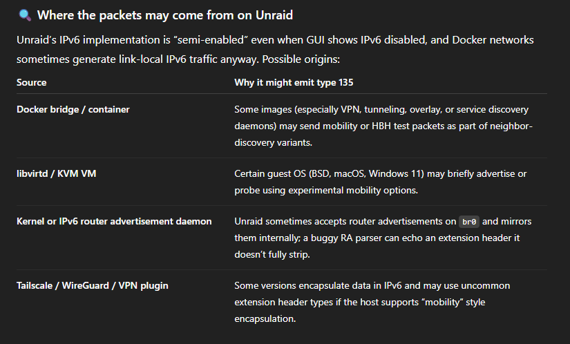

So First, as I've not seen that in a log ever yet... Using google AI to help me dig a bit deeper into this abit more...
Here is a breakdown of the kernel message log:
  • IPFW: The message comes from the Internet Protocol FireWall, a native firewall in FreeBSD.
  • IPV6: The log refers to an Internet Protocol Version 6 packet.
  • Unknown Extension Header(135): The firewall encountered an IPv6 extension header with the assigned number 135 and did not have a rule or capability to handle it. A protocol number of 135 is designated for the Mobility Header, which is used in Mobile IPv6 for mobility support.
  • ext_hd=0: This part indicates the position of the extension header. An ext_hd value of 0 means the mobility header was the first extension header in the IPv6 packet, immediately following the base IPv6 header.
Why this happens
This log message is often a low-priority informational or warning message, but it could also indicate a misconfiguration or network issue:
  • Mobile IPv6 traffic: If your network or one of its clients is using Mobile IPv6, the packets will include a Mobility Extension Header. IPFW, if not configured to specifically recognize this header, will log the event and drop the packet.
  • Firewall rule deficiency: The firewall's ruleset may not have a specific rule to permit or process the packet containing the mobility header. In the absence of a matching rule, IPFW's default behavior is to deny and log the traffic.
  • Network scanning or a bug: Less commonly, the log could result from network scanning or a bug in a network stack that sends malformed or unusual packets.
    Some potental things that could casue this on uraid logs:
