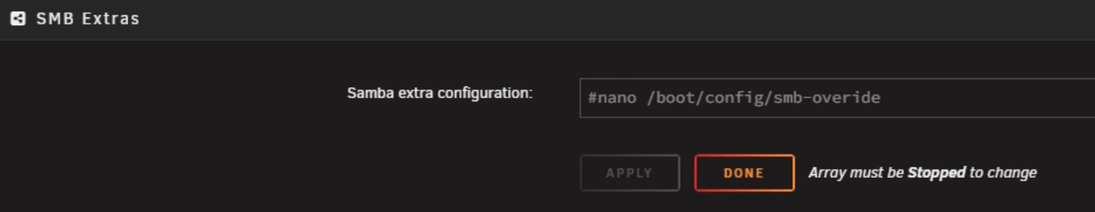

Settings > SMB > smb extra:

Add this block to Settings → SMB → SMB Extras (or edit /boot/config/smb-extra.conf
