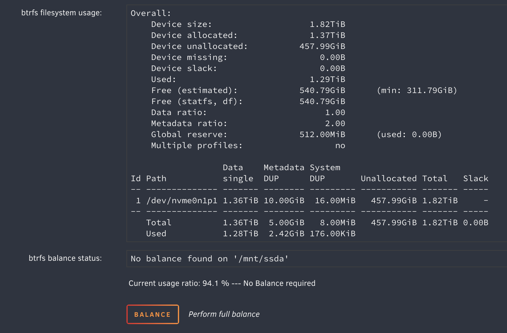

This shows some unallocated space on my cache drive but I don't know if it's related?

Your docker.img is likely corrupted not the cache pool.
