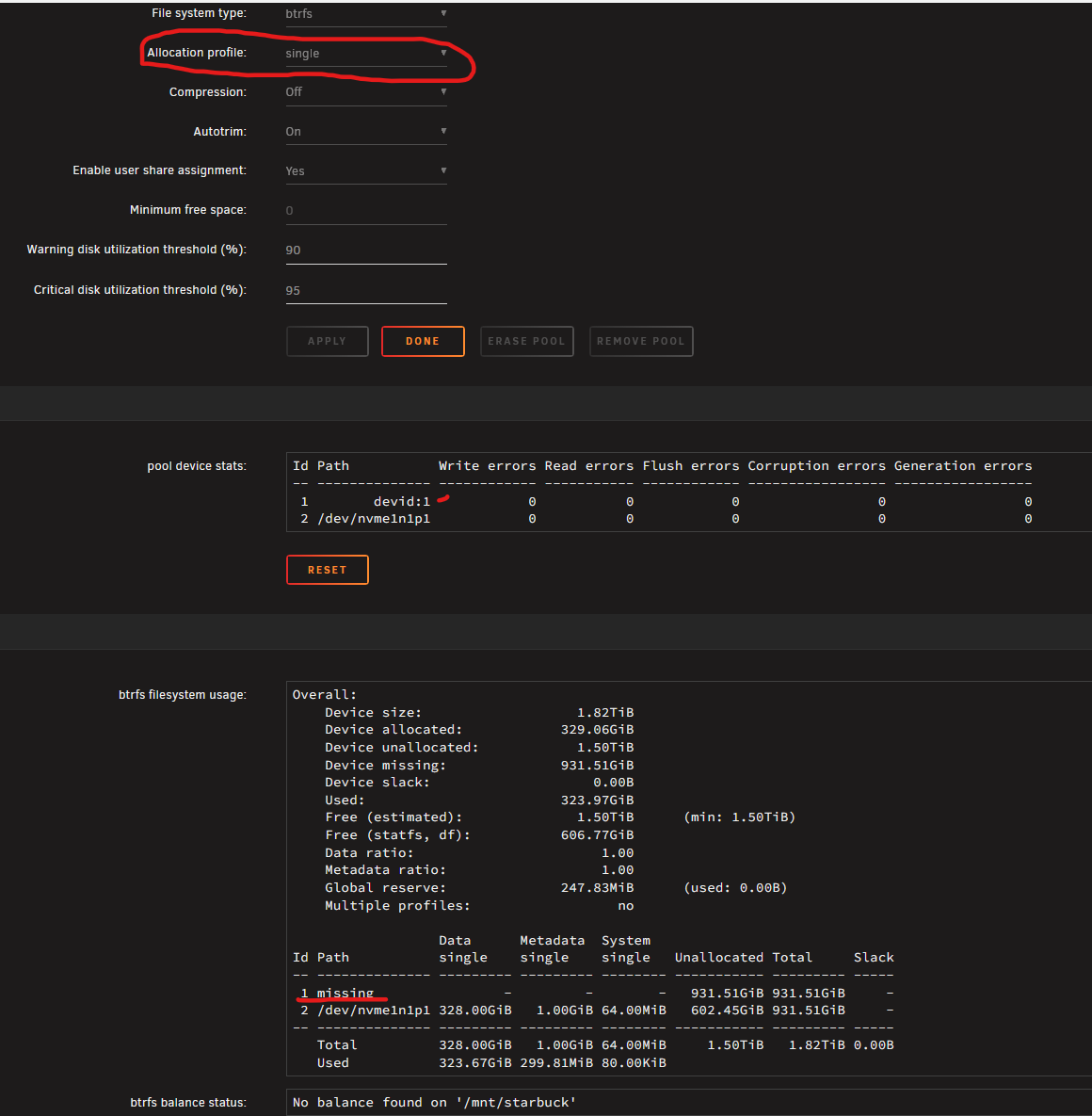

Ok on my unRAID server the main cache pool has a missing "device path". I also noticed that it is no longer in a RAID1 config.

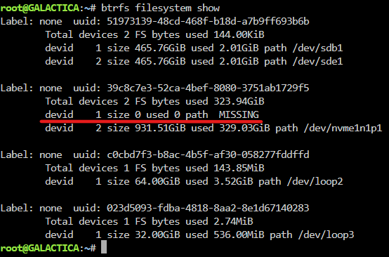

I am not sure what happened but the funny thing is the currently "working disk" was throwing errors and I removed it to see if I could repair it using Partition Manager Pro. When I used Partition Manager it said the disk was "unformatted" so I formatted the disk to NTFS working on the assumption that when I put it back into the server, it would just have the contents rebuilt from the remain member disk in the pool. I put the disk back in, and there were no more errors and then I noticed that the pool was now "2TB" rather than the expected "1TB" (they are 2 x 1TB Crucial nVME units) but somehow the DATA is on the disk I removed... so very strange.

With the array running type:
btrfs dev remove missing /mnt/starbuck
Once that's done, reimport the pool with the 2nd device only, the one being used (nvme1n1)
on main click on the first device for that pool and then "remove pool"
back on main, create a new pool with the same name and 1 slot
assign that pool device, leave the filesystem set to auto
start the array to import the pool
Pool should import as a single device, if all looks good, stop array change slots to 2 and add the other device to create a mirror.
