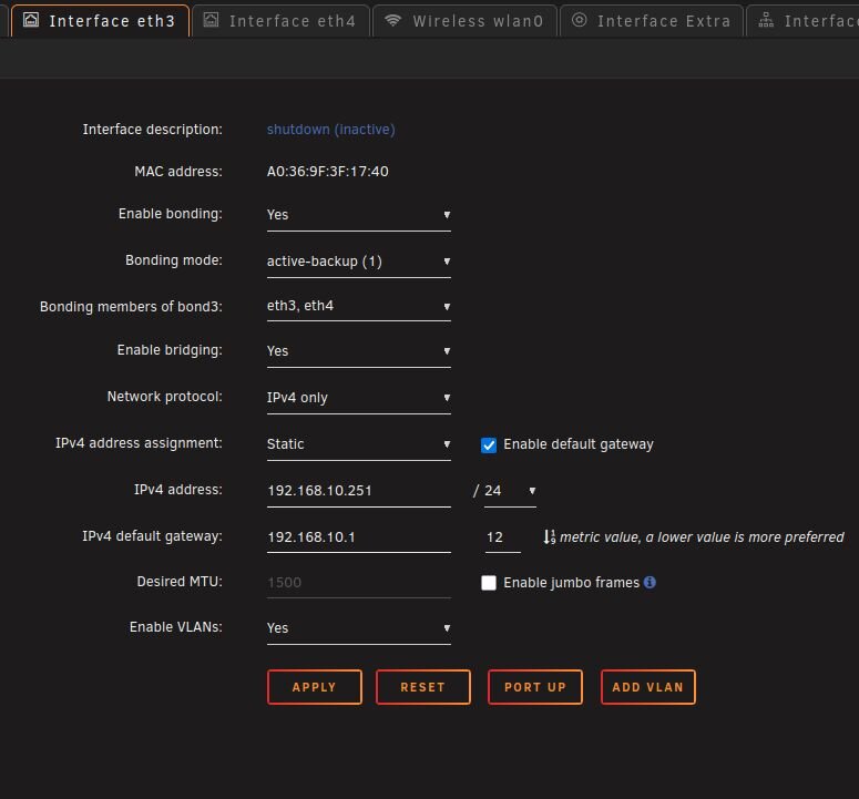

  5. Thanks @MAM59 I will give it a go... the only thing I don't understand is that with my previous 2.5Gb card I had it set to active/backup and I never had issues with the connection dropping... weird... but will see how it goes.
  6. I am currently using an Intel dual port 10-Gigabit X540-AT2 NIC in my server. I installed this yesterday and everything worked fine with the card setup as a bond linked to a Ubiquiti UniFi USW Flex XG 10Gb with 2 ports aggregated to account for the NIC bonding. This morning, I was not able to login to the server and resolved this by unplugging the ethernet cables and then plugging them back in. This restored the connection and I was able to login. I checked the logs and there were some entries in there but I cannot make any heads or tails about this. I have now reconfigured the bond into 2 separate ports along with removing the aggregated port config on the switch the server is connected to. I have attached the log - if anyone has some insight in what happened that would be awesome - I will see if the issue occurs with a non-bonded connection. syslog.txt

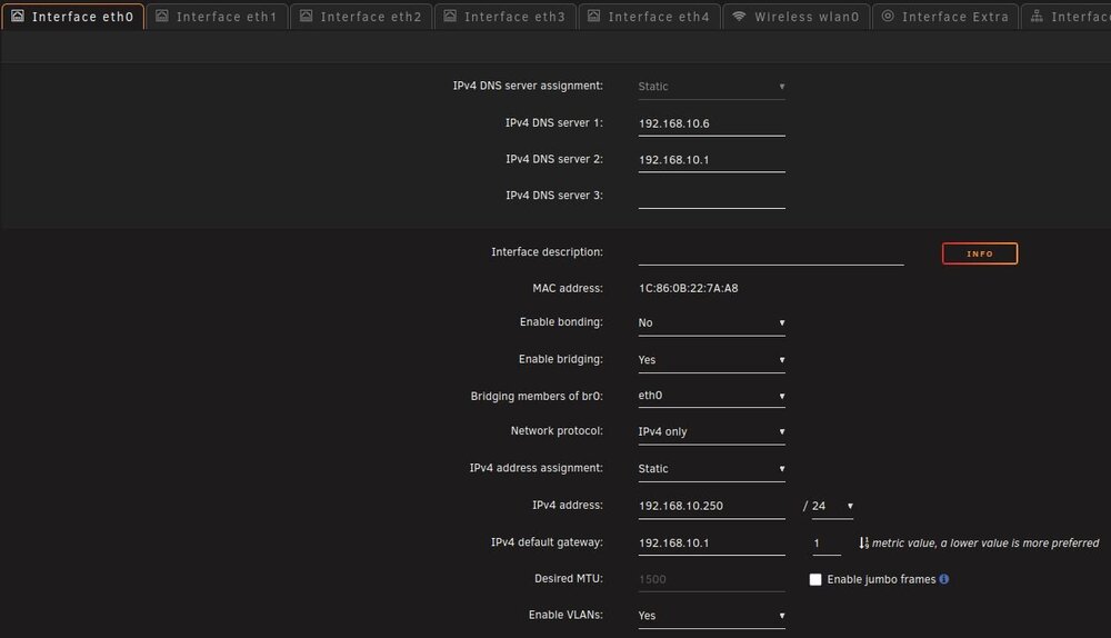

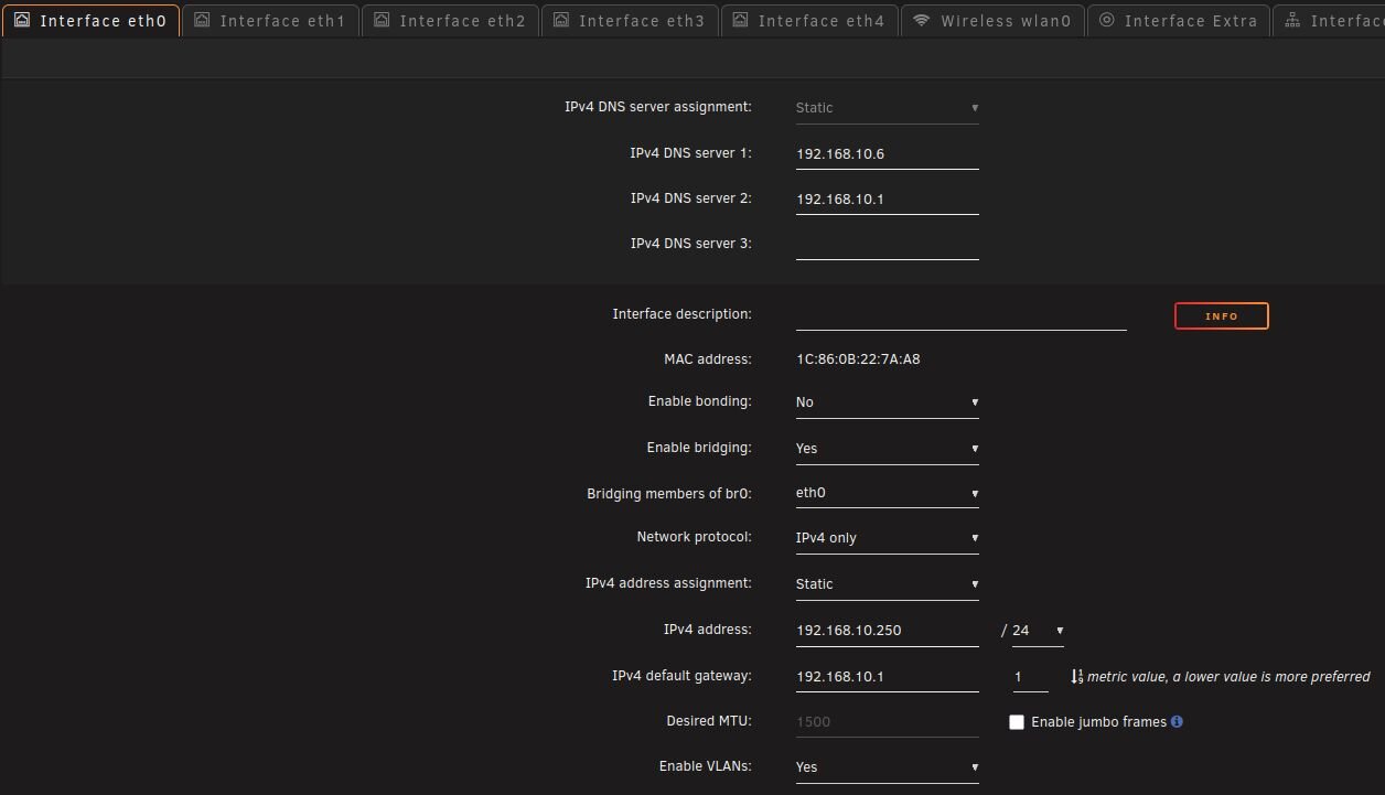

  7. This is a follow up topic from https://forums.unraid.net/topic/194039-solved-separate-devices-into-their-own-iommu-group/ I have installed a new 10Gb dual port SFP+ NIC into the system with a plan to remove the current 2.5Gb dual port card. When I initially did this on a previous attempt I added the 10Gb ports to the existing bond and then physically removed the 2.5Gb card but the system displayed an error message saying eth0 does not exist which was the 2.5Gb NIC. I tried to resolve the issue by creating a new bond with just the 10Gb ports and even though this worked I couldn't set any DNS servers for the new bond because these were set at part of eth0? So under the 1st 10Gb port (where the bond is set to yes as well as bridging) I could set a static IP and a gateway but there is no option at the top of that panel to set DNS servers because that is only available under eth0 linked to the bond associated with the 2.5Gb card. How do I remove the 2.5Gb card but then make the 10Gb card the "primary" so to speak with the DNS options available to set. I cannot seem to get rid of the reference to eth0 even when I physically remove the 2.5Gb card?

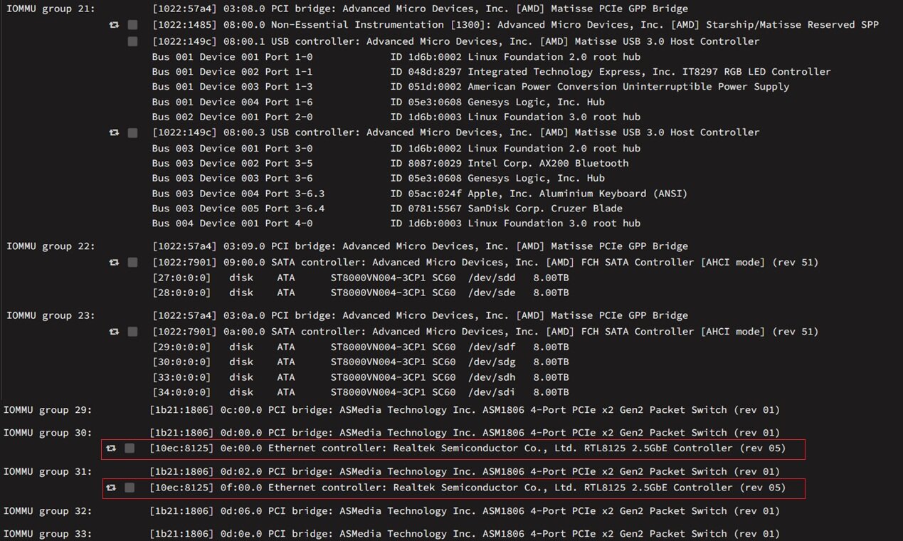

  8. Thanks @JorgeB that worked. I set PCIe ACS Override to "Downstream" and also disabled allow unsafe interrupts - the system seems to be working fine now.
  9. Hi team!! The TLDR is: I swapped my dual 2.5Gb NIC for a dual 10Gb NIC but the 10Gb NIC is faulty and causes the server to shutdown (gracefully thank goodness #noparitycheck). I have put the 2.5Gb NIC back in but I am having multiple issues such as a reference to eth0 not existing even though there is an entry for the card which I have now re-installed. None of my attempts to configure the network has worked and then I noticed that the link lights for the card do not illuminate. I used the onboard 1Gb NIC and that works fine. My suspicion is that the 2.5Gb NIC is not happy because its sharing an IOMMU group with an Add-on SATA card I'm using... this was never an issue as both the SATA card and the 2.5Gb NIC have been running in the system for almost a year without issue. So the question is how do I move the Realtek 2.5Gb ethernet controller into its own IOMMU group. Highlighted in red in the image... I tried SpaceInvaderOne's video from 7 years ago but that resulted in the system not booting because it couldn't find the USB drive - so I reverted that change it boots normally. I can only assume that things have changed in 7.1.4. Can someone please let me know how I do this? Thanks!!!

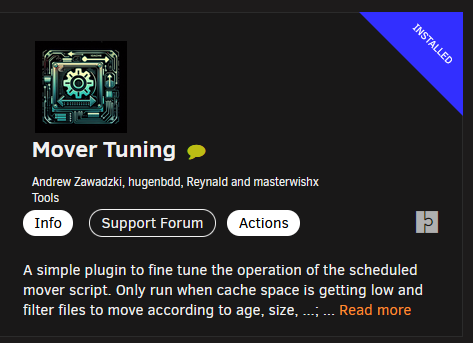

  10. As @Candle said, removing the Mover plugin and just using the Stock mover function is fine... so there is definitely something wrong with the plugin. I'm not too sure how I'm supposed to report that and too be fair, whilst that app gives you a lot of control, I'd say it's only for systems where, managing your cache is a necessity (maybe due to size) rather than just keeping things tidy.

  12. I have unmarked this as solved, because the issue still persists. I generated a number of backups from my other client PCs to fill up the cache to about 50% and then I ran move manually. I see the task running in the syslog and it says completed successfully, but the cache disk doesn't show any "Read" activity and the array disks do not show any "Write" activity. The files are still on the cache drive as well so nothing is getting moved?
