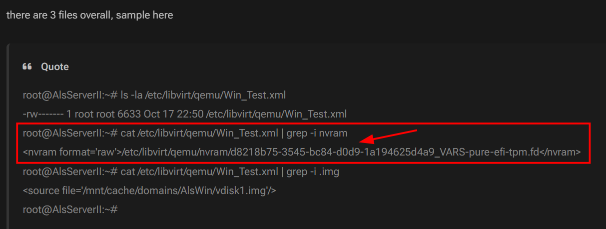

October 24, 20251 yr 3 hours ago, RaidPC said:I have a Windows 10 VM running that I want to keep a backup in case it decides to migrate to Windows 11 automatically or by accident.actually all you really need is the vdisk image from your domains folderbut to make sure all is backed up and you wouldnt need to arrange a "new" VM with an eisting "vdisk"there are 3 files overall, sample hereroot@AlsServerII:~# ls -la /etc/libvirt/qemu/Win_Test.xml-rw------- 1 root root 6633 Oct 17 22:50 /etc/libvirt/qemu/Win_Test.xmlroot@AlsServerII:~# cat /etc/libvirt/qemu/Win_Test.xml | grep -i nvram <nvram format='raw'>/etc/libvirt/qemu/nvram/d8218b75-3545-bc84-d0d9-1a194625d4a9_VARS-pure-efi-tpm.fd</nvram>root@AlsServerII:~# cat /etc/libvirt/qemu/Win_Test.xml | grep -i .img <source file='/mnt/cache/domains/AlsWin/vdisk1.img'/>root@AlsServerII:~#so, in the end copy these 3 files (correct names and pathes fitting your setup)/etc/libvirt/qemu/Win_Test.xml/etc/libvirt/qemu/nvram/d8218b75-3545-bc84-d0d9-1a194625d4a9_VARS-pure-efi-tpm.fd'/mnt/cache/domains/AlsWin/vdisk1.imgxml > start Parameters for your VM (could also be recreated).fd > personal bios according to your VM (would be recreated when recreating with existing vdisk).img > mandatory to backup !!! thats your complete VM ... can be used when recreating a new VM with existing disk (using same parameters for bios and mashine type) and your VM would be back like before too ...thats it ;) so your image file is the only really needed one, rest is "save to have"to restore in terms a update inside a VM failed, just replace the vdisk.img and you are back on that stateto restore on a complete new mashine (new unraid server setup)push the 3 upper files to their locations, unraid terminalvirsh define /etc/libvirt/qemu/Win_Test.xmlor simple create a new VM, point to your existing vdisk image, when you use the same bios tyoe (ovmf) and mashine type (q35) it will just start up as before too, you just should know which bios and mashine type the VM should start with ;) cpu cores, ram assignement, devices, ... can always be changed.and its all back there as before ;)

October 30, 20251 yr 1 hour ago, RaidPC said:Well, I only have one VM (Windows 10) on my UnRaid server (several dockers).then the other ones are probably from other tests ;)just copy them all.if you only have 1 VM, then you also can simple just copy/backup the libvirt.img file as backup too.1 hour ago, RaidPC said:I do not see how I identify the one for my Windows 10 VM. I must be missing something.in your xml file is the exact entry, the given cat command to your xml will show you which ;) from post 2but as mentioned, with 1 VM and a rollback scenario1/ stop the vm service2/ copy your vdisk.img (your VM disk) > backup3/ copy your libvirt.img (all your vm settings) > backup4/ now make your VM tests, updates, whatever ...... in terms something went wrong and you want to rollback5/ stop vm service6/ copy your 2 backup files back to their locations7/ start vm service8/ start your vm... all as never something happened ;)you may can also test the snapshot functions (i dont use them, so may read the tutorial therefore)
