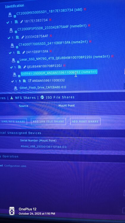

Not sure what I did but I need some guidance recovering/restoring cache pool drive to normal operation. Currently cannot mount cache pool drive. Happened while trying to add an additional nvme to the cache pool (from single drive to 2 drives). I stopped array and removed (a different) newly created pool to avoid any further issues. Seems the data is is till there when mounted in unassigned devices. The drive in question is highlighted in photoktower-diagnostics-20251024-1300.zip

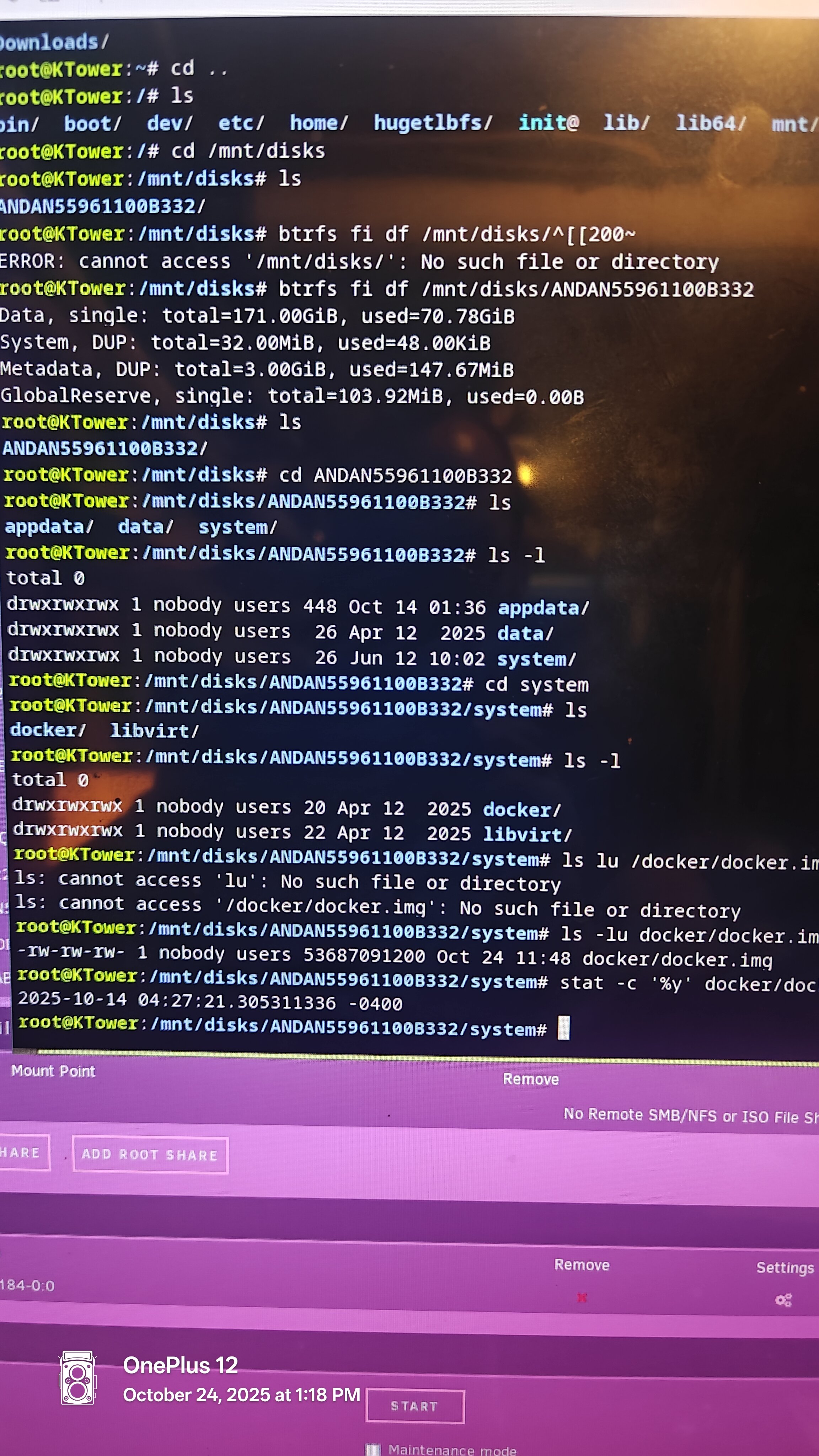

root@KTower:/mnt/disks# btrfs fi usage -T /mnt/disks/ANDAN55961100B332
Overall:
Device size: 1.82TiB
Device allocated: 177.06GiB
Device unallocated: 1.65TiB
Device missing: 0.00B
Device slack: 0.00B
Used: 71.07GiB
Free (estimated): 1.74TiB (min: 943.20GiB)
Free (statfs, df): 1.74TiB
Data ratio: 1.00
Metadata ratio: 2.00
Global reserve: 103.92MiB (used: 0.00B)
Multiple profiles: no
Data Metadata System
Id Path single DUP DUP Unallocated Total Slack
1 /dev/nvme1n1p1 171.00GiB 6.00GiB 64.00MiB 1.65TiB 1.82TiB -
Total 171.00GiB 3.00GiB 32.00MiB 1.65TiB 1.82TiB 0.00B
Used 70.78GiB 147.67MiB 48.00KiB
It's mounting alone; assuming contents look as expected, I would recommend offlining nvme0n1, adding that device to a pool by itself, and if all looks good, wipe nvme0n1.

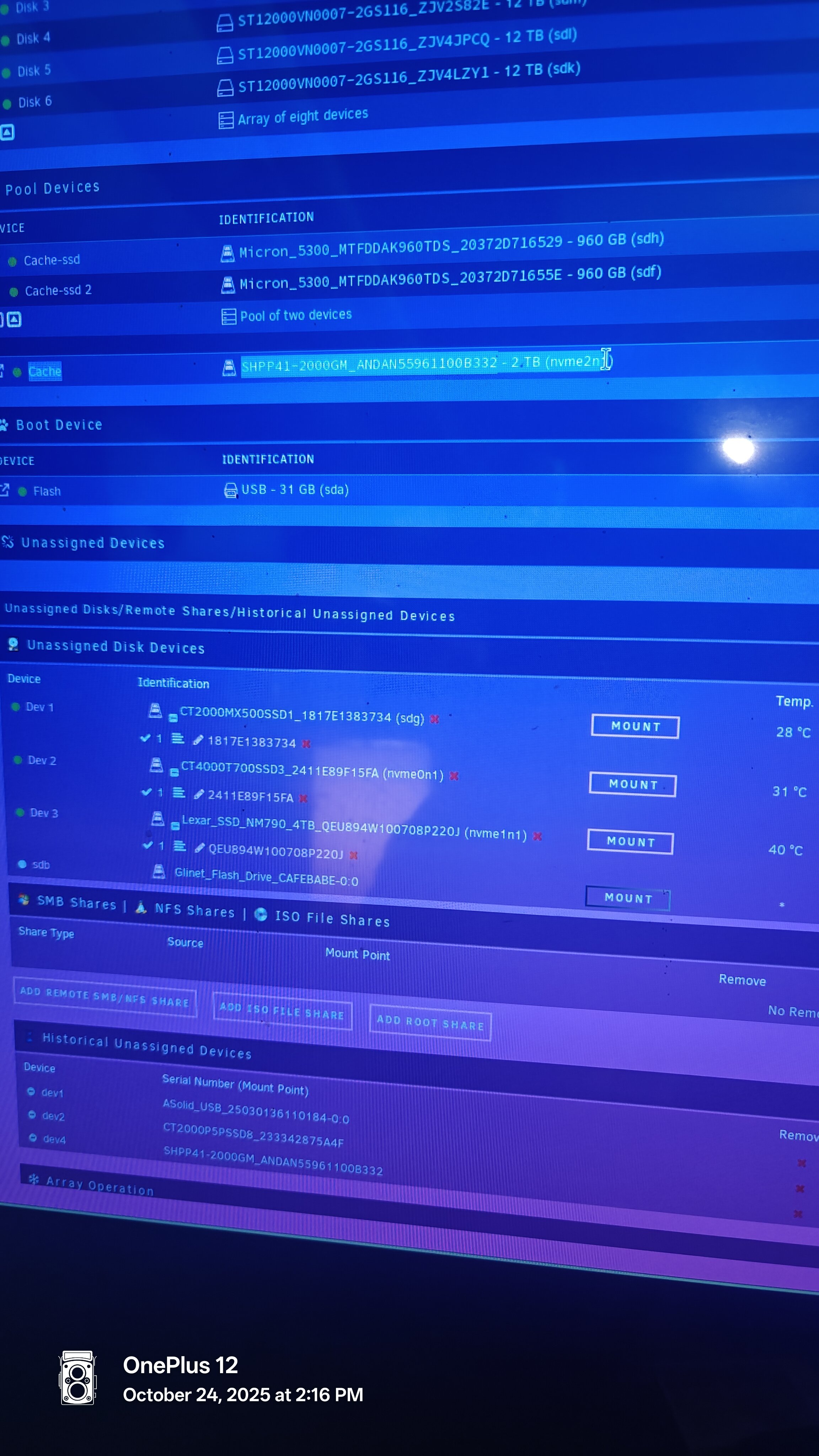

i yanked it before i could read your reply.... but that seems to have done it... drive added back to the pool ... now listed as nvme2n1...so odd
