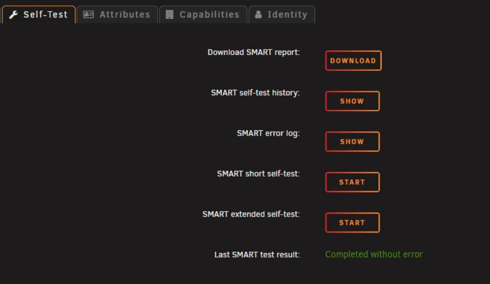

Looks like the cache disk died and the disk is dead. It needs to be replaced.
Please click cache
and check smart and do a disk test:
run a SMART short self test.
Edited by bmartino1
I did that and it completed without an error.
