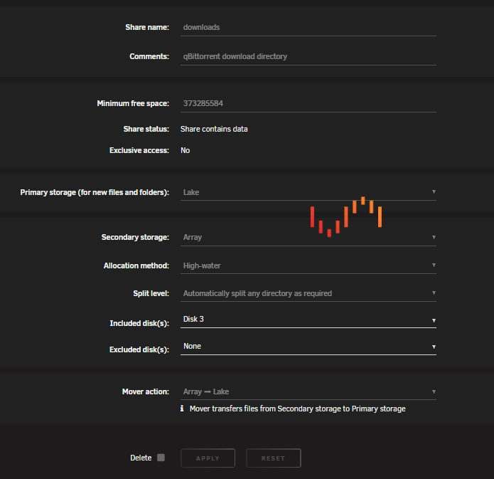

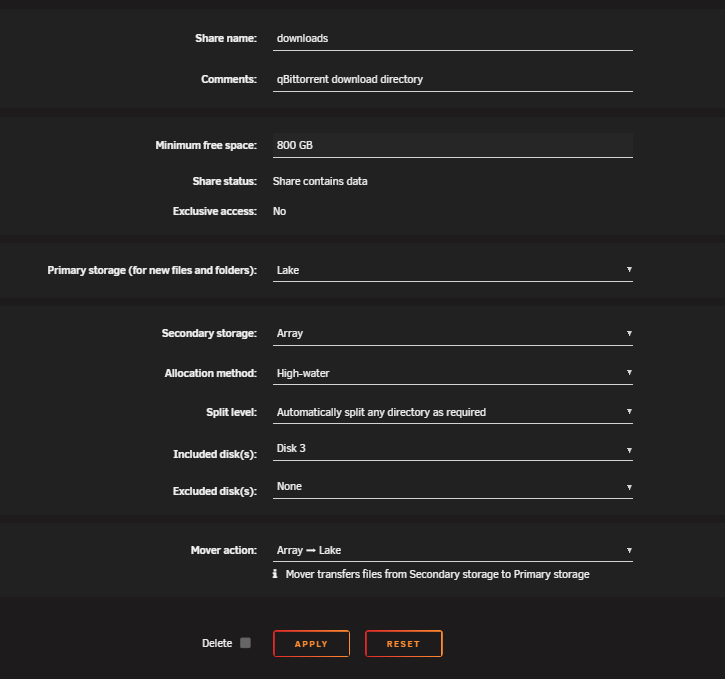

I'm trying to increase the Minimum free space of my downloads share to 800 GB.

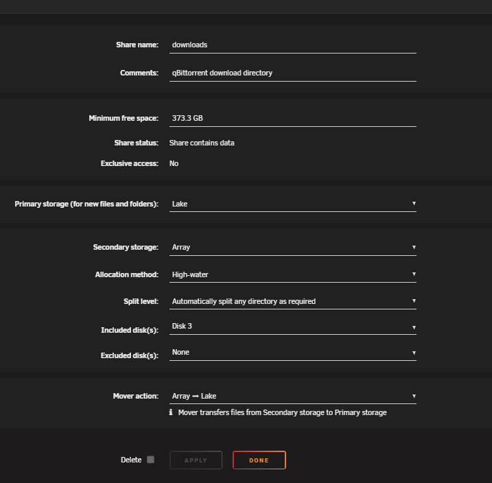

When I click apply, it changes back to 373.3GB.

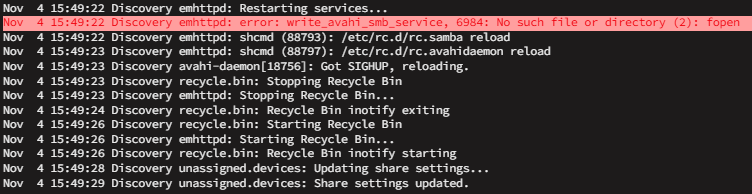

There is an error in the log when I click apply, indicating it is unable to find a file.
emhttpd: error: write_avahi_smb_service, 6984: No such file or directory (2): fopen
