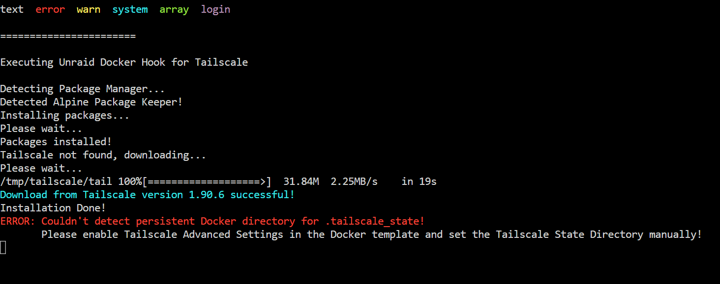

I have tried setting a custom server URL in plex but of course sonarr and plex don't speak. Data travels from sonnarr to the VPN and to the web.
So I realise I need to setup tailscale on Glutun.
However I get this issue in the container log:image.png
I'm not sure if this is a docker, glutun or tailscale issue.
I am also not sure what the persistent Docker directory is?
I do see under tailscale advanced options:
Am I doing something wrong? Can anyone help.

Solved by SmokeyColes
Embarrassingly it was late last night, and a google search found:
This has the solution. The host path 1 is "config" is a binhex plex; therefore the state directory is /config/.tailscale_state.
Really nice step by step guide from @ich777
It is also noted in spaceinvaders GlutunVPN setup (which I have had to go to as enabling tailscale stopped the VPN from working; I originally skipped this part of the video as at that time I found unclear what it was) but outbound firwall and a few other things need to be enabled.
