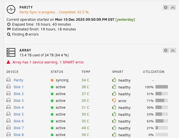

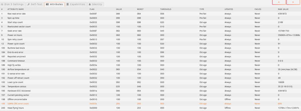

Does look like I have a data disk on its way out too Disk 3?
Why, any error with it? If yes, post new diags.
Will let the parity sync finish. Think the Smart Error was there prior for Disk 3
Once things are back running will see what is up.
UDMA CRC errors are typically the result of a bad SATA cable, and they could be old. Acknowledge the current value, and if it keeps increasing, replace the cable.
Ok will do.
