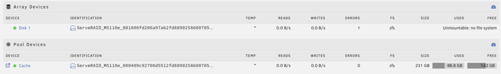

I'm sure this was asked a lot of times, but I can't find anything in particular about my case. So, I own an IBM x3650 M4, and I don't know how to flash the LSI board to make it expose the disk straight into Unraid, so what I did was I created a virtual drive managed by Mega RAID with all my disks and then used Unraid. However, yesterday after a power outage, the server went down, and now the array says "Unmountable disk - No File System". I tried maintenance mode and changed the disk slot to see if it would solve it, but not really. The file system is ZFS, and it detected it but won't let me change it to anything else; it is greyed out. I really do not want to format this disk; it has a lot of personal stuff and backups. Any solution to this problem?

Nov 7 17:17:56 Concorde kernel: md: disk1 read error, sector=0
RAID volume is giving read errors; I'm not sure if/how to resolve that. Look in the controller BIOS/Sofware to see if there are any issues reported with the RAID volume.

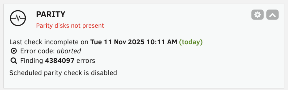

Sorry this upload is just to show the crazy amount of errors...

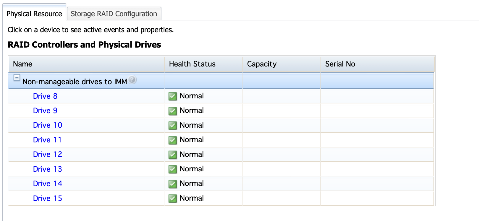

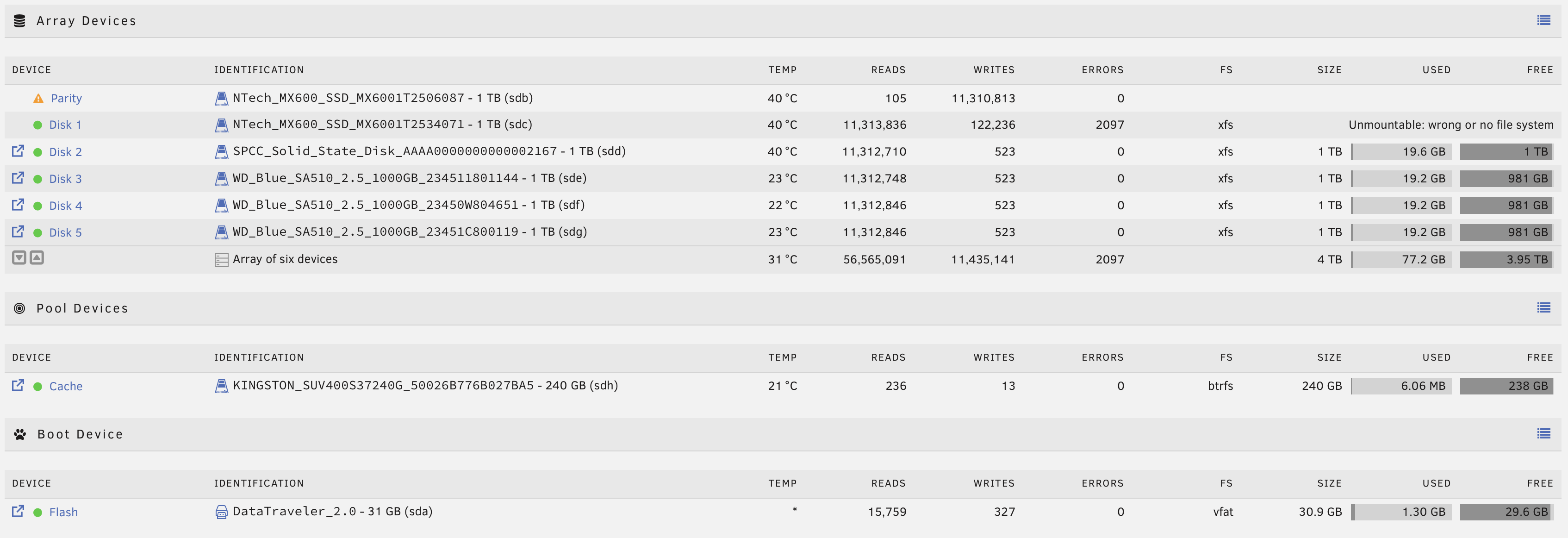

Okay, I went down to the basement to recheck the cabling, and I realised that I forgot to power the SAS board without the expanded plate, so that’s why the disks were not being recognised anyways. Whoever, one of them still shows errors when I'm trying to format. The diagnostics and system log are attached. I still don't know if it's something I'm doing wrong or just hardware incompatibility.
Plus, in the IMM, the system detects eight drives while Unraid only sees seven?
concorde-diagnostics-20251112-1202.zip syslog.txt
No longer seeing the constant errors as before, there are read errors with disk1, they are logged as device problem, but you can try swapping cables/slots with another disk, then try again, and see where the issue follows.
For the missing disk, also try swapping with a different one.
