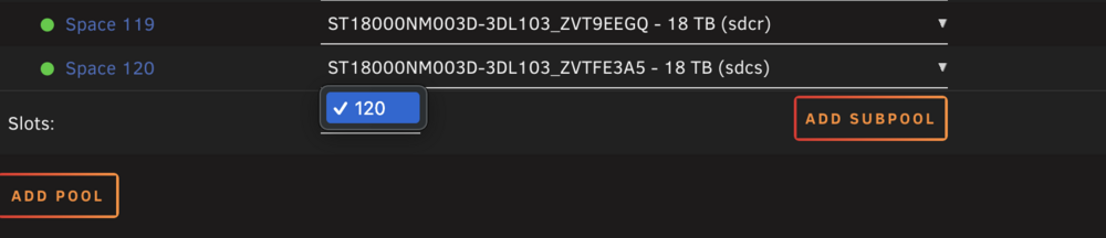

@JorgeB I currently have 120 drives in the pool. I have more drives that are connected, not being used. I would like to add them to the current pool, so that they can be a part of the same share.
As far as I know, there are limitations to the software for hard-linking. that wont allow me to use the array or another pool.
@bmartino1 You can see in this screenshot that 120 is the max. *Prior to 120 assigned, I would see all the number up to 120, but never higher than 120.
Understood, and how large would you want the limit to be? I believe this is not a hard limit, and it could be changed; it's been increased before.

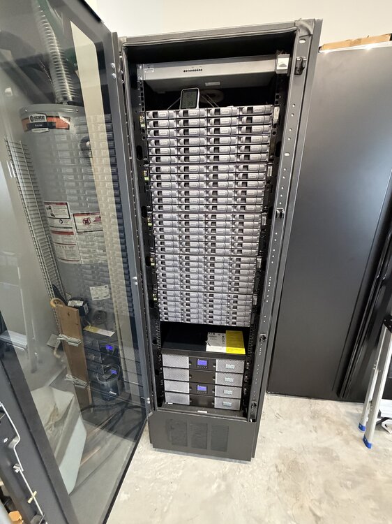

FYI, here is the current setup, (prior to adding the aforementioned 2 more shelves)
1.1PB of fully air-conditioned awesomeness

You have piqued my curiosity.
What motherboard are you running and how are you connecting all these drives to your motherboard.
I understand you have multiple dish shelves per year. Your picture here.
And I understand one pcie lane can equal one sata disc.
I'm just curious how you're connecting them all.
Then I'm curious of how you're handling your ZFS arrayed if you're having them all in one pool.
Like what is your vdev setup? Are you running a raid Z5?

@bmartino1
I love it when we all get excited about everyone's setups. I continually find myself intrigued about posts I see as well!
Recently, I was running this setup from a NUC13 Extreme (mini tower looking one). However, I have recently reverted back to an older setup, as I wanted to rack mount the server in my other rack, instead of having it standing on a shelf in the rack.
Current harward is an old Gigabyte MD60-SC0 dual Xeon motherboard. Allows for me to have dual 10g NIC coming off the Intel 82599ES connector.
I then have the NetApp DS4248 disk shelves connected to a LSI 9300-8e. 4 shelves daisy-chained per port on the card.
- I recently switched to using two of these cards, to test if any latency was experienced with 1 card... meaning 2 cards, 2 shelves per port. There wasnt a noticable difference that warrants the extra card right now.
I use an Intel Arc B380 for transcoding needs, as the Xeons do not have QuickSync.
As far as the layout, I am using mirrored pairs, during a lengthy discussion and an issue that I had with a prior layout (z1) I decided I would rather spend the extra money and have pairs. Which will allow me to remove pairs/drives if ever needed.
I am always open to suggestions if you feel I am doing something incorrectly :)

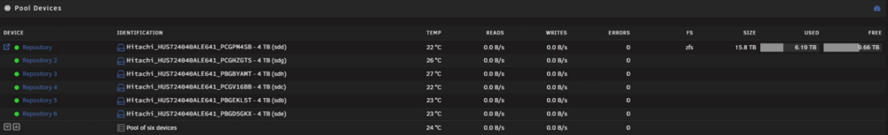

I have 60 vdevs of 2 devices

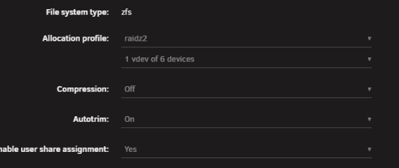

As I mentioned, I was using zfs raidz1 6wide prior. But, I learned about the limitations of pool reduction (if ever necessary, and at the time i was for me). Thus, through a bunch of reading and comparison, I landed back to classic mirrored pairs.
The data is very static, and easily replaceable if i were to ever lose two drives from the same vdev. Which I feel is a low probability. I create a report of files to drive, so I would know what was lost if that were to ever happen.
As far as I know *and I could very well be wrong.... I need to have my data located on one pool, so that I can take advantage of hard-linking.

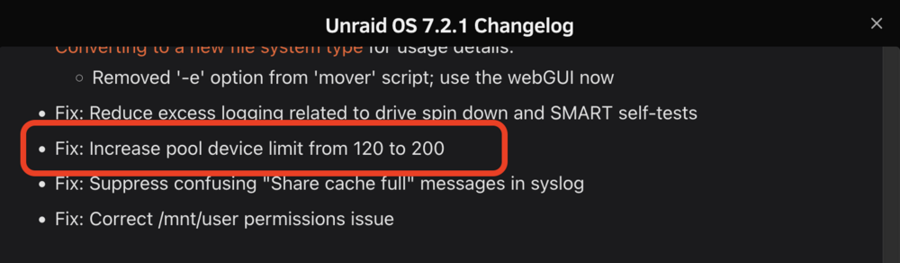

@shelfactor the next release, which is expected in one or two weeks if all goes as planned, will support 200 devices per pool.
Thanks again for the help! Great to see this:
