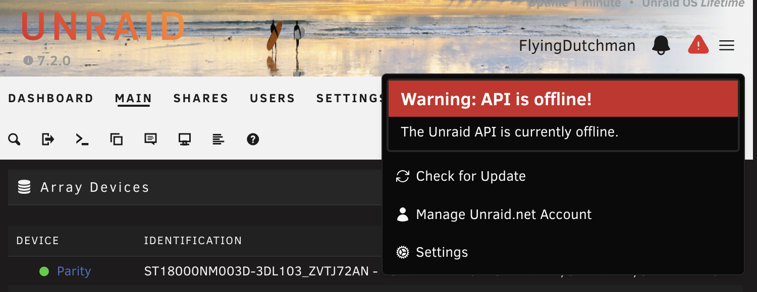

I have also had a 'Warning - API is offline' error come up briefly once or twice previously; but its since disappeared. I've no idea if this is even relevant or not but thought I'd mention it.
