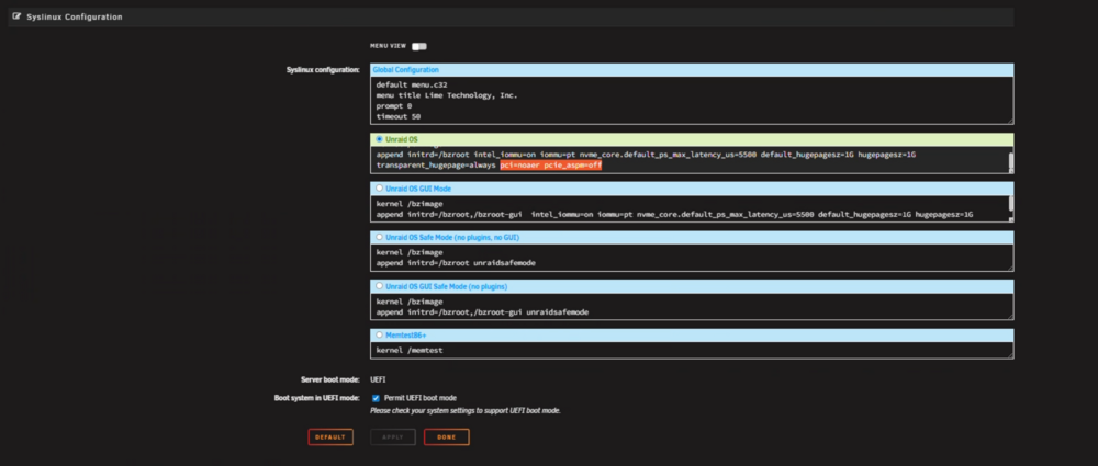

I recommend adding this to your unraid syslinux boot options:
pci=noaer pcie_aspm=off
example:

If You Want It Persistent Across Reboot
Make a user script at boot:
echo 0 | sudo tee /sys/bus/pci/devices/0000:03:00.0/link/l1_aspm
echo 0 | sudo tee /sys/bus/pci/devices/0000:03:00.0/link/l0s_aspm
8 hours ago, bmartino1 said:
example as I would need the lspci pcie device number or diag file to help structure the command..
Step 1 — Find the NIC’s PCI Address
Show all Ethernet controllers with PCI slot
lspci -nn | grep -i ethernet
Example output:
03:00.0 Ethernet controller [0200]: Intel Corporation I225-V [8086:15f3]
👉 The PCI address is:
03:00.0
If you want to match it to a specific interface (like eth0)
ethtool -i eth0
Look for:
bus-info: 0000:03:00.0
That’s the exact PCI device path.
🔎 Step 2 — Confirm ASPM Status for That Device
lspci -vv -s 03:00.0 | grep -i aspm
You’ll see something like:
LnkCtl: ASPM L1 Enabled
🛑 Step 3 — Disable ASPM for ONLY That PCI Device
Linux controls ASPM via sysfs per device.
Disable ASPM for that NIC:
echo performance | sudo tee /sys/bus/pci/devices/0000:03:00.0/power/control
OR explicitly disable link power states:
⚠ If link/l1_aspm does not exist, your kernel may not expose per-link controls (depends on kernel version).
Verify It Disabled
You should now see:
ASPM Disabled
WoW, thankyou for this detailed response once again, legend!
This method is much more appealing to me personally... I hope this thread helps others who dont want to global edit.
Im away at work atm but will set this up remotely over the next day or 2.
Just reporting back my resolution to this issue to help any others in a similar situation.
Basically any attempt to prevent / disable ASPM on the specific device failed to prevent the errors from occurring or being reported in the syslogs.
With the help of AI, I tried Masking the specific errors which also failed to have any effect.
Finally solution was to create a syslog filter to prevent only the “correctable” error logs from being reported on the syslogs which are only relative to the device in question, this way all other error will get reported.
As I know the original error being reported have zero effect on the stability of the server itself apart from filling the logs over time with unwanted errors which made filtering out new errors etc more difficult this seems the cleanest most efficient way of doing so.
I created a new syslog filter via userscript for easier management / monitoring. The script runs once after array start, as the filter file that is created does not persist after a reboot.
#!/bin/bash
# Create the file with your specific AER ignore lines
cat <<EOF > /etc/rsyslog.d/02-blocklist-ignore-aqc107-aer-errors.conf
:msg,contains,"pcieport 0000:00:1c.4: AER: Correctable error message received from 0000:06:00.0" stop
:msg,contains,"atlantic 0000:06:00.0: PCIe Bus Error: severity=Correctable" stop
:msg,contains,"atlantic 0000:06:00.0:   device [1d6a:d107] error status/mask=" stop
EOF
# Restart rsyslog to apply the new filter
/etc/rc.d/rc.rsyslogd restart
echo "Blocklist created and rsyslog restarted."
