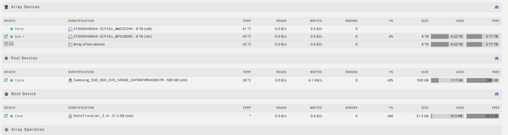

Would not recommend using NTFS as the cache filesystem; Linux has limited support for that filesystem.
Appdata exists on both cache and disk1; see which one was the issue, if the Plex folders exist on both:
ls -al /mnt/cache/appdata/Plex-Media-Server/Library
ls -al /mnt/disk1/appdata/Plex-Media-Server/Library
