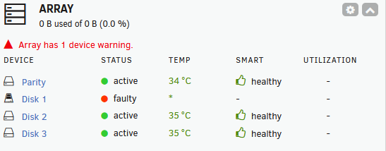

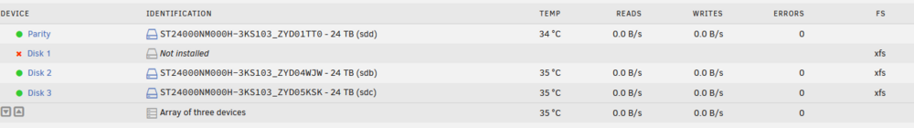

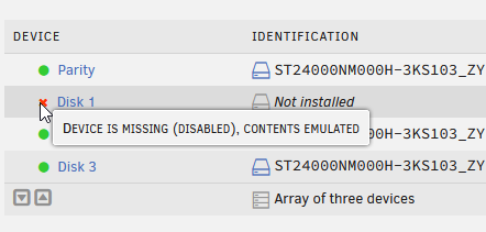

So, I had to shut down my Unraid server yesterday as I was doing electrical work around the house. When I restarted it I had 1 disk not showing up and it had a red x and the error for "Device is missing (disabled), Contents emulated". I've identified which physical drive it is and I can hear it making sounds that aren't normal. I can see the disk in the BIOS but when I run fdisk -l from the command line in Unraid I can't see the disk at all but I can see the other 3 disks that are part of the array. There are no SMART reports that I can run as well. When I start the array in maintenance mode I can check filesystem status and it returns "No file system corruption detected". I have unfortunately rebooted the server at this point, so my syslog is not super useful, but I'll attach the diagnostics file. Any help on what I can do to try and diagnose what went wrong? At this point I'm just trying to get the drive seen within some tool so that I can wipe it and RMA it. Thanks!
