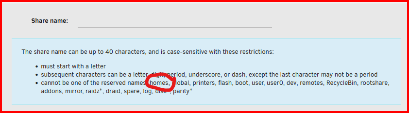

Well there you go. I hard reset the server, renamed the bugged share, restarted samba, and it mounts. So maybe there’s some bug with anything called ‘homes’.

From the SHARES >>> 'Add Share' button:
Thanks for that. These were pre-existing shares. ‘Homes’ originally came from a Synology.
Maybe make a note to flag anything zpool imports that have blacklisted names.
