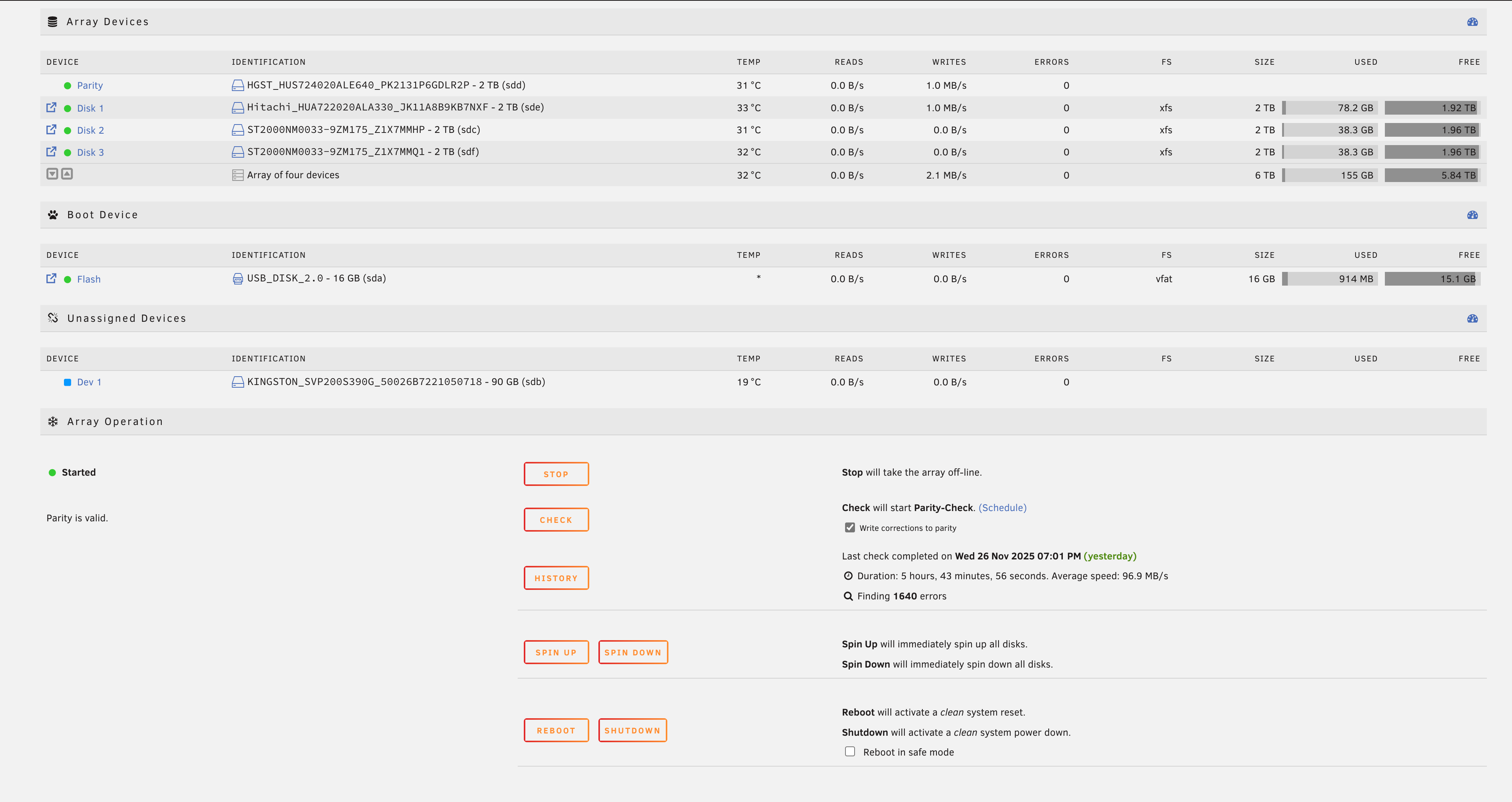

I tried again, it didn't fail but it's been hours and it's barely moving. I hope this is enough to highlight the problem. I stopped the copy just before extracting the diagnostic package which is attached.
Thanks again
n54l-diagnostics-20251127-1515.zip

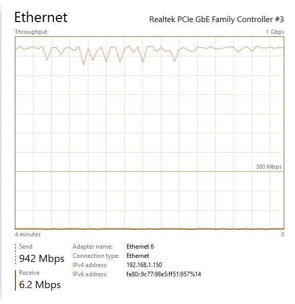

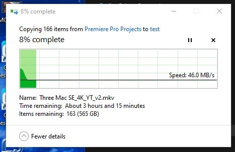

I have another NAS on the same switch, on Open Media Vault. I run some transfer and noticed a similar behaviour so I turned off all my IP-based camera and the OMV NAS started transferring at full speed with no glitches, see below
Then I tried the same with the Unraid server - it's mostly identical, a bit faster, and somehow the transfer slows down after a few seconds
Weird behaviour for sure. any ideas?
It appears to me to be the normal slowdown of data transfer after the available RAM cache has been filled. and the that speed is about the normal write speed directly to the array.
You could try using the 'reconstruct write' mode. You can fin this on the SETTINGS >>> Disk Setting tab:

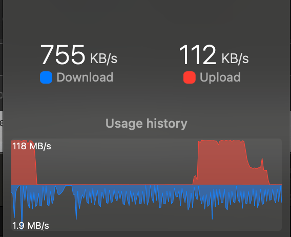

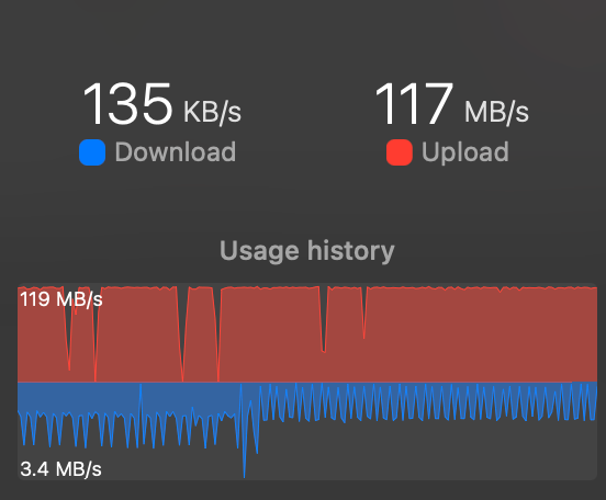

Update: So the issue where the transfer pauses for quite some time only happens in macOS. While it's paused, I do see activity on the array but not necessarily at full speed.
The tunable didn't make a difference, at least in macOS.
This is what my Ethernet looks like when transferring. Sometimes it does slow down as in Windows but most of the time it just stops! That graph is pretty slow, I reckon there are 1-2 minutes between those chunks!

I can understand the speed drop but transfer stopping altogether for like a minute when transferring? This is only happening in macOS apparently.
This is not normal, but if there's still nothing logged on Unraid, it suggests an external problem.
