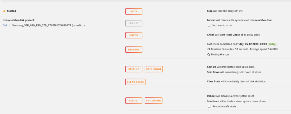

[UNRAID 7.2.0] Disk NVME appears to be unmountable after reboot

2 hours ago, Leviathan_sama said:
Partition #1 contains a vfat signature.
This is not an Unraid supported filesystem, any idea how that signature got there? Only the flash drives uses FAT.
I did an install of Ubuntu server before swapping to Unraid. Idk how it goes there.
It worked well for 2 weeks until i did a reboot
Edited by Leviathan_sama
Possibly a device or its firmware issue, since the partition is gone.
