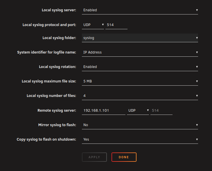

I woke up this morning to a complete unresponsive server, to the point that even attempting to connect my extra monitor to see anything on the headless console didn't work. I checked my router, and it reported the network port going down shortly before I got a ton of service outages from my cloud vm monitoring the services I expose. Syslog is set to write to the share I have, and after an unclean shutdown there is no log entries for the period it was down.
But is it also set to write to your server?
Post a screenshot of Syslog Server settings.
