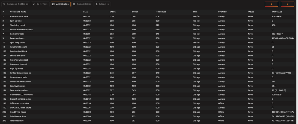

Ran a smart long test, no error. Last time, I also changed it's sata cable (connected to an HBA card). Smarts data look OK

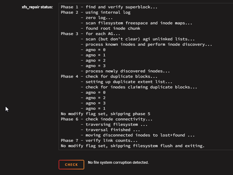

edit: I started in maintenance mode and ran a XFS check, file system corruption detected. But when I press fix it, it says it's busy
edit 2: It crashed my server. Had error on the monitor and WebGUI was dead. I did ctrl+alt+del to force a reboot which worked. Now it's back up and the file system is mounted properly. I don't understand what's going on...
And now, it doesn't show as corrupted anymore...
