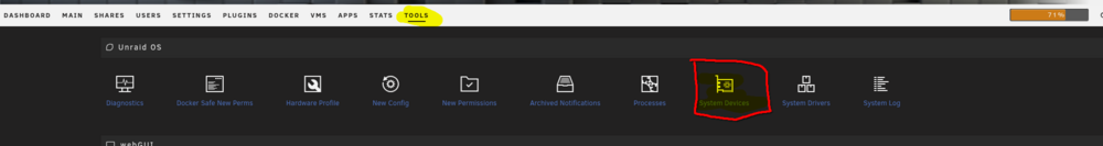

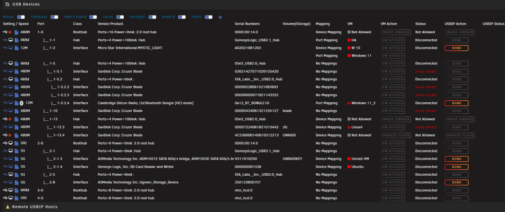

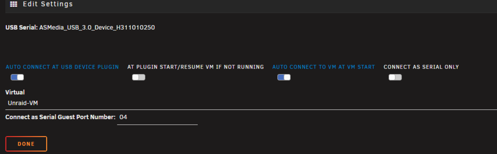

image.pngClick on the second icon device mapping, first is port mapping. Then it will take you to the settings. Select the VM and enable auto connect at plugin and VM start. The printer will need to be active for it to show in the view.

Great - it seems to be working now.
I tried to power off/power on the printer and I could see from the VM the printer when it was back. Without restaring the VM!
I will do more tests with the standby mode/power off etc to see if everything is ok.
What was misleading for me when I initially saw this option was the decription: "Auto connect at plugin and VM start",
since I could see the printer after restarting the VM, I didn't conclude that it works also without restarting the VM.
Thanks a lot for your help!
