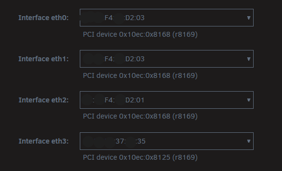

I can't seem to find a way to do that. The confusing bit is that when I navigate to the Interface Rules page there are four interfaces listed: eth0, eth1, eth2 and eth3; eth0 and eth1 have the same MAC address, while eth2 is slightly different, and eth3 is the one I'm pretty sure is the new card (the PCI device name ends with 0x8125, while all the others end in 0x168):
The options in the drop-down menu also contain the duplicate MAC ending in D2:03. Any idea how you would change the above so there's no duplicate MACs?

hmm... strange...
maybe it is best for you to disable the onboard nics in BIOS?
(maybe one of them is not really meant to be used as a general purpose network interface, but for management access only? Or could it be an ISCSI port or something?)
Edited by MAM59

1 minute ago, drmit said:
Ideally I'd rather not shut them both off in the BIOS in case I decide to repurpose this 2.5 GbE nic later down the track, and then can't work out why the onboard ports don't work...
Switching them off wont kill them.
You can reenable them later on at any time again.
Just to see if things clean up and only eth0 is left after turning them off.
( I would become a bit suspicous about the "teaming function". Every NIC can be used for teaming, so why do they meantion it specially? Or is there a direct teamin support in the BIOS? (if yes: TURN IT OFF!))

I happen to agree with MAM59. I too have the RTL8111E onboard LAN NIC, but with only one RJ45 port. I tested the onboard NIC for three days before deciding to pull my 2.5GbE NIC from my retired Windows server. All I did was boot into the BIOS, I disabled the onboard NIC, shut down the PC, installed the new NIC into the PCIe X1 that was furthest away from the x16 slot and the CPU for a cleaner signal and booted Unraid back up and it just worked as if nothing had ever happened. My transfers to the Unraid server now stay pegged at 285 MB/s or so. Exactly what I was looking for.
After disabling both onboard LAN ports, I was able to reboot and see that the 'Interface Rules' link was gone from the Network Settings page, with only 'Interface eth0', 'Interface eth3', 'Interface Extra' and 'Routing Table' as options. Everything seemed to work OK but eth3 was showing in red as not configured. I couldn't figure out how to reassign the MAC at eth3 to be eth0; eventually I clicked a 'Reset' button on either the eth0 or eth3 page (a bit unsure which) that nuked my connection to the server entirely, after which I couldn't log back in from a browser on my Windows PC. I restarted the server, logged in via GUI mode and noticed 'Interface eth3' was now gone. I now only have 'Interface eth0', 'Interface Extra' and 'Routing Table' as options on the Network Settings page. Bonding and Bridging were now turned on by default in eth0 - those were off in the previous configuration, so I switched them off and all seems to be running well.
So I don't know if it was switching off the 2 onboard LAN ports that allowed me to use that 'Reset' button (don't recall that being there previously?), or if that Reset button was there all along and all I needed to do was click it.
