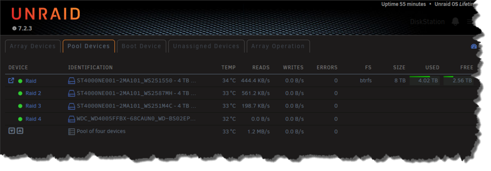

Disk replaced - new one not mounted correctly
I've replaced a crashed disk by a new one with same capacity.
Made a 'New Config', started the array and rebooted.
In 'Main' view, everything looks correct.

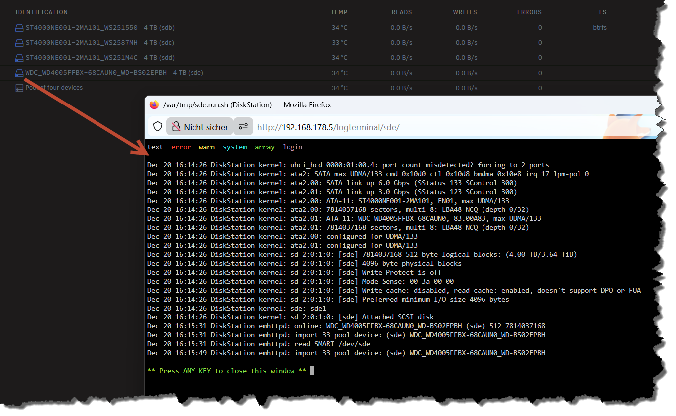

But I was wondering why there's never any activity on that disk.
Looks like the disk is not mounted correctly.
Edit: S.M.A.R.T runs with no problems and does not show any errors.
What can I do?

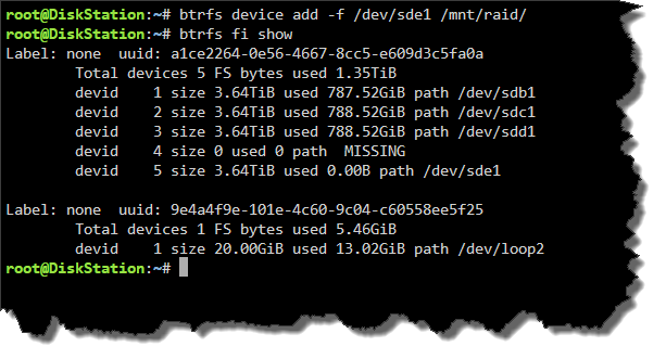

I can add the drive to btrfs with no problem.

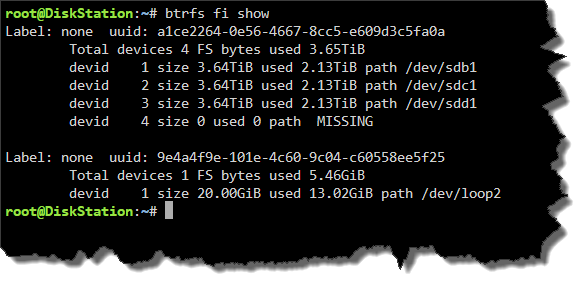

52 minutes ago, Codierknecht said:
Done exactly as recommended ... same result
Device 4 is not being used to replace the missing device; it may need to be wiped first.
But since you now added to the pool, you will need to manually remove the missing device, then reimport the pool with the 4 existing devices.
With the array running type
btrfs dev remove missing /mnt/raid
once that's done, reimport the pool as before, but with the 4 devices
Currently removing the missing drive.
This will take an amount of hours ...
That should be instantaneous unless it's doing a rebalance for the new added disk.
I was able to mount it 'degraded'. After a reboot the pool is up and running again.

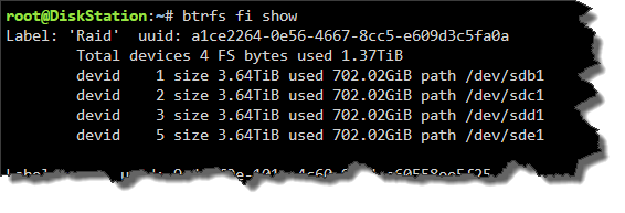

It looks like the edvie replace was still ongoing, with the pool mounted degraded post the output of btrfs fi usage -T /mnt/raid
I've canceled the ongoing operations.
root@DiskStation:~# btrfs fi usage -T /mnt/raid

The pool is currently not degraded, though it looks like it's not totally balanced.
Already started balancing ...
Perfectly balanced now :-D
