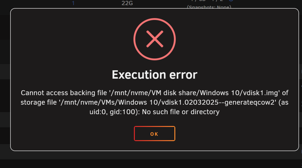

Unable to start VM after renaming share
So I went to the shares tab and saw that some of my shares had "illegal characters", apparently spaces in the share name aren't allowed anymore. So I renamed them, one of them was my VM share. And now when I'm trying to start the VM i get this:
I see that the first path has my old share name, but I can't figure out how to change it. I've looked at the source path in the xml view, and it has the correct path. If I change the vdisk location to just vdisk1.img it starts, but that restores the vm from before I took a snapshot it looks like. I've also rebooted to check if that would fix it, but no dice. I would like to fix the path so I can just start the VM and come back to where I was. The snapshot is old, so last option is to restore to that. Does Anyone have a clue how I could fix this?

The way snapshots work is it creates an overlay file which has a backing file. The VM could not find the backing file as it was moved. The info on the backing files are stored within the qcow2 file and not within the template.
