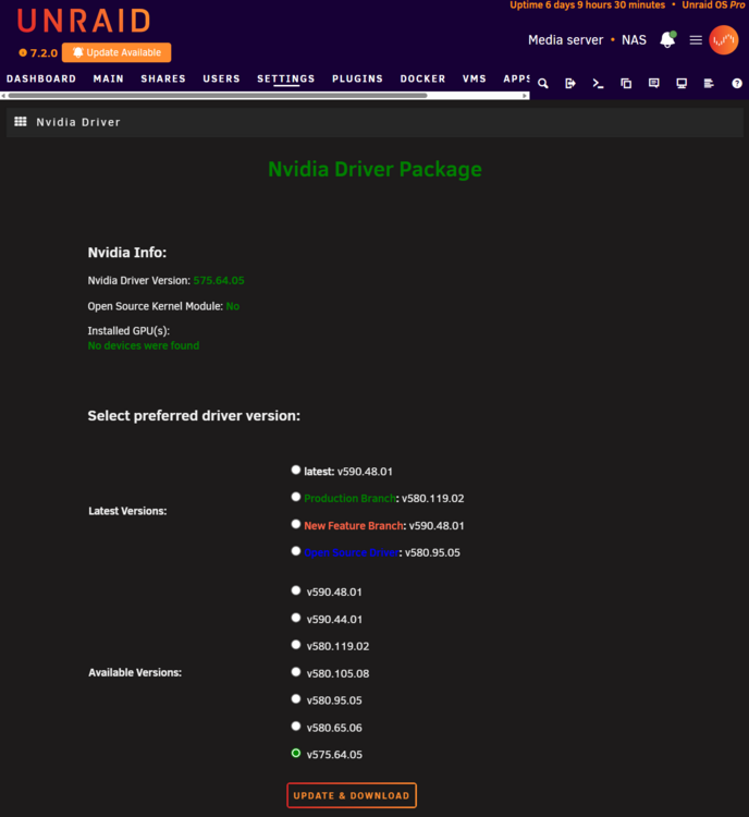

So I mainly use this card for Plex transcoding, and when the Nvidia driver is detecting the card normally, it works flawlessly. When trandcoding, the GPU statistics plugin correctly displays the Plex icon and nvidia-smi returns the appropriate data. Needless to say, I have correctly set up the Plex docker for the nvidia transcoding. I DON'T have it passed through to a VM.
However every few weeks, the nvidia driver/plugin decides it no longer wants to detect the card, and will not detect it again until I reboot the entire server.
I've attached diags and screenshots. See below.

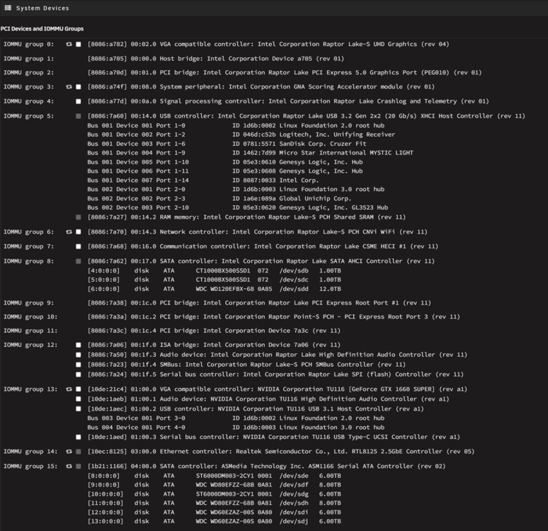

The card is visible in system devices under IOMMU group 13: [10de:21c4] 01:00.0 VGA compatible controller: NVIDIA Corporation TU116 [GeForce GTX 1660 SUPER] (rev a1).
However I can find no trace of it anywhere else. Even running 'nvidia-smi' returns 'No devices were found'.
I've double and triple checked that the card is seated correctly. I've deleted the Nvidia plugin/driver, stopped docker, then reinstalled several times. I've rolled back the driver as far back as the plugin will allow (v575.64.05), but still no success.
I'm sick to death of logging into the web UI and discovering that the GPU Statistics plugin has not detected the card (god knows for how long), and I need this fixed PERMANENTLY.
