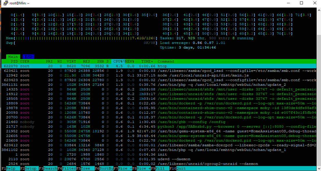

As soon as I get in via SSH and look at htop, I don't see any obvious cause for what is causing the revving. I don't see anything in syslog either. Whatever it is, it's either not getting logged, or I am just missing it when I ssh in.

edit: I just heard them spinup. I was already ssh'd in. I don't see anything odd in this htop.

screenshot of htop activity
Supermicro motherboards sometimes interpret low fan speeds as a fan failure, which causes all fans to spin up to 100% (fan "panic" mode) until the perceived "failing" fan's speed increases. You need to check and adjust the lower non-recoverable (LNR) and upper non-recoverable (UNR) fan speed thresholds. Either via IPMI or maybe use the fanctlr plus plugin as I mentioned (you might need to disable IPMI if possible), install the system temp plugin to monitor temps. Since this is a fairly new server, I assume there is no dust in the fans and the server itself?
