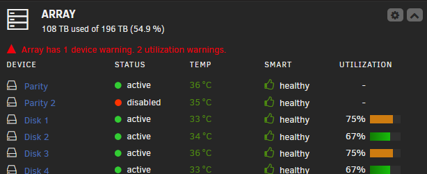

I need some help figuring out why one of my drive is disabled. This is the second time this has happened after a reboot after I swapped the case. I added 4 more drive and I thought my 850w PSU would be able to keep up. These 4 drives are directly connected to my motherboard while the existing ones connect via an HBA.
For the second time I reboot, at least one of my drives would go under the status 'drive is disabled'. I tried swapping the connection between the drives but the device is still disabled. Last time was one drive, this time it is a parity drive and another drive. I am rebuilding it.

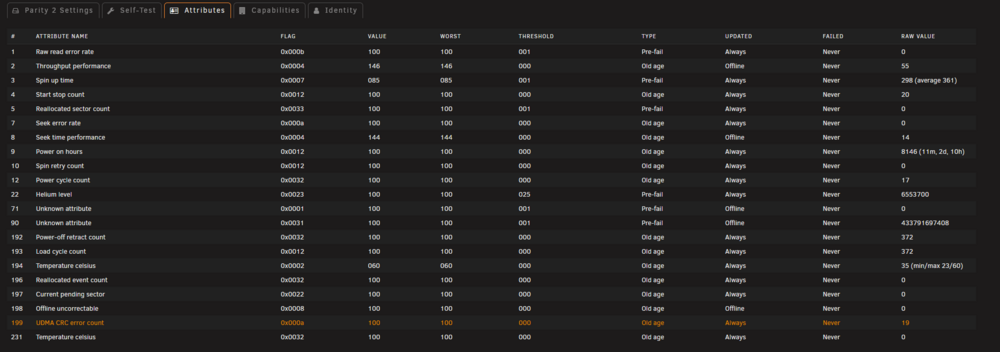

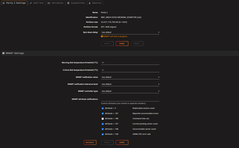

I would appreciate any help. I attached the log of for the SMART report for the last drive that was disabled.
WDC_WD241KFGX-68CNGN0_SZG8XT3M-20260112-1103.txt themyscira-diagnostics-20260112-1110.zip

Yes, it is being picked up but it is showing as disabled.
"Disabled" is not the same as "spun down," but post diags like mentioned.
