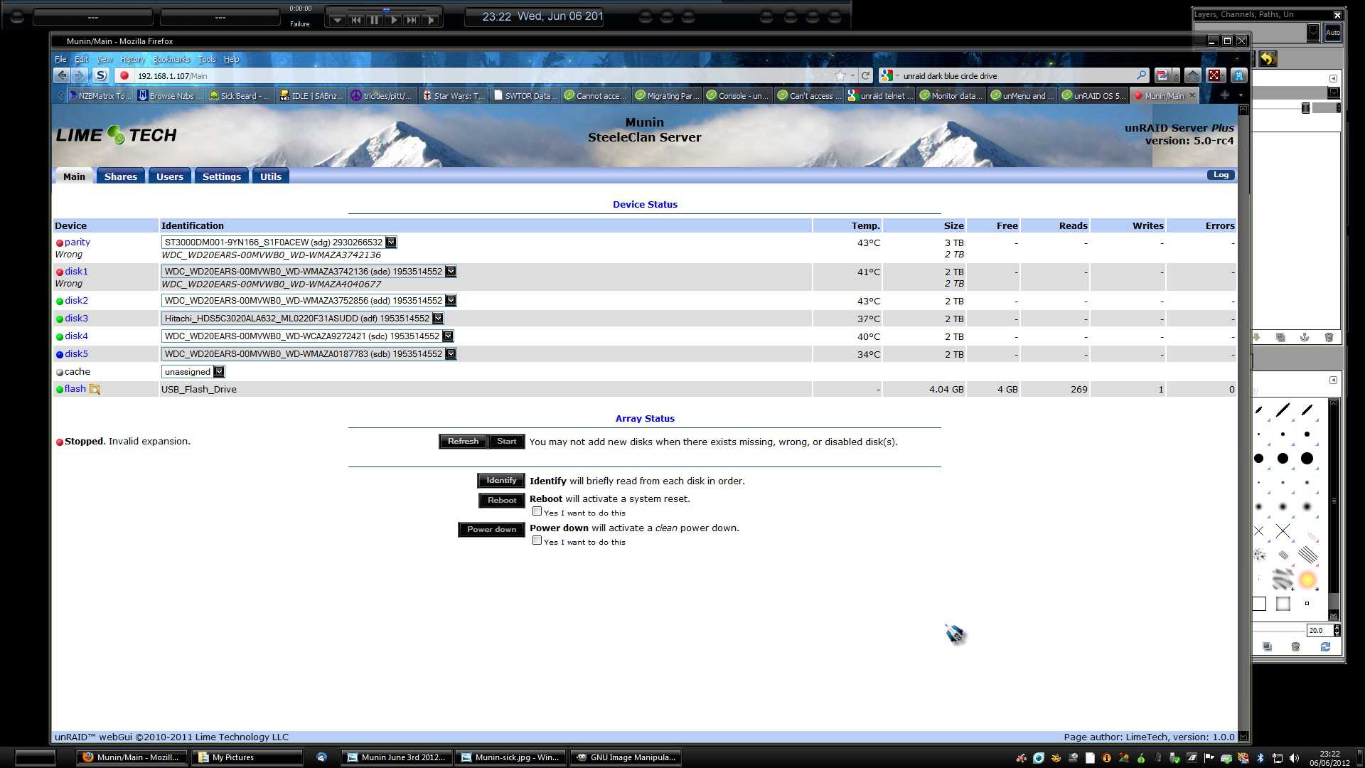

Okay, I swapped the failed disk out for the parity disk, and put the new 3tb disk in for the parity. Boot up the array but I cannot start the array to initiate the parity-swap. Also, my 5th disk is showing a dark blue ball as well. Any ideas folks? Attached is a screenshot.
Edit: Oh, and strangely enough I could only access it by IP for both telnet and GUI. The server's name is "Munin" but for some reason won't connect using the name. (Win7/Firefox)
you did not do as instructed.
The "swap-disabled" procedure can ONLY be used if the initial disk to be replaced is ALREADY disabled and all the other disks are working and no other changes are being made.  Your data disk was not ALREADY disabled.
So...  to attempt to get back to where you were... put all the disks back where they were.  Put the old parity disk in place as parity.    remove the new disk entirely.

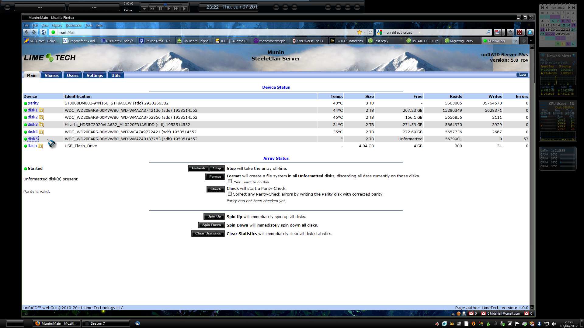

1) On any machine but my main computer, I get access denied to the folders/files in the shares. I've run the permissions script, but no change. My main machine runs into "Read Only" issues as well. Not all files are affected, just most it seems. I'll work on it as there's a few things on the forum I haven't tried yet but I'm way too tired atm to try. (Switching to nightshifts tomorrow, I get a long sleep tonight and a few hours alone to tinker tomorrow afternoon.) Hopefully it's easy, as I'd not run into this issue before the upgrade.
2) Disk 5 shows as part of the array, on the GUI but unformatted. No files/folders are visible, and format type is listed as "unknown". Now, I think I might have somehow initiated a format for a few moments when I was dealing with my incorrect protocols earlier while trying to join it to the array (See post above about the "blue ball".) but managed to shut the server down quick. Foolish mistake I know, I blame fatigue for misreading plain language. Now, if the data is still there awesome, and there's still somethings left to try I recall reading on the forum. But I've been up 19hrs on 4hrs sleep and I've learned to my chagrin not to attempt complex computer issues dead tired so I'll again look at it tomorrow. I do have a couple quick questions though if someone knows off the top of their head:
    - Since the new parity drive was a copy of the original one, can I trick the array into thinking Disk 5 failed and has been replaced, then let it recover the data? Or did it rebuild parity on the old parity disk, (the new disk 1) when disk 1 was restored, using only the available drives? I'm not sure if the parity-swap was a straight swap or a swap/rebuild.
    - If the drive can't be recovered, will the array still take it as precleared and result in a quick format or would it take N-hours and better to pull it from the array, preclear again and then reintroduce it as a new disk to start storing data on it again? Near all of it's data was TV/Movies it's a matter of time to replace more than anything.

See Check File Systems in my sig. Post the output if its not successful.
Just a bit of an update (and again thanks for the continuing support and input.) I ran the reiserfsck --check, and then --rebuild-sb as recommended. Currently attempting to rebuild the tree, although it's likely going to take about 7hrs or so if it remains constant. I have my fingers crossed, but honestly if I have to fully reformat this disk I won't cry, it'll just take time to rebuild. (Nothing vital on it, just media.)
