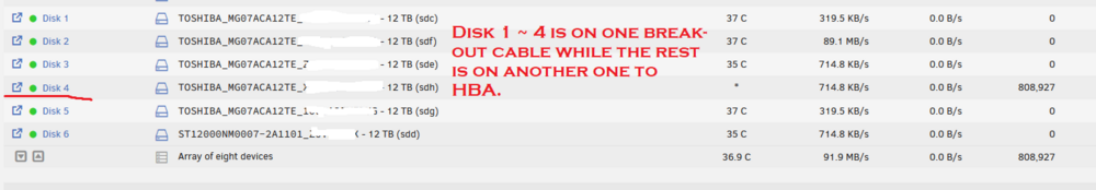

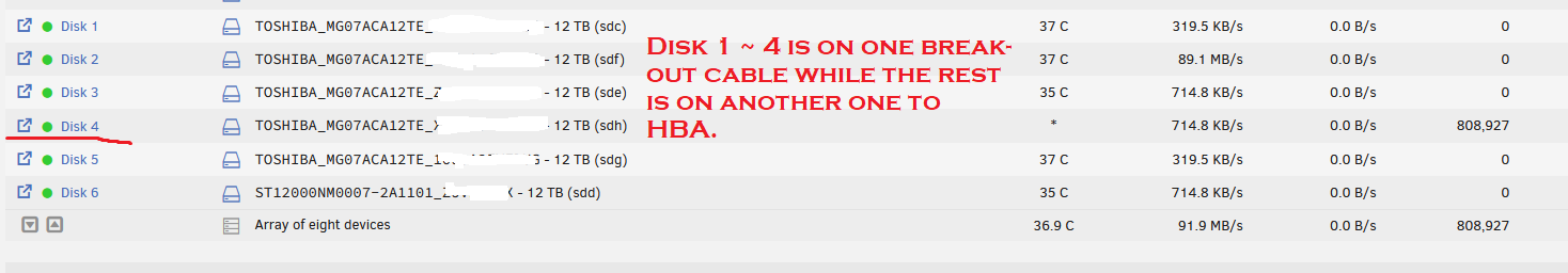

The last time this happened it was flagging Disk 3 with issues right around the 57% parity sync point. This time with it now shows Disk 4 with errors. But now that it's gotten me thinking.... 1~4 is on the same 8087 to SATA breakout. So it could be somewhere along that set of cables is bad on that stack?

I'm guessing if the array build up to 57% again and the cable for whatever reason drops the connection to the drive then it might be the cable ? I know cables aren't always perfect and sometimes they just go bad without any rhyme or reason. But new set of cables are on the way.
