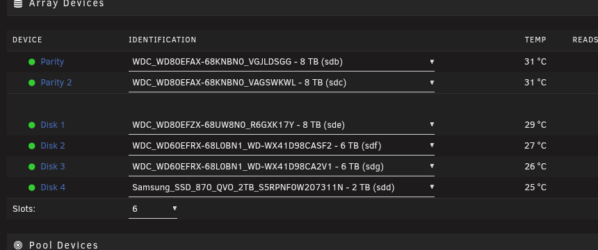

Following the link @trurl posted, I was able to rename the super.old to super.dat, which has brought the disks into an array (as they were) in the correct order. For safety's sake, would you recommend using Maintenance Mode to run any checks that might need to be done here? They appear to be in the right order, but I don't want to run any more risks than I have to. image.png

It would be better to start the array in Normal mode so you can see if the filesystems mount and you can inspect their data. In Maintenance mode, you can't access anything since nothing is mounted.
Thanks @trurl - I'll do that. At the moment I've followed @Arbadacarba's suggestion and begun pulling off anything I'd be scared to lose, so I'll kick it over into normal mode once done and update with progress.
