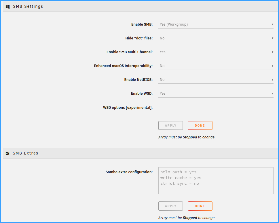

I've made some SMB settings changes as well, but again, no change. (Current settings are in a screenshot attached.)

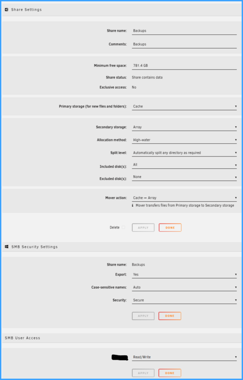

You can try these things to check it out:
  • delete the file on the server BEFORE you try to write it (and wait 1-4s to give the filesystem time to update). If speed goes up to almost 10G speed, you know that the 200 are "normal behaviour".
  • create a share that ONLY resides on an SSD drive (primary = SSD, secondary = NONE) and check the write speed. If it is as high as expected (~500 MB/s for SATA SSDs, ~1 Gb/s for NVMe SSDs) all is fine too.

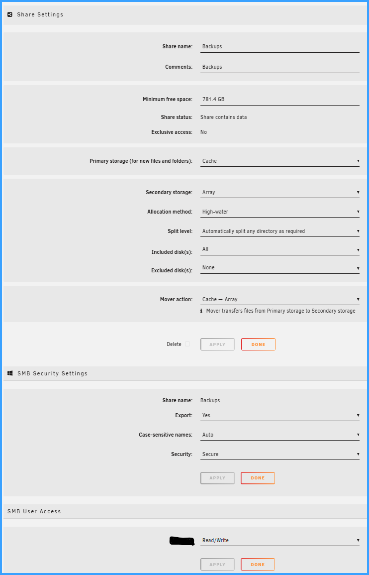

I forgot to mention, I was diligent in renaming files before each test so each system always saw that file as 'new'.

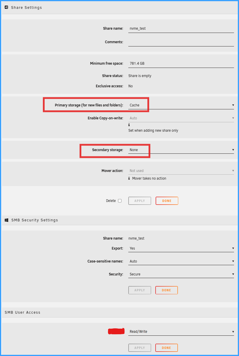

I like the cache-only test, and I did that, sadly to no change in write performance at all.
Attached are two screenshots. One is of the cache-only setting configuration, the second is of a brand-new file being copied to that share.
Any other ideas to try?
Hmm... for further tests pls stick to the cache-only test. This is much more reliable about speed.

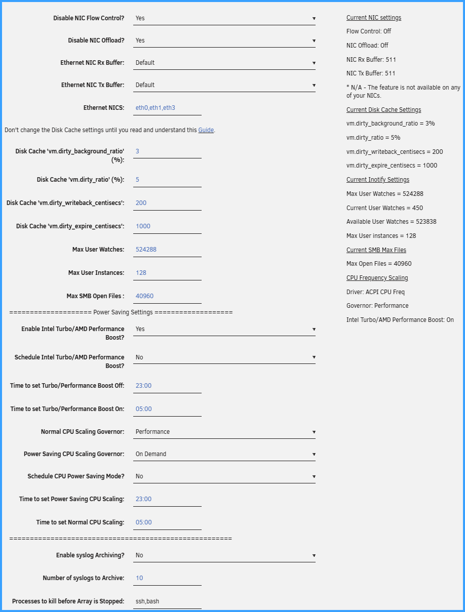

Attached is a full screenshot of current Tips and Tweaks as well.

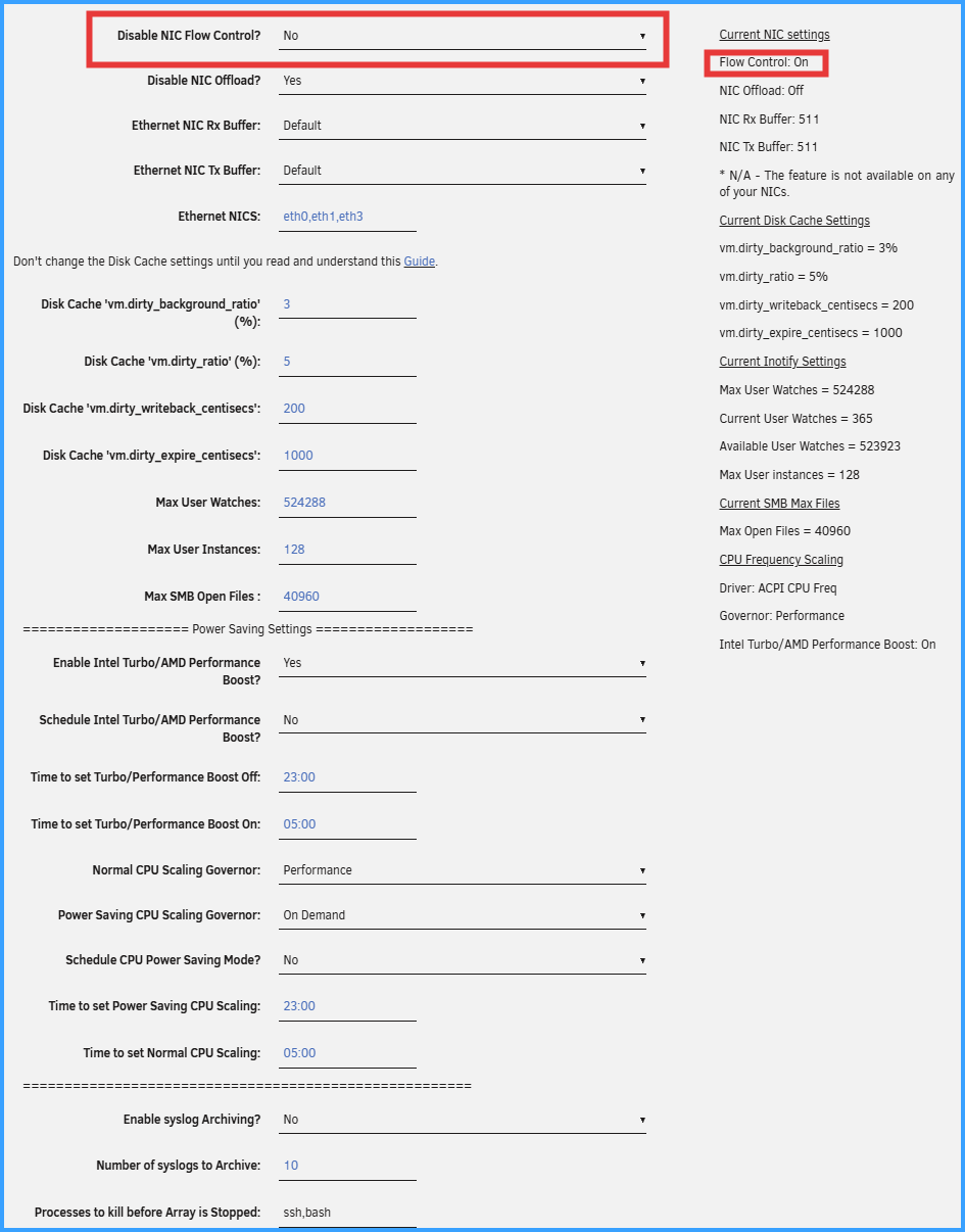

16 minutes ago, Magua said:
Advertised pause frame use: No
This makes me worry... it is forbidden somewhere
17 minutes ago, Magua said:
According to Tips n Tweaks, 'Disable NIC Flow Control?' was set to 'Yes' already.
You have got me wrong, it must be set to NO!
(you want to enable the feature, so you have to turn off the disable flag. Its puzzling... double negative)
Ah, understood. Thanks for clarifying.
I've changed that setting to 'No', rebooted and tried a few more tests. It helped, but only about a 25% improvement or so.
Copying from Unraid's NVME to Windows or Mac is still 3X faster than writing.
Current screenshots attached - with the changes highlighted in Tips n Tweaks.

hmm, next you should turn off "disable NIC offload" in Tips&nTweaks... (again a double negative!)
Why do you make your smart NIC dumb as hell and burden all the work onto the main CPU?
Edited by MAM59
Well - that change made a huge improvement:
I clearly didn't understand that 'No' for disable offload was the preferred setting.
Thanks for the guidance. Still not 10GB, but much better. Any other settings I should look out for?

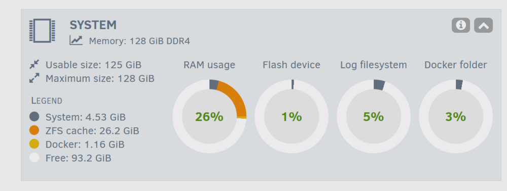

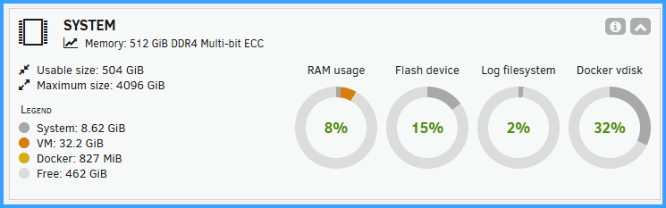

if this was your first zfs disk, you would have needed to reboot after formatting I think.
The cache is only allocated at boot time, you can see it in the dashboard then.
If there is no entry "ZFS Cache" you need to reboot before you test
(Note: after reboot it will not occupy any RAM, but the dashboard will add this new (orange) topic and you will see it grow (and shrink) when you start your tests)

After another reformat to ZFS, then a full system reboot, I did see an improvement. Initially it was roughly a hair under 500MB/s (without a reboot).
With the reboot I'm seeing around 600MB/s flat.
