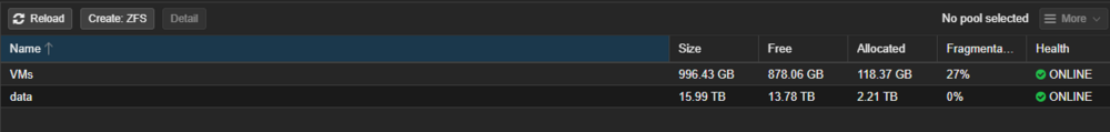

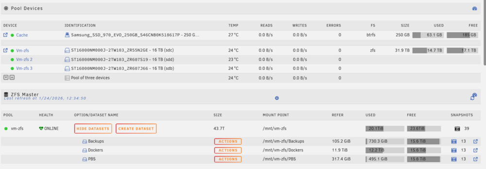

Correct in theory and on paper, yes there is a performance hit. I manage multiple systems between some friends ins a ring network using unfi equipment and unifi's "teleport" / free site to site(one person owns the unfi router...)... A WireGuard vpn to rsync data between each other using the sftp docker, filezilla and user scripts. More, Plex media libraries, disk rips. Important data between each other.
We have been running unriad for the past 10 years(all of v6 and v7) and moved to zfs when possible(having tested truenas core, scale, omv, 45drives, etc...)we settled on unraid as it just works and has a nice Docker UI for easy access to console, log, control and maintain... (That said enterprise/commercial may have you look at Kubernetes, helm, portainer... dockers orchestrators) Unriad is OG dockerman and per research that is now under the podman docs.... BUT, I personally haven't seen issues with "Iops" i/o and latency with database and small files with read and writes. That said small files do happen and can cause more disk thrashing and is there more a mention as different hardware, silicone lottery and other user experiences can vary.
So
RAIDZ1 is described as being fast for large files but less ideal for small, random writes. If I’m keeping my Docker containers and VMs inside that pool, wouldn't that be an issue? I’m concerned about potential latency since parity must be calculated in real time.
Yes, it can. this is where monitoring and when you would add a special vdev to zfs such as l2arc to assist and help performance. That said we are talking enterprise level to see a impact. Something that sits idle won't really see this. Also unriad array is more famous for when things are idle and not active. Something like a database, monitoring or 24.7 plex will keep a disk spun up. zfs loses the power saving power draw that you would see in a traditional disk 1, disk 2 parity with the traditional unraid array setup.
most form reviewing the docs:
https://docs.unraid.net/
I have recently separated(refactored) my proxmox all in one (due to issues with aging software and hardware) with a bare metal to run plex, arrs on its own bare metal system. To assitn in separating our large plex libraries.... Using Iptv, plex, arrs to help monitor content I have legal access too and can acquire. this was more a recent hardware refactor of what i want running what and how to interact with it. More due to how my work vpn behaves and that I use for the plex and ars system...
That said I attempt to help where I can having messed with things Example For immich:

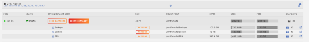

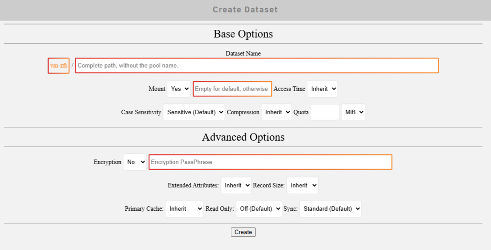

So…
Example /tank/media
In the end a dataset does become a folder path, that’s a regular folder(media) at the base of the pool (tank) and you can make datasets of subfolders...
But unraid will only see the base folder at the very beginning for shares.
zfs pool of 3 disks raidz1 lets call it tank. zfs will root map the disk to /tank on distros. in unraid tank can be found at /mnt/tank
we can make a dataset called media
And another dataset in a dataset /tank/media/sub-dataset (via zfs create commands or zfs master plugin)
or use the media dataset i.e. mkdir /tank/media/folder
When you make the original share data set of tank/media.
This will be seen in the unraid under the share tab and will be added to the samba config and NFS config if you enable it for sharing. (sometimes you have to fix unraids share settings of primary disk...
At creation of tank/media, you can specify and use specific ZFS commands in the terminal or via the ZFS master plug-in and set things such as encryption, compression, deduplication case, sensitivity, and other things that you may or may not want based on the nature of the data that will be added to this data set.
Unraid only handles the base Main dataset. so ideally while one can have subdatasets its recommend to plan for pool/dataset/folders_and_data
As you can create a sub data set within a main data set. but that can cause issues As you created a sub data set within a main data set. An unraid will not be able to manipulate or use this with the shares via the web ui...(thats what i have found in testing
And a data set is different compared to the folder. form snapshots and access. As the folder is data within the data set which will be then handled by the snapshot.
So ideally you would make a data set for backups that would have compression and deduplication.
For media because of the high volume of movies and picture files, you may not want compression, but you may want other a ZFS options.
Depending on other share folders so those pictures samba cloud. Whatever you call your folder structure moving forward.
This is especially important when we get to docker's folder structure on where data is being stored and how the docker is interacting from the containered version to the host unraid.
A good example is the ars setup:
https://trash-guides.info/File-and-Folder-Structure/
Unraid uses what's called a fuse system
https://www.youtube.com/watch?v=xec1DHpmztM
So even though the pool is tank/media
Unraid will have a fuse structure located at /mnt/user/media
This is akin to Sim Link and shortcuts.
And you would most likely want to interact with all the data at Mount user.
Unless you want a disk share and you want it directly on the pool then you want to mount it at tank/media.
Is very important to have set up a folder hierarchy structure, especially when you have multiple disks. Of what data is expected to be stored? Where.
And your case because of the single cash disk.
I would expect Docker data such as app data. The configurations that run dockers be stored on the nvme drives.
And large storage files such as media pictures that would run from the dockers be stored on the separate pools such as the SDDs or the hdds.
And those pools are then used for short-term access, deep storage and other various aspects to maintain your data.
Raid is not a backup. It is redundancy and house. Keep up time.
This is also where we go into the 321 rule.
Important data needs to be stored on three disks at two separate locations with one off-site location.
This is the guarantee file recovery, backup and access to a file.
The 221 is also acceptable. Two discs two locations one off site.
And this is where the nvme disk drive or single pool may not be best practice but functions just the same.

Expansion can happen in a number of ways. 3 that I have tested and used...
My example 1:
I have 3 Seagate x16TB exo disks. ZFS uses the lowest disk to set and use as estimated size.
To increase space I can do a couple of things.
1 slowly replace each 16 TB disk with higher capacity disk... ie get 3 disks 18TB, 24TB, etc... (all 3 need to be at higher capacity)
after the 3rd 16 TB replacement disk it ZFS will increase space. if i grabbed a x18 and 2x 24 then I would lose the detail space form a 24 TB as they would drop to 18 TB and i would gain aprox 2-6 TB of additional space.
Then later when I get another 3rd 24 TB I would gain the additional 10TB...
OR. I can add a special DISK and make another vdev adding to the existing disk of pools. Adding another new vdev (as the existing 3 disk) or ad more disk and make a new pool. All on how you want to handle storage.
It comes down to what makes sense for your setup and data...
Otherwise, I have to have the disk in hand I make another pool and copy the data off the old as I can pull a disk use that as a main running degraded and build a new set of disk pools...
But yes, ZFS can and does lock in due to how it handles its raid machines... making expansion complex not impossible.

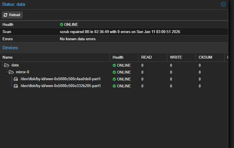

example in my PVE: ( I let pve control and mange zfs and pass teh data vbpool into my unraid VM for data... unraid gets a qdisk for a single cahce disk taht is using my nvme vm zfs mirror.
*this way unard still has disk via QEMU shaniagins and done't touch the disk (as i'm short on borad pcie lanes to pass the disk into the vm to be seperate form the host so why not let the host mange and control the disk and let unriad interact with them akin to a samba share.
I have 2 disk in a mirror:
since both of theses disk are in a mirror I can't add a disk and change it to a zfs raidz1 its done at the beginning. so zfs expansion can be a bit tricky. Same in unraid once you set the pill # of disk you would have to delete the pool and its data to change form a mirro to a riadz1 to a raid z2
That said zfs, unraid and features to do this are in progress and incoming open zfs is working on new expansion stuff.
https://www.youtube.com/watch?v=tEBpfzVzNiY
OpenZFS does not support in-place conversion from a mirror to a RAIDZ1 vdev; the pool must be destroyed and recreated. To migrate, you must back up all data, destroy the mirror, create a new RAIDZ1 pool using all desired disks, and restore the data...
