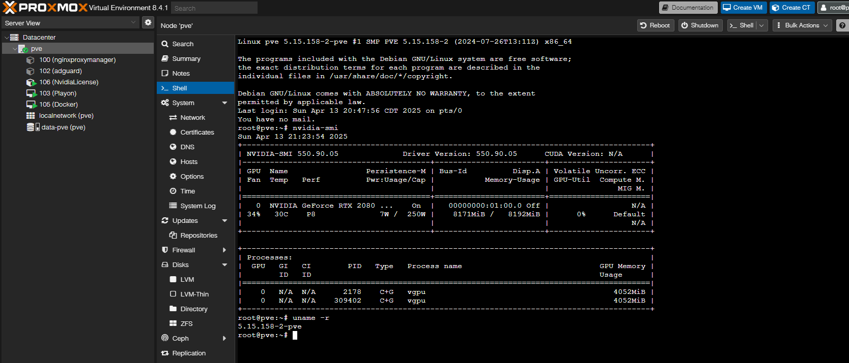

-- In my case with the Nvidia opening nouveau for mdevctl and open source drivers, I'm using VGPU...

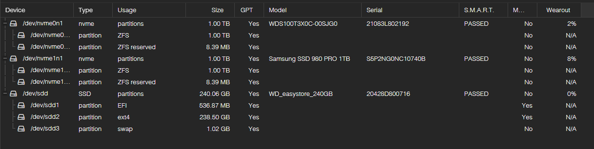

root@pve:~# ls -l /dev/disk/by-id
total 0
lrwxrwxrwx 1 root root  9 Nov  9 13:00 ata-WD_easystore_240GB_####### -> ../../sdd
/dev/disk/by-id/ata-WD_easystore_240GB_#######
grub I blacklist ata-WD_easystore_240GB_#######
Here we need a list of ata-WD_easystore_240GB_####### for udev rules...

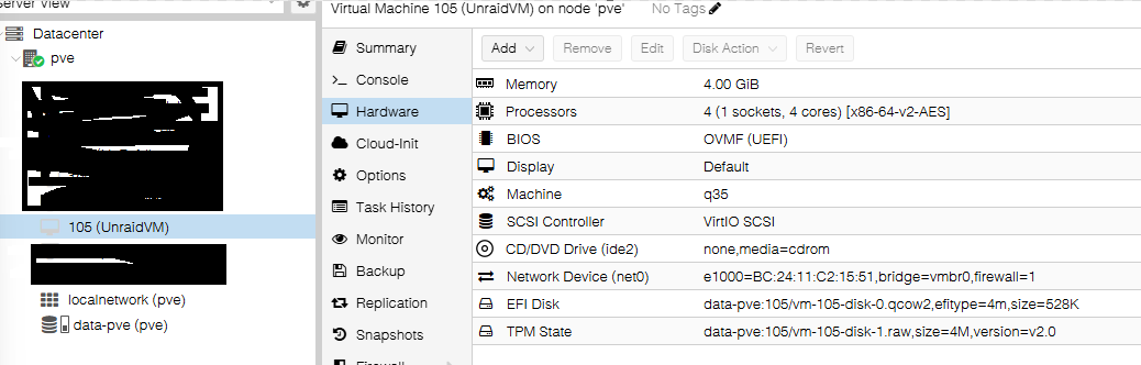

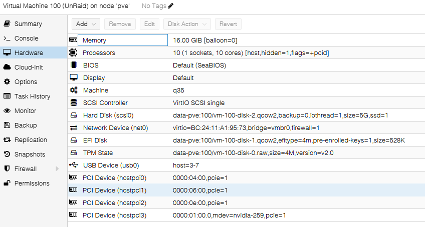

Lets begins create the vm set name and ID ###
No Disk Drive, Linux 6.x
It is recommended to use q35 and UEFI it will work for both ifx and sea bios...

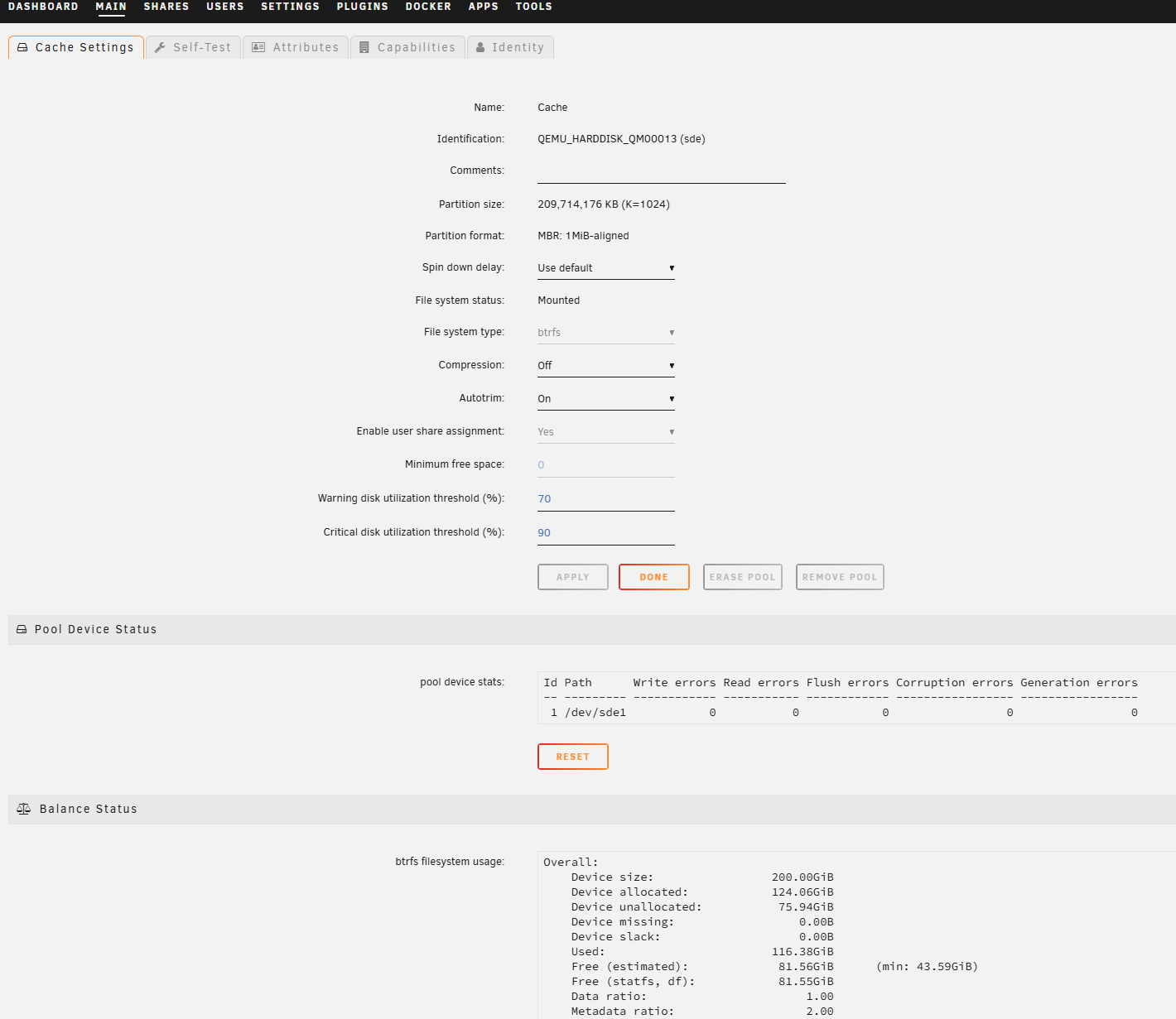

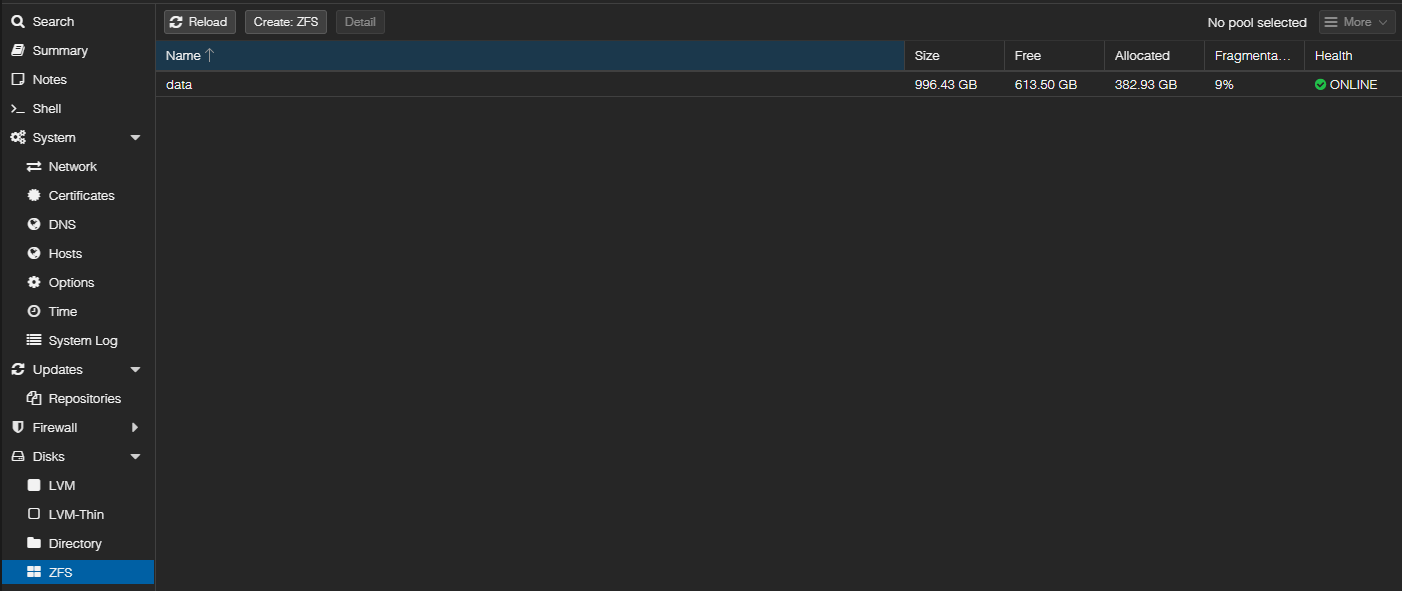

If you want a 5 GB cach disk... as I went beta and ditched the array for a zfs pool only, This is more for a btrfs partition for unraid swap plugin...
Otherwise, hit the trashcan, no disk... as HBA will be added for them...

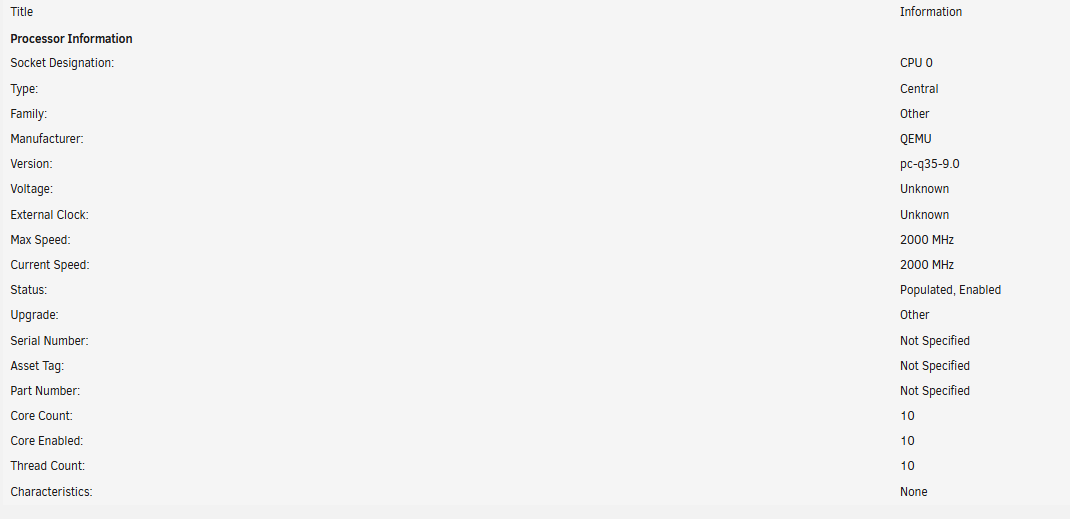

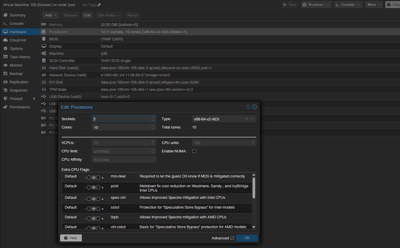

Set # of cores you want it to run... (We will be changing some of the these setting in the vm###.conf)
*Recommend to use type host and set flag based on host intel/amd for microcode...
Give Unraid ram Min 8GB NOT BALLOONING RAM! unraid existing in the ram...
It is recommended to use a virtual model nic such as the intel E1000

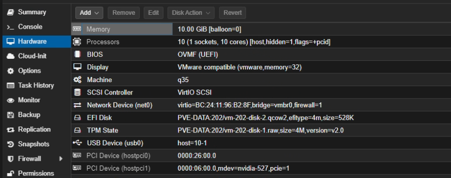

We should now have a VM to add devices too and then edit the conf manual to give it a better system run...

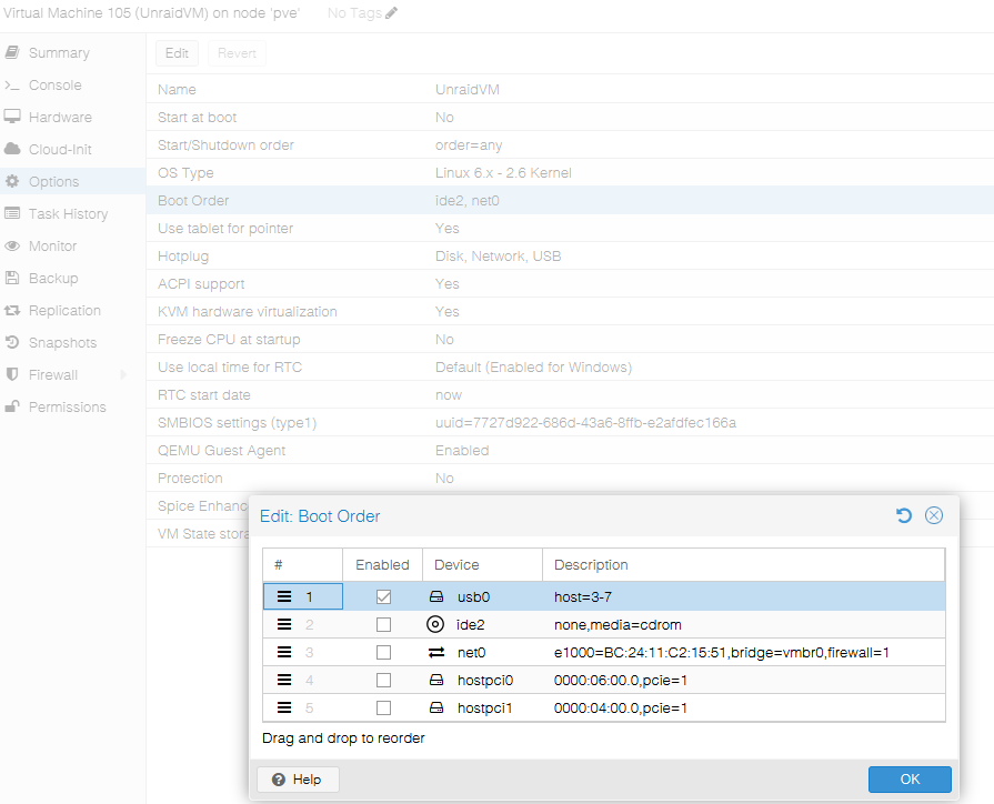

Next let's add the USB Unraid boot disk:
image.png.2c39f04107b1c4cb2ad1d191009bb14d.png image.png.f764f1b53bf013bf3d55e1f8ed210b32.png
*Pass the USB via passing the entire port!
Next lets add the HBA
My HBA register as 2 separate devices under the same VFIO PCID. YOU MUST PASS BOTH IN IRQ ORDER!
We are now ready to edit the config manually
Locate the VM Configuration File
VM exist here: /etc/pve/qemu-server/
cd /etc/pve/qemu-server/
ls to see all of your PVE VM data templates...
in our case our ID is 105 so we will edit 105.conf
nano /etc/pve/qemu-server/105.conf
We need to fix some things...
1 add args. If your AMD:
args: -device amd-iommu
This allows Immu for VM in unraid...
If intel use
args: -device intel-iommu
next we need to change the cpu: option...
cpu: x86-64-v2-AES
to:
cpu: host,hidden=1,flags=+pcid
*its recommend to run hidden like windows as this hides that kvm is running and can help with pcie device passthough and help stop code 43 errors...
Save and exit. You now have a good to go Unraid VM:
Last, we set unriad USB to boot first.
*If unraid won't boot with UEFI edit and use sea bios...

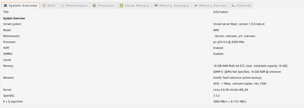

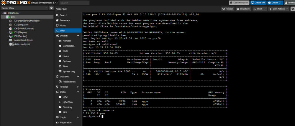

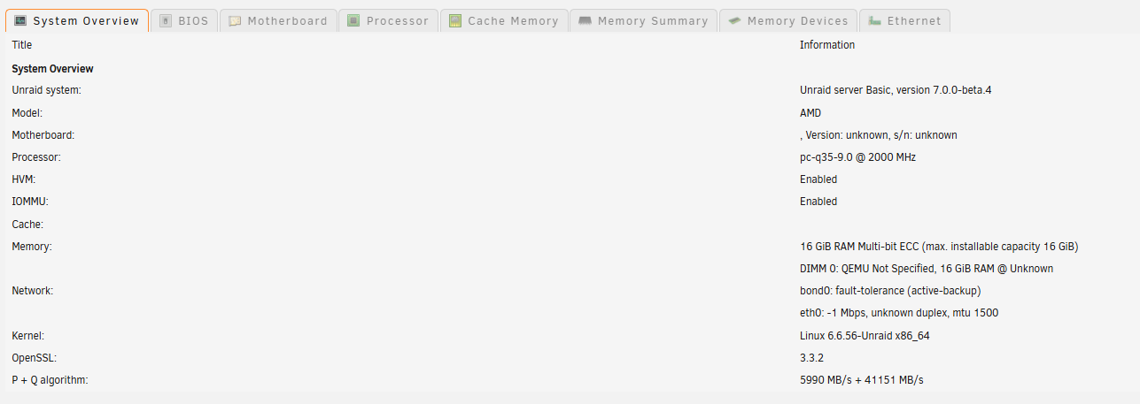

*I have this working with stable 6.12.13 and beta 7 v4  Unraid v7 rc.1

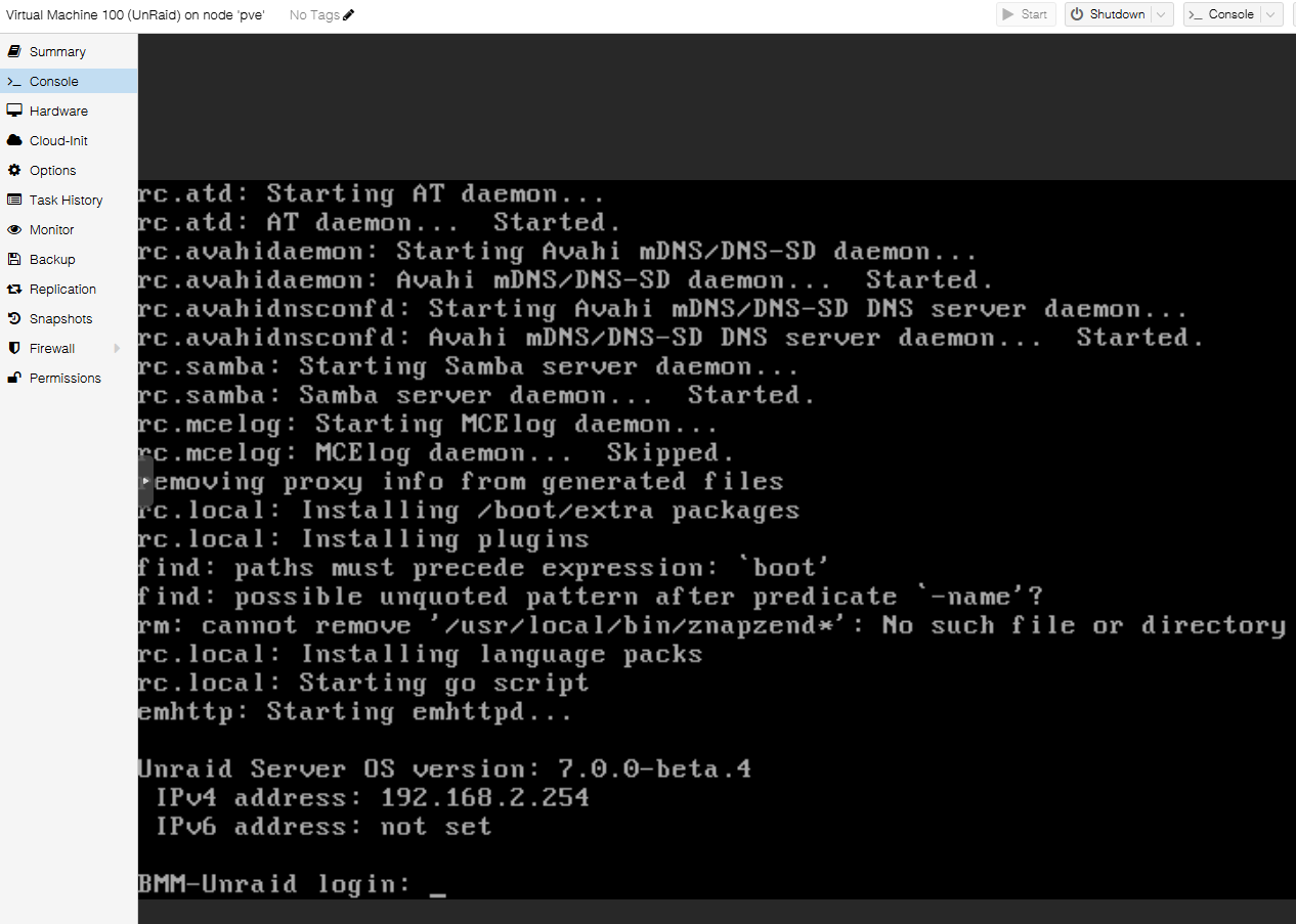

With that, we should now see a console and the ability to boot into Unriad:
Example of my experimental Test machine for unraid

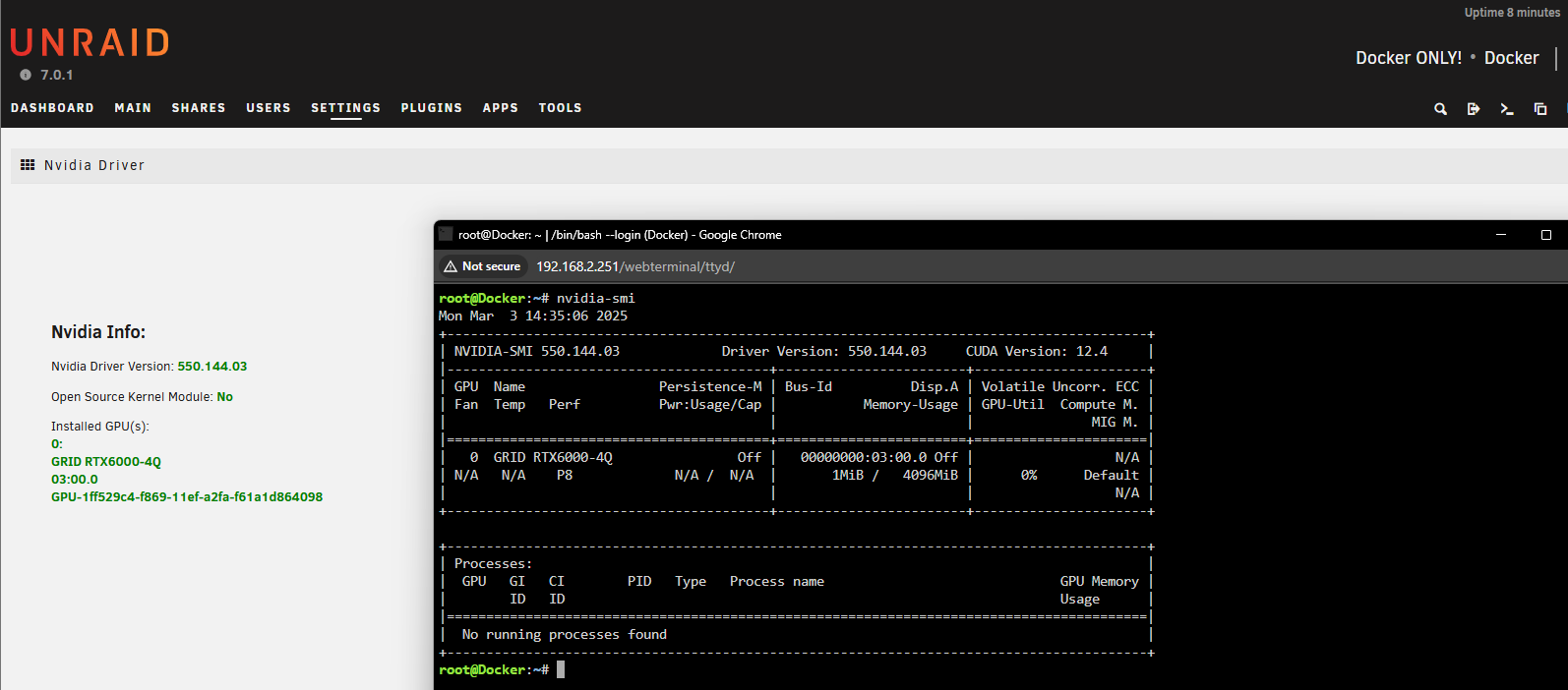

so lets load the Web UI and make some key changes to help fix some small things...
Change 1 since this is beta 7... I use some user script to fix some things here and there...
Some are nice, but all are optional...

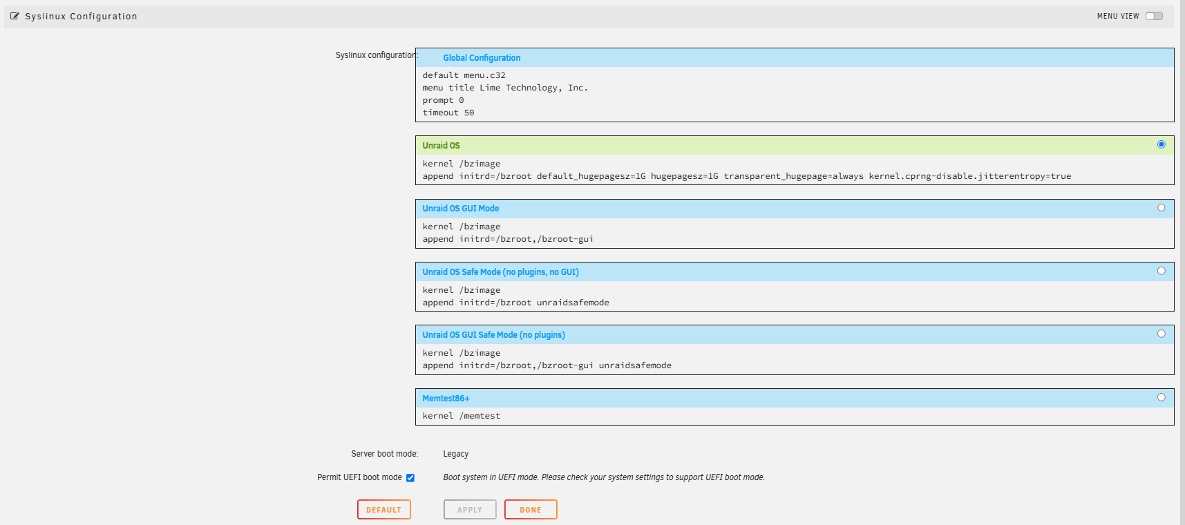

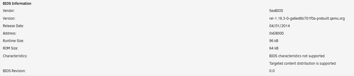

What's required... Well, in my case q35 sea bios has a known error noted in the bugs. So q35 uefi doesn't have/show this, and some older and operon had these issues. Kernel 6... so let's disable that feature...
Web UI > Main > Syslinux Configuration:
kernel /bzimage
append initrd=/bzroot default_hugepagesz=1G hugepagesz=1G transparent_hugepage=always kernel.cprng-disable.jitterentropy=true
*other syslinux command line posted later... to help vm guest os...

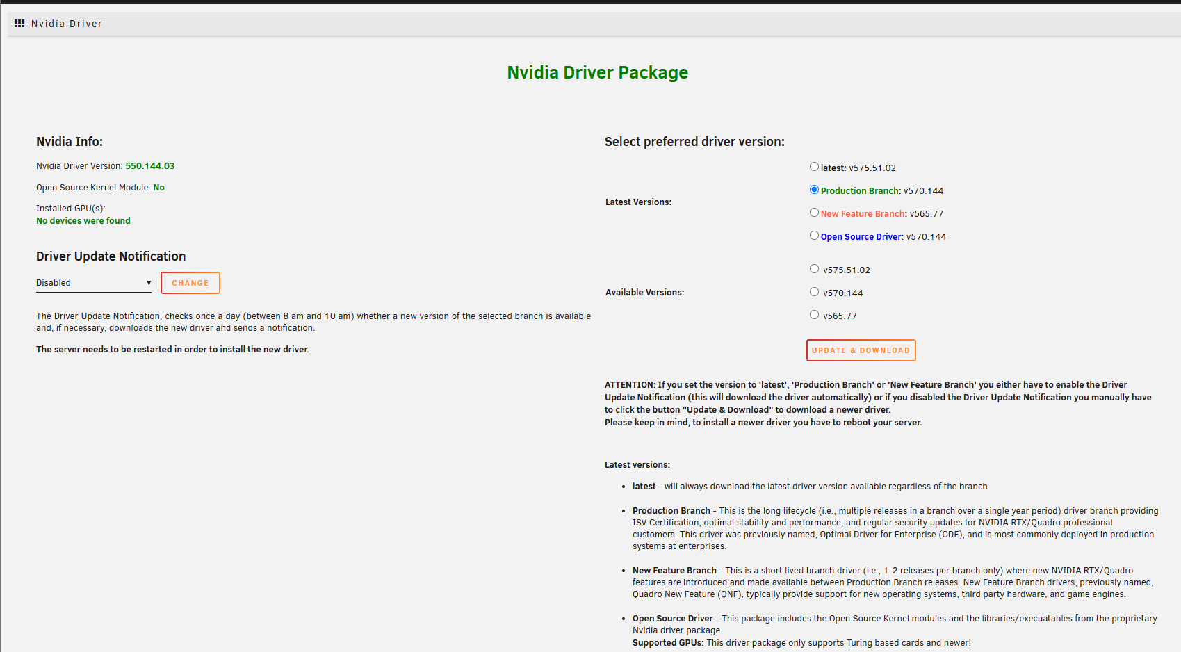

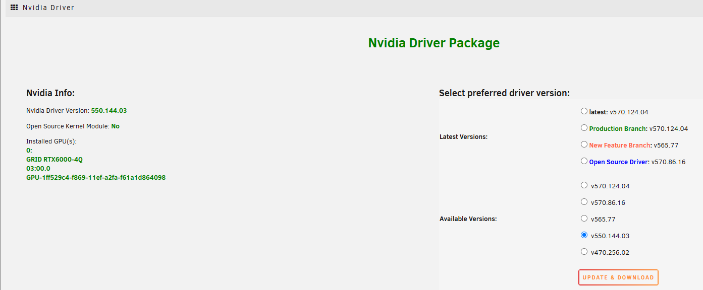

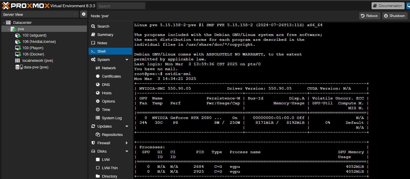

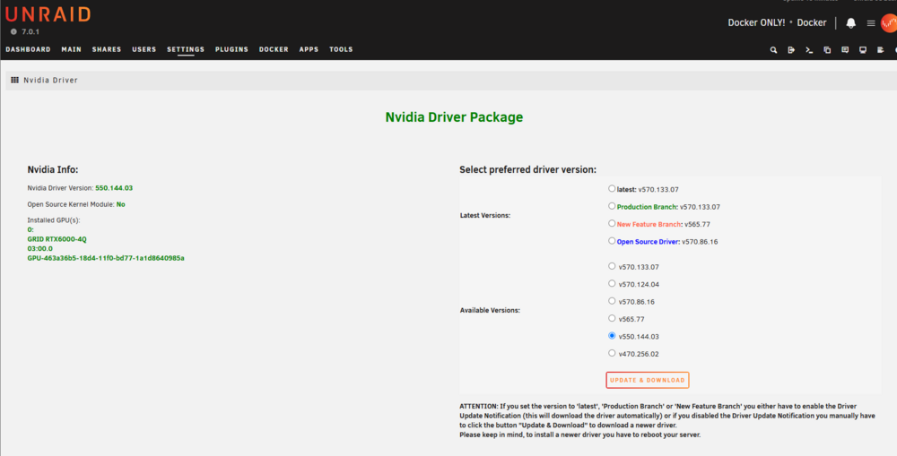

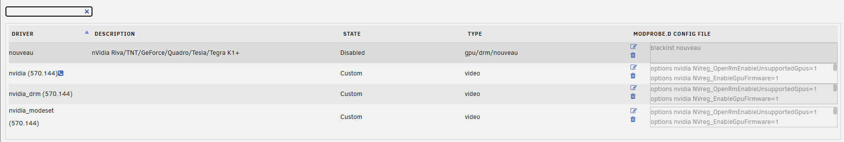

But wait there more. I'm using VGPU what about the Nvidia Driver to use the device?
Let take a look:

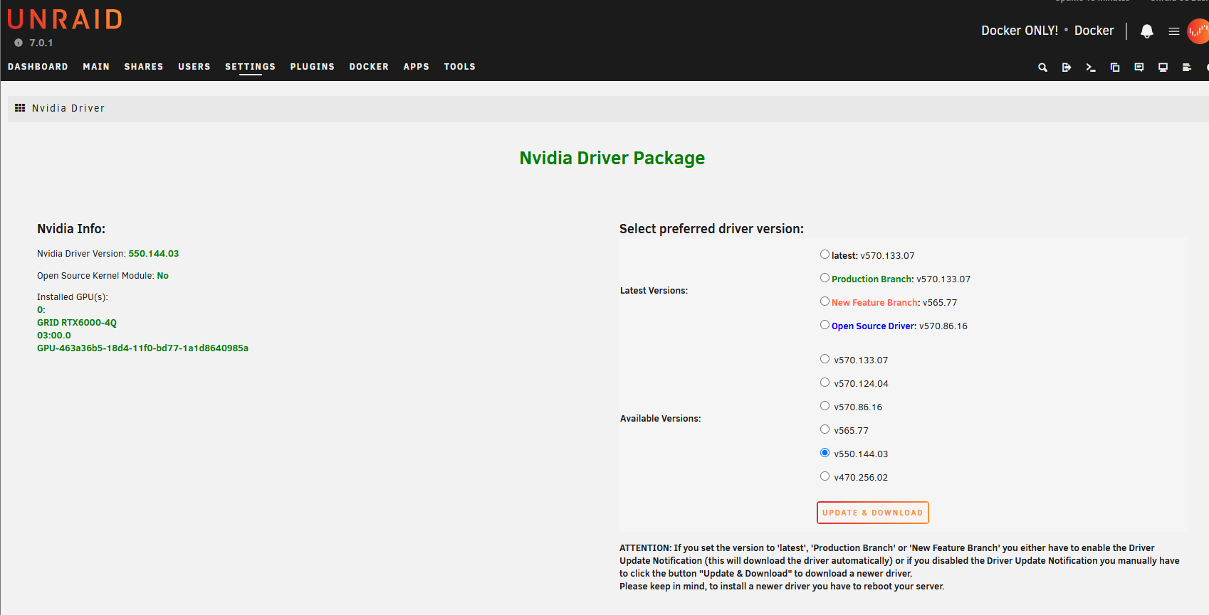

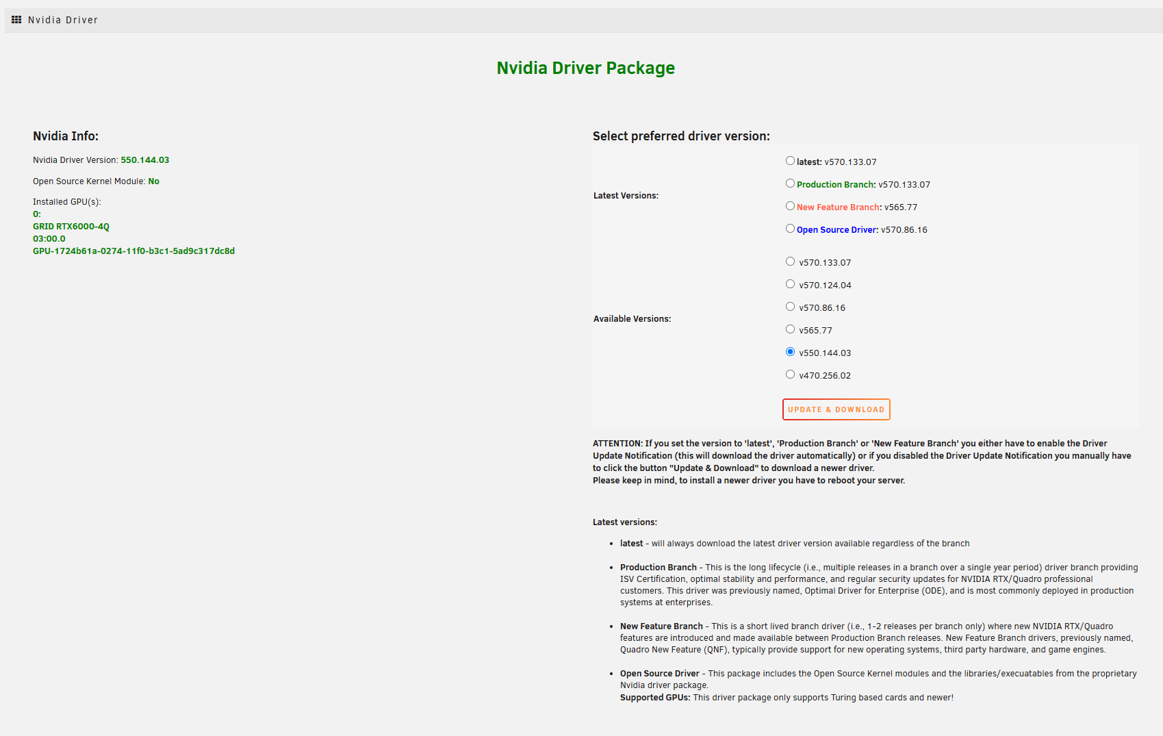

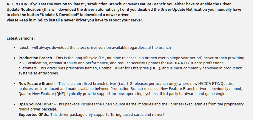

We will need to use the Nvdia plugin thanks to ICH777. Sadly, the plugin will work only for standard NVIDIA graphics cards and works very well!
Step 1
lspci to see if you see your g card
Install the open source Driver: update and download.
Open Source Driver - This package includes the Open Source Kernel modules and the libraries/executables from the proprietary Nvidia driver package.
Supported GPUs: This driver packages only supports Turing based cards and newer!
ATTENTION: If you want to use the Open Source driver with GeForce and/or Workstation cards you have to create the file "/boot/config/modprobe.d/nvidia.conf" on your USB boot device with the contents, before you reboot your server:

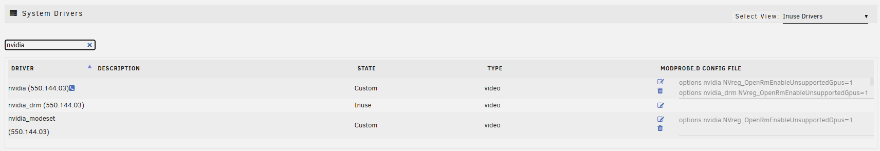

options nvidia NVreg_OpenRmEnableUnsupportedGpus=1
follow the instructions... we need that modprobe options...
nano /boot/config/modprobe.d/nvidia.conf
then reboot the unraid machine. This wil install the open Source driver.
with unraid fully booted. go to the nvidia plugin (as we mainly wanted the modprobe....and some libs from open source...) click
If using pascal vgpu like a tesla p4 this works with: image.png.1b1527b65b3eab2b86bc948df92a207f.png
and update & Download...
Then reboot, you will now have a working NVIDIA VGPU driver running for bare min stuff like plex transcoding...
Nvidia has removed and is removing support for pascal drivers... If doing VGPU its best to use a turning card...

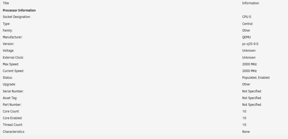

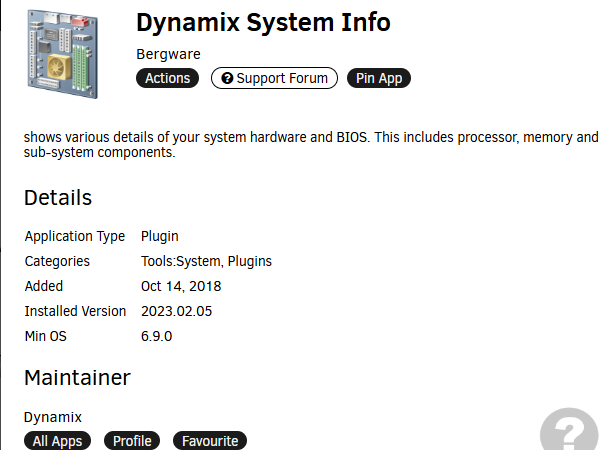

So why won't the dev support this. Well that because Unraid and Slackware have additional requirements that a virtualized environment needs... everything above while it has been stable for me may not for you. Let's take a look at some things...
Let's install the Dynamix System Info plugin and take a look around...
Tools> System Profiler
Bios:
Motherboard:
Processor
Cache Memory
Memory Summary
Memory Devices
Ethernet

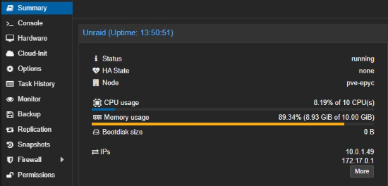

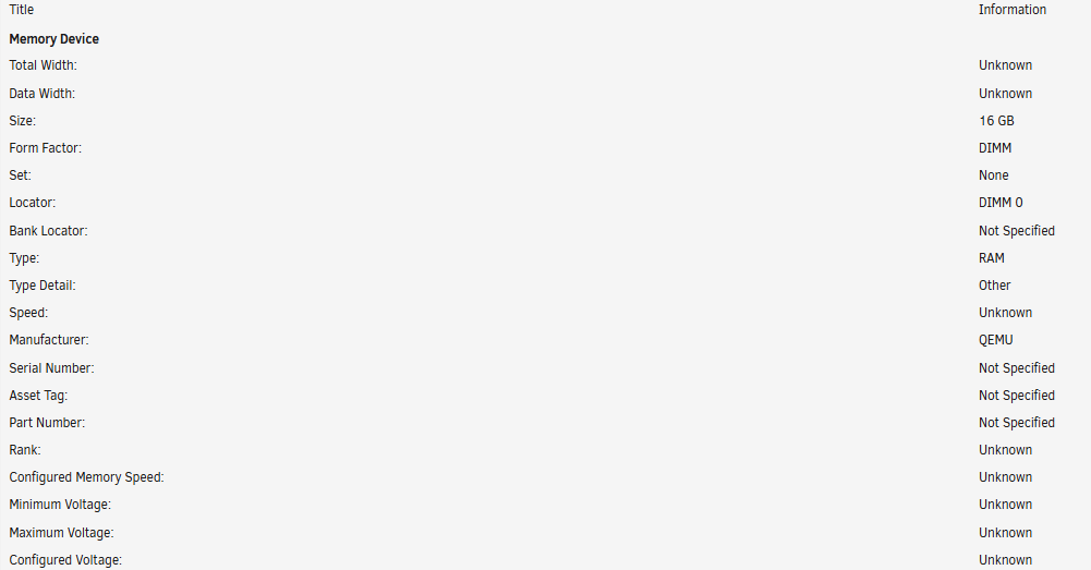

As you can see...
The Virtualized instance that is this Unraid is missing data for what its Motherboard is...Ram shows up as 1 dim... and other data is missing...
Some CPU data and information, so I'm processor locked in to using 2.0 GHZ
(This is what proxmox reports to the VM as a static Value review Proxmox Summary of the VM and see the full threads/cores that are being used in load balancing...) So When I have a AMD 2.5 GHZ / overclocking... I'm still getting my performance (there is some loss being nested...)
Its For This reason That YOU SHOULD NOT Virtualize UNRAID, and if it is virtualized it will be unsupported! Do so at your own risk!
Then you w will then be playing the virtualized bare metal game and workaround game...
That said there are some benefits to virtualization...
Mainly in backups, depending on how you handle disk.
Another example is to run truenas scale for nfs/samba and full zfs implementation, then run a  VM virtualize a single cached disk and pass the unraid USB to make a single cache btrfs vdisk in truenas and use unraid for dockers only....

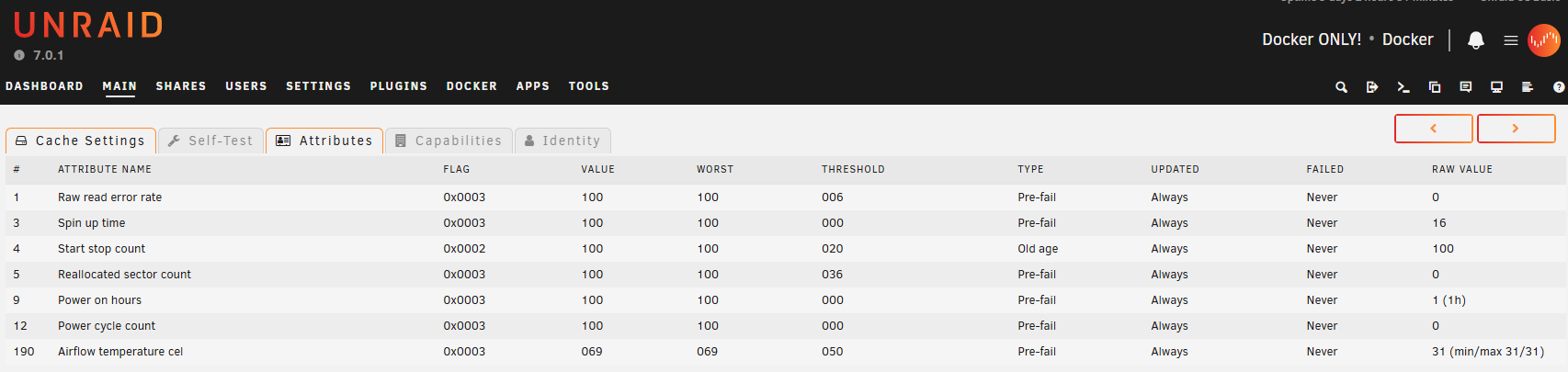

I have been passing disks with no problems, sure I have to deal with smartctl and spindown on the Proxmoxhost. I am now SSD-only, but when I used spinning rust, I simply ran a ”hdparm -S60 /dev/disk/by-id/YOUR-PASSEDTHROGH-DISK-HERE” on Proxmox startup to make the passed disk spin down after 5 min. Worked like a charm
Edited by BarbaGrump
On 11/15/2024 at 11:09 AM, BarbaGrump said:
First: great write-up!
Glad this is helping people. I didn't realize there was a separate forum location when i originally made the post... whoops!

Backup - This is my 100.conf I use on amd for my BMM-Unraid test Unraid instance
root@pve:/etc/pve/qemu-server# cat 100.conf
#10 cores 16 GB of Ram
#PCIE Pass through%3A
#HBA with 3x16TB disk
#-PVE grub and mod probe blacklist for disk by id. if disk ever change, update there...
#-USB pcie device for offsite backup and other docker devices.
#System is meant for Data storage and Dockers only!
agent: 1
balloon: 0
boot: order=usb0
cores: 10
cpu: host,hidden=1,flags=+md-clear;+ibpb;+virt-ssbd;+amd-ssbd;+amd-no-ssb;+pdpe1gb;+aes
efidisk0: data-pve:100/vm-100-disk-1.qcow2,efitype=4m,pre-enrolled-keys=1,size=528K
hostpci0: 0000:04:00,pcie=1
hostpci1: 0000:06:00,pcie=1
hostpci2: 0000:0e:00,pcie=1
hostpci3: 0000:01:00.0,mdev=nvidia-259,pcie=1
hotplug: network
machine: q35
memory: 16384
meta: creation-qemu=9.0.2,ctime=1727936737
net0: virtio=BC:24:11:A1:95:73,bridge=vmbr0,firewall=1
numa: 0
onboot: 1
ostype: l26
scsi0: data-pve:100/vm-100-disk-2.qcow2,backup=0,iothread=1,size=5G,ssd=1
scsihw: virtio-scsi-single
smbios1: uuid=51090d87-06eb-40b1-84c4-604c0bb7594b
sockets: 1
tpmstate0: data-pve:100/vm-100-disk-0.raw,size=4M,version=v2.0
usb0: host=3-7
vmgenid: b5a6e175-eb0d-41ac-9180-232addccaad3
* Note the CPU Line. This is for AMD Proxmox fixed most of the setting flags in the
*Depends on your CPU and unraid syslog... with v7rc1 i need to add flags for amd to report that mitigation are in affect...
So I added extra flags depending on your host processor. Proxmox has introduced virtual iommu. I rather deal with bare-metal iommu...
If you trust the host proxmox, you can use plugin on Unraid and disable mitigation as well...
example in logs:
Dec 3 21:48:36 BMM-Unraid kernel: Speculative Return Stack Overflow: IBPB-extending microcode not applied! Dec 3 21:48:36 BMM-Unraid kernel: Speculative Return Stack Overflow: WARNING: See https://kernel.org/doc/html/latest/admin-guide/hw-vuln/srso.html for mitigation options. Dec 3 21:48:36 BMM-Unraid kernel: Speculative Return Stack Overflow: Vulnerable: Safe RET, no microcode
as a VM mitigation may not apply...
also a updated unraid syslinux/grub command line:
Command line: BOOT_IMAGE=/bzimage initrd=/bzroot default_hugepagesz=1G hugepagesz=1G transparent_hugepage=always kernel.cprng-disable.jitterentropy=true acpi=force pci=nocrs amd_iommu=on iommu=pt mitigations=auto noapic
*To help with Host VM integrations.
Explanation of Each Parameter
default_hugepagesz=1G and hugepagesz=1G:
Optimizes memory usage for high-performance workloads by enabling 1GB huge pages.
transparent_hugepage=always:
Ensures huge pages are used wherever possible to improve memory performance.
kernel.cprng-disable.jitterentropy=true:
Disables jitter entropy for better performance on virtualized environments.
acpi=force:
Forces ACPI to enable power and system management on virtualized environments.
pci=nocrs:
Avoids conflicts with PCI resource allocation reported by ACPI.
amd_iommu=on:
Enables AMD IOMMU for PCI passthrough and device isolation.
iommu=pt:
Sets IOMMU in passthrough mode for improved performance on virtualized environments.
mitigations=auto:
Automatically enables all available CPU mitigations for vulnerabilities like Spectre and Meltdown.
noapic:
Disables Advanced Programmable Interrupt Controller (APIC) for improved stability in certain virtualized setups.
With testing this I have had a uptime of more then 2 month on v7 beta 4 now testing with v7 rc 1 as things seem to be working great with hardly any noticeable issues that I can find atm.

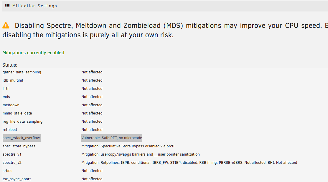

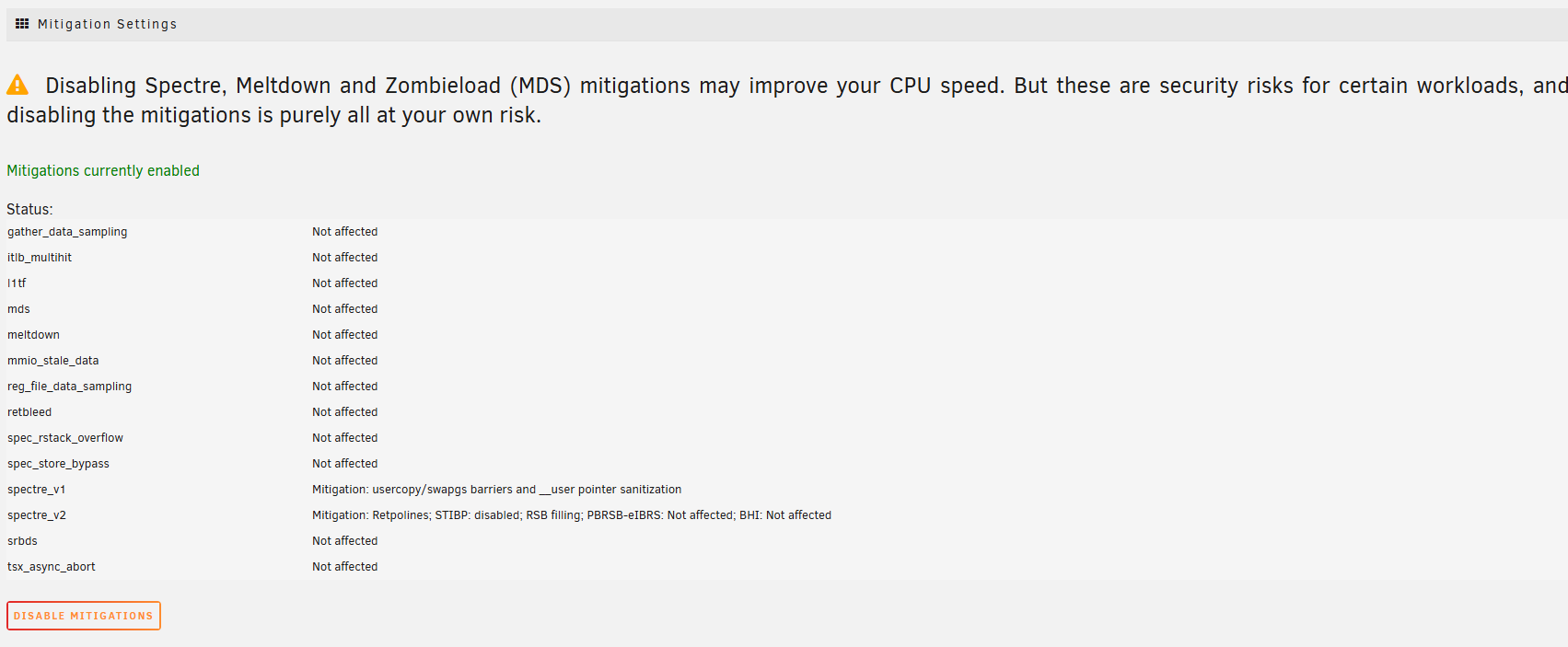

I recmoend installing the disable mitigation pluign.
this is more to check that vm microcode is not vunlerale...
as syslog noted a potential VM issue. this us usaly affect on how proxmox calls the cpu type. I prefer to call host and flags my CPU support...

Here is my stable release of v7 VM syslinux grub...
My AMD current recomendation for unraid syslinux grub is:
append initrd=/bzroot mitigations=auto noapic default_hugepagesz=1G hugepagesz=1G transparent_hugepage=always kernel.cprng-disable.jitterentropy=true acpi=force pci=nocrs spec_store_bypass_disable=on spectre_v2=on pti=on
Other options explained above...

more to assist and help with nested virtualization
sylog error:
Jan 13 17:39:29 BMM-Unraid kernel: Speculative Return Stack Overflow: IBPB-extending microcode not applied!
Jan 13 17:39:29 BMM-Unraid kernel: Speculative Return Stack Overflow: WARNING: See https://kernel.org/doc/html/latest/admin-guide/hw-vuln/srso.html for mitigation options.
Jan 13 17:39:29 BMM-Unraid kernel: Speculative Return Stack Overflow: Vulnerable: Safe RET, no microcode
earlier beta images loaded and protected against this. may be a kernel issue.
as for AMD,
The error messages you're seeing indicate that the Speculative Return Stack Overflow (SRSO) vulnerability cannot be fully mitigated without applying a microcode update from your CPU vendor. Unfortunately, without the necessary microcode update, you won't be able to fully address this vulnerability
thats more a qemu/vm/promox thing to add, but you could refer and add adition microcodes... via:
initrd=/bzroot,/boot/microcode/your_microcode_file
^ Advanced high level kernal and linux knowlodge needed... as you can break things doing this... install 3rdparty slackware microcode and use command at your own risk!
Since Unraid doesn't natively support package managers or tools like intel-microcode or amd64-microcode, you'll need to manually apply the microcode.
so agian grub commands:
Mitigation Options Without Microcode
mitigations=auto,nosmt spec_rstack_overflow=off
mitigations=auto,nosmt: Enables most mitigations but disables simultaneous multithreading (SMT/hyper-threading), which can reduce exposure to speculative execution vulnerabilities.
spec_rstack_overflow=off: Explicitly disables the SRSO mitigation check (this is a workaround, not a fix).
you can always verify your mitigation is the systemlog:
cat /sys/devices/system/cpu/vulnerabilities/*
dmesg | grep -i spec
More of a FYI... otherwise you will need to move off cpu host inthe vm config to a cpu that loads with unraids microcode.

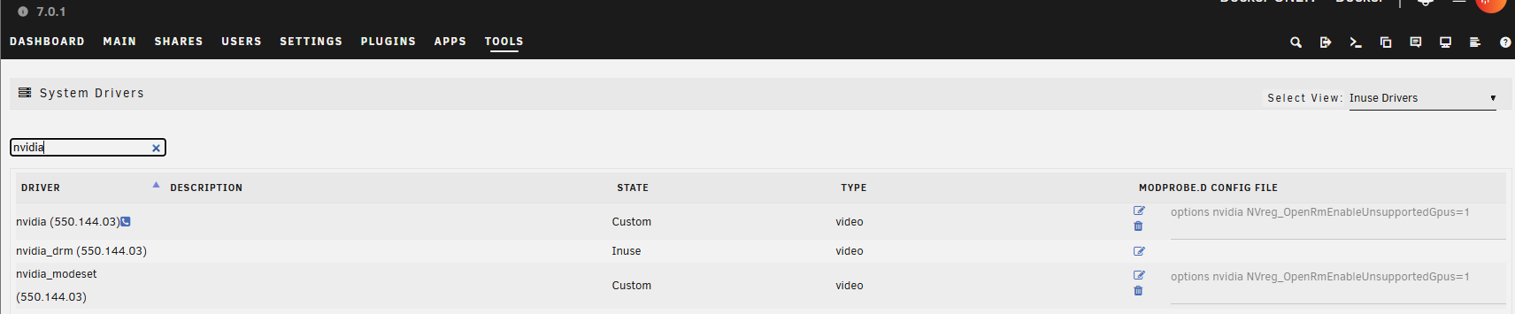

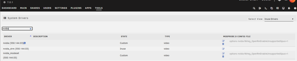

with unraid v7.0.1 vgpu broke... to fix it I had to readd the unsupported to another modprobe module:
and add an additional syslinux grub line. v7.0.1 I don't see any kernel level error...
kernel /bzimage
append initrd=/bzroot mitigations=auto,nosmt spec_rstack_overflow=off noapic default_hugepagesz=1G hugepagesz=1G transparent_hugepage=always kernel.cprng-disable.jitterentropy=true acpi=force acpi_osi=Linux pci=nocrs spec_store_bypass_disable=on spectre_v2=on pti=on irqpoll usbcore.autosuspend=-1 nvidia.NVreg_OpenRmEnableUnsupportedGpus=1
to make sure the vgpu grid driver loaded I added:
I also had to drop form the production branch back to the v550:
but proxmox vgpu is working as it should and is being detected...
Using polo vgpu unlock.
Thought I'd update
as I again had to install the opensource driver first. add the additional gub command. and add the otehr nvida_modset option for unsupported GPU...
Updating and sharing the test system and how as things progress.

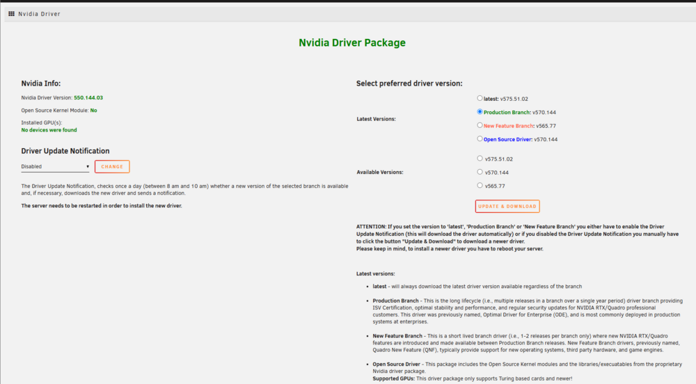

PVE updated to 8.4 Unraid updated to 7.1.0RC1 There is a problem that the nvidia driver cannot be installed and the nvidia driver plugin does not have the 550 version anymore The open source driver of the RC version does not seem to support VGPU
I have not tested and moved off 8.3 .. I also have the older kernel 5.15 something... I still on debian bookworm for security updates and see no reason to move off 8.3 if things are stable and working... no Known CVEs...
Unriad Nvidia plugin via ICH777 will have a deprecated driver:
Ask nvidia plugin support for a older version...
I'd recommend sting on v7.0.1 Stable release, the beta has alot going on with it and I don't feel like trying to fix beta nonsense that may or may not be there in the end for stable release. As I experience with running the v7 beta to current stable release...
Its also why the topic is "experimental" as I use advance linux stuff and knowledge to accomplish things. Sometimes outside the norm. Theses are more guidelines on how one can make it stable.
your issue appears to be more related to unriad, VGPU or ich777 nviida driver plugin...

General nvdia gpu things to try and test with unraid v7
Depending on your CPU QEMU model (this is why I orginaly used host above...)
https://qemu-project.gitlab.io/qemu/system/qemu-cpu-models.html
Also as said earlier as well. ICH777 has done a great job with the nvidia plugin. Many Thank to ICH777
You may be experiencing a nvidia out of support error with the nvidia driver install plugin
(I did at one time that why I posted about it here earlier in the forum...)
Please note that post pictures... note the system drivers... I bet if you try to search nvidia it will not show up... and may appear blank... this is a sign that unraid slackware linux didn't install or detect the nvidia gpu correctly... To not break the driver install and to keep unraid running the pluigin din't move forward with installing...
so I decided to update to the next build in proxmox... i'm onw on pve 8.4.1.... update went without a htich... no issues with any previous configurations....
so, @121644 you are most likely seeing something like this:
as an example in system log:
(as I changed my cpu to fix other things on my test server....)
Apr 13 20:26:01 Docker kernel: nvidia-nvlink: Nvlink Core is being initialized, major device number 240 Apr 13 20:26:01 Docker kernel: Apr 13 20:26:01 Docker kernel: nvidia 0000:03:00.0: vgaarb: VGA decodes changed: olddecodes=none,decodes=none:owns=none Apr 13 20:26:01 Docker kernel: NVRM: The NVIDIA GPU 0000:03:00.0 (PCI ID: 10de:1e30) Apr 13 20:26:01 Docker kernel: NVRM: installed in this system is not supported by the Apr 13 20:26:01 Docker kernel: NVRM: NVIDIA 550.144.03 driver release. Apr 13 20:26:01 Docker kernel: NVRM: Please see 'Appendix A - Supported NVIDIA GPU Products' Apr 13 20:26:01 Docker kernel: NVRM: in this release's README, available on the operating system Apr 13 20:26:01 Docker kernel: NVRM: specific graphics driver download page at www.nvidia.com. Apr 13 20:26:01 Docker kernel: nvidia: probe of 0000:03:00.0 failed with error -1 Apr 13 20:26:01 Docker kernel: NVRM: The NVIDIA probe routine failed for 1 device(s). Apr 13 20:26:01 Docker kernel: NVRM: None of the NVIDIA devices were initialized. Apr 13 20:26:01 Docker kernel: nvidia-nvlink: Unregistered Nvlink Core, major device number 240 Apr 13 20:26:01 Docker kernel: nvidia-nvlink: Nvlink Core is being initialized, major device number 240 Apr 13 20:26:01 Docker kernel: Apr 13 20:26:01 Docker kernel: nvidia 0000:03:00.0: vgaarb: VGA decodes changed: olddecodes=none,decodes=none:owns=none Apr 13 20:26:01 Docker kernel: NVRM: The NVIDIA GPU 0000:03:00.0 (PCI ID: 10de:1e30) Apr 13 20:26:01 Docker kernel: NVRM: installed in this system is not supported by the Apr 13 20:26:01 Docker kernel: NVRM: NVIDIA 550.144.03 driver release.
all I can say is you need to work with it, play around and test and edit things and test stuff...
example of my sytem drivers with it working...
So In unriad i use the following syslinux grub boot options:
My bare min atm is
kernel /bzimage
append initrd=/bzroot mitigations=auto default_hugepagesz=1G hugepagesz=1G transparent_hugepage=always acpi=force acpi_osi=Linux usbcore.autosuspend=-1 nvidia.NVreg_OpenRmEnableUnsupportedGpus=1 nvidia_drm.NVreg_OpenRmEnableUnsupportedGpus=1 nvidia_modeset.NVreg_OpenRmEnableUnsupportedGpus=1
as I had issues at one time with the modprobe being gone and unraid not reading the modprobe configs in /boot/config/modprobe.d as sometimes they would not move into the /etc/modprobe.d folder earlier enough in the boot process...

I decide to use proxmox webui and changed off host and move to a stable qemu cpu (x86-64v2-aes)
You may need to run this command on proxmox and verify your cpu chipset instruction sets and pick a compatible CPU
grep -m1 flags /proc/cpuinfo
as seen in my proxmox configurations...
This way I can get out of unraids way of patching and applying the mitigations to the kernel at boot.
So to achieve vgpu in unraid:
*its one of the reason why I have you install the opensource driver first to get the modprobe stuff and make edits above...
test... I was able to get unriad to see and read my nvidia gpu device once more... This is also why this is experimental....
You will have mixed results... there is no one size fits all shoe option here.
since i'm running a ryzen 5700 g I decided to leave host to re-enable the mitigation for the kernel...
Even with some of the option here, some are ignored don't mean anything... but this unriad VM is also my test server.
you can try and force a modpre and unriad system driver install for
options nvidia_drm NVreg_OpenRmEnableUnsupportedGpus=1
options nvidia_modeset NVreg_OpenRmEnableUnsupportedGpus=1
as its more of getting the driver plugin to install on a unsupported device...
I use a grouping of grub boot options, system drivers, modprobe etc... and play around...
Besides this is more prof of concept... (especial when using a older EOL kernel...)

Thanks for this guide! About to upgrade my Ryzen 5600 to a 5900XT. Usually I just run Debian VMs on UnRaid (prefer docker via compose/ansible rather than UnRaids docker apps). With 16 cores/32 threads, it's time for me to go the Proxmox - UnRaid in a VM, route. I'm wondering how few cores I'll need for the UnRaid VM if I'm only using it for NAS purposes..
depends on general rule of thumb and services....
Your mileage will vary.

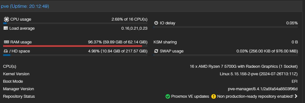

Unraid is More Ram Hungry. As  it should, given that the Entire OS runs in Ram...
While I provisioned 10 threads. Proxmox load balances them fairy well. Its ok to over provision a little bit along as not all 100% of the VM are running at full load...
I rather give something to much then deal with not enough latter.
I usually go by 1 core = 2  threads, each service requires a min of 1 core  and 1 GB of ram
my amd ryzen 5700G
runs 16 threads at: 3.8 GHZ and can hit 4.6
https://www.techpowerup.com/cpu-specs/ryzen-7-5700g.c2472
For me, My unraid is more for nas storage, plex and immich (medai/photo access).
Thus, I have to provision resources from proxmox into unraid and have unraid load balance for the 2 additional servers.
My needs required in the end (due to other testings) is 10 threads of my 16 threads total....
(as more then 4 plex users I start to see some lag and sever IO upticks...)
This is mainly Due to other factors and silicon lottery.... FBS, Memory and other factors.  as you are using a 5900XT, compared to the GHZ of the processor and the speed of the cores and its access for I/O. AS The goal is to keep IO as low as possible.
https://www.techpowerup.com/cpu-specs/ryzen-9-5900xt.c3653
If 0 running dockers(and using Proxmox for VMs). I would say a min of (4-6 threads) 2 cores is more than enough for general Unraid nas duties (samba, nfs array disk management). With a ram min 16 GB in a VM.
If using zfs like I am in the VM you may need additional ram and threads/cores to assist zfs and additional services...

so it more of noticeable slowness as you will see that from time to time you may need to increase resources as time goes on when required...
Giving proxmox cpu threads to a machine can also hit the issue of single threaded task vs muti-core task. Just because you throw more threads to the VM doesn't mean its IO and processing is lessened. There some finessing you can do both within the Unriad and on Proxmox side. Newer processor may be able to get away with fewer cores assigned. This is due to the FBS(front bus speed) on the Processor chip and is ability to move things into memory.
you could also go the other way and assign actual cores:
Similar to my windows VM:
compared to my unraid docker VM:
more info in the forum and proxmox wiki / docs as this more goes towards how you want to handle resources and load balancing...

Got around to setting this up - worked pefect on UnRaid 7.0.1 (after changing to SeaBios). Ended up with 4 cores / 8GB ram will change if required. Removed cache drive as well, since all UnRaid will be doing is storing data - will remove all docker containers and VMs from UnRaid itself. Thanks again for the guide.
unraid usb by default is not setup to use efi / uefi...
in unraid If you want to use uefi.
Main > Flash
http://192.168.2.251/Main/Flash?name=flash
scroll to the bottom:
this is due to the original machines using bios and not uefi.
uefi has some befits with pcie passthrough. there no reason to use one over the other...

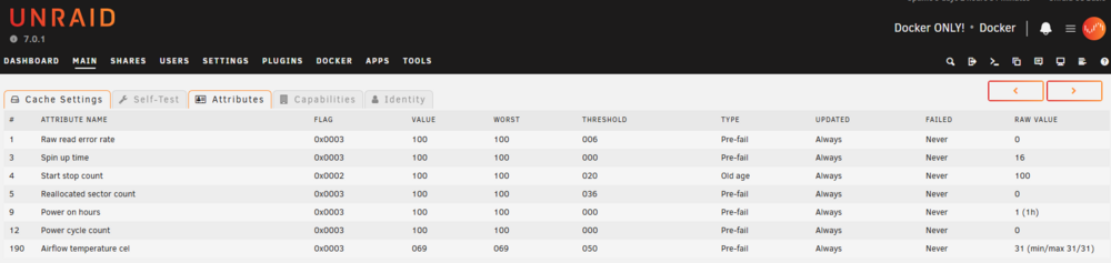

1 proxmox supports command line adding more data to a vdisk. unraid needs a restart to see the data expansion and potential use as a new format, the existing extension...
--Use proxmox disk commands sparingly let unriad control them... even a proxmox controled vdisk has some weired io and performance issues...
Also Unriad smart may flag it as old or broken... (as that what's being reported by the proxmox system to the vm.
I've been running this since the v6 to v7 beta to current v7 stable release.. I've not see or had issues using a qemu vdisk as a pool device.
-I have see issues using them as the array devices (more to do with how parity works and the writing of the 1 and 0 to a virtual disk.
Especial if the disk is set to be ballooning storage...
I recommend enabling the proxmox discard option and have it emulate as a ssd
I backup my vdisk thus the backup options...
I used a qcow as i migrated, but its better to use raw here...
If I were to recreate the disk, these are the proxmox vdisk add Hard drive options I would choose...
For me this is following the as a general rule of thumb for unraids docker system...
a 50 GB vdisk, 5 gb swap plugin, and 120 GB for general docker appdata and scratch space for unraid...

... you can even use qemu disk as metadata special disks if using unraids zfs...
If you note my signature spoiler under my post on desktop view and logged in to forum...  you can see my hardware setup, and note that my proxmox is using 2x nvme as storage and the nvem are where the vdisk sit. I can partition a part of the nvme and use them for other zfs related tasks.
--Just something to note...

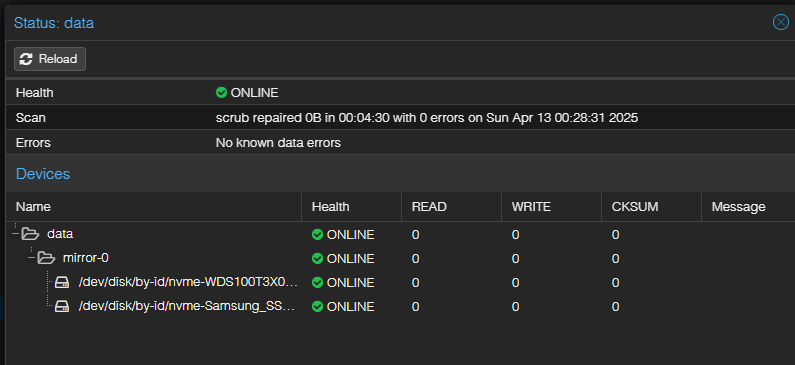

my disk when the hba passes the others to unraid..
as the 120 GB is my debain proxmoxx boot partition. and the 2 NVME are setup as a zfs mirror / stripe I don't remember need to go double check...(mirror)
been 24/7 a good 8 ish month, but having ran simlar on v6 this ha been known test good for a while... before I found the virtualized forum post for unriad...
zfs mirror to keep vms happy and redundant... ( I could got 1 nvme for vdisk storage on proxmox and pcie passed the nvme direct to unraid...)

after playing around with installing the drivers and mod probe edits. I ended on this:
and a Hard blocks with no known resolve as the latest nvidia driver no longer has the options I was using...
As I tried to explain to ICH777 before and was dismissed as I told him to go do some dam research!...
WELL fine.. decded not to even respond and left for a while after that...
AS Unfortunately, NVIDIA silently removed NVreg_OpenRmEnableUnsupportedGpus from the proprietary branch.
But here’s what can help instead...

In escense I ended up using the Production driver
(Which nvida release open-source support) and split the drive into choice installing open vs prioripertary....
so I grabbed the nvdia driver that was compiled and running on kernel so I had the libs from v6.6 added but used production driver libs for the extra install of last known working driver v550... as noted in picture above...
as I tried open source, coping it in as v565 which worked till the end due to missing kernel libs as a copy of v550 put the libs in folder kernel v6.6 and not the path others things were looking for v6.12 ...
Also heavily edited system drivers with modprobe configs...
options nvidia NVreg_EnableGpuFirmware=1
options nvidia NVreg_EnableStreamMemOPs=1
options nvidia NVreg_ResmanDebugLevel=255
options nvidia NVreg_UseVBios=0
which are also set at the grub but with other script driver calls you need both sometimes...
I can only theorize Why It Used to Work on kernel 6.6:
Unraid 6.6 + v550 let you:
Spoof the hardware ID
Inject modprobe parameters
Bypass Nouveau (which wasn't bundled)
Load driver even for vGPU-assigned devices
But now, in 6.12:
The newer kernel and firmware behavior is stricter.
vGPU guest enforcement is tighter in both open and closed drivers.
You're still running a driver (v570.144) even though you said you're loading v550 — logs show otherwise:
https://github.com/ich777/unraid-nvidia-driver/blob/d70d97fdb41de53e096e1fa9d62ff223595b275a/source/compile.sh
So don't go bothering asking on the forum about NVIDIA VGPU drivers and support.. as its get gray and borders at violates the mit NVIDIA license and limetech rules...
as we move on past unraid v71 I hope open-source access and use of vgpu get better...
I guess its too small a niche case to properly use and run on unraid...
As the VGPU system was working in v6.9 to use vgpu nvidia install on unraid...
as we lost AMD mxgpu variant which is the better course and gpu partition way.
(the only 2 cards taht support it are EOL and aren't worth the cost...)
Nvidia still trying to cleanup and remove consumer vgpu
and a open-source community working between multiple and nvida both helps and gets in the way...
So I think vgpu for homelabs consumer on the cheap will die off..
Especial since we are moving into the 5000 series cards and issues with vgpu has still not come out from the community on the 3000 cards...
Since its offical dead with the next release. Dont go asking for Unraid assistance with using VGPU past v7.0.1
Even this reliese on some legacy code that may no exisit in the furture...
Its easeier to just pass a nvdia gpu into the vm for unriad then tryign to split it...
It was fun while it lasted. time to refactor and move on.
