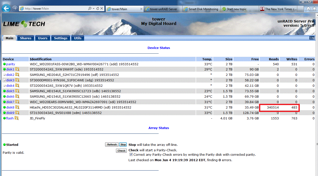

Another thing...unraid seems to be generating far too many read operations when writing the file. See the attached screenshot. There's no way unraid should generate 340k read operations when writing a 694MB file to disk. I'm certain there aren't any other clients reading/writing to unraid & there aren't any plugins running.
