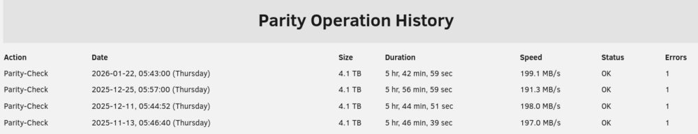

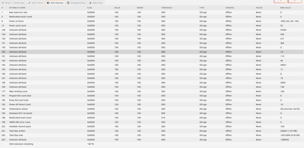

Now I think this SSD (Drive 1) is failing and am already organizing a replacement, but I'm unsure why I can't see any SMART data indicating this failiure, nor why unraid hasn't notified me of any issues other than that three parity checks over the last few months gave me one error.

Run extended SMART self-test on drive 1
I ran the Smart Test on disk 1, but no errors were found. The current layout is from before 7.x was released and I haven't gotten to change it yet
TS4TSSD230S_I062300267-20260125-0825.txt
Are there any other ways I can test wheather data has been lost?
The only errors I'm getting are the parity checks.

Jan 1 00:12:21 Tower kernel: md: recovery thread: P incorrect, sector=329581168
Jan 8 00:12:23 Tower kernel: md: recovery thread: P incorrect, sector=329581168
Jan 15 00:13:01 Tower kernel: md: recovery thread: P incorrect, sector=329581168
Jan 22 00:13:07 Tower kernel: md: recovery thread: P incorrect, sector=329581168
Jan 25 03:11:58 Tower kernel: md: recovery thread: P corrected, sector=329581168
According to diags, all previous checks were non correct, only the last one corrected the error, so now see if it shows up again.
