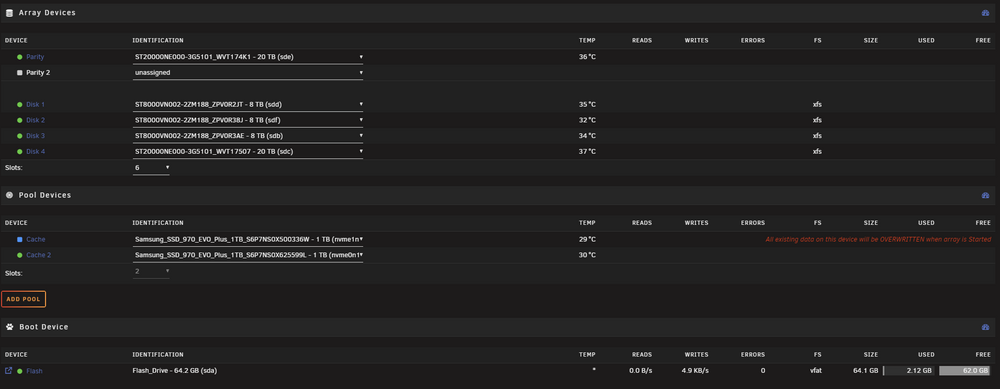

So here's what happened so far:
I was running a mirrored BTRFS pool for a while just fine, until I eventually woke up to a ton of errors being thrown by my 2nd SSD (also 2nd in the screenshot).
So I went for a reboot, at which point the 2nd SSD completely disappeared off the list of devices. At this point I assumed it might just be dead as I didn't have much time to spare when it happened - and I was fine running the server with a single cache drive, I do weekly appdata backups anyways.
I changed my pool to a single device, the SSD did its rebalancing, and everything continued to run fine ever since.
Now about a couple months later, I finally found some time to check the 2nd SSD. I took it out of the system and plugged it into my regular PC for some tests - turns out the SSD is completely fine.
I was still weirded out that my unRAID server wouldn't recognize it, even throughout further reboots throughout the last couple months, but I figured I'd just plug it back into the server again, to do some testing there, maybe it's the slot that's broken after all.
To my surprise, the SSD was recognized again. This didn't happen after previous reboots, and all I did was run some SMART tests on my PC, nothing was formatted or written to it.
Foolishly, despite having trouble before, I figured I'd add the device back to the pool.
So I changed the pool devices to 2 slots again, added the drive back into its Cache 2 slot - I was of course greeted with the regular "All existing data on this device will be OVERWRITTEN when array is Started", shown next to the 2nd SSD, which was fine, as it's the main cache drive which was holding the up to date data anyways - and started the array.
That's when I was greeted with an error. Unfortunately I can't remember which one it was, but starting the array/pool failed.
I then tried removing the second drive again, to start the pool with its singular drive.
This gave me the Wrong Pool State - cache - too many wrong or missing devices error.
I went for another reboot, thinking it would allow me to change the pool back to a single slot, but it remained set to 2 slots.
At this point I realized that my original SSD, the first one, was being recognized as a new device, while my second one wasn't.
Now the "All existing data on this device will be OVERWRITTEN when array is Started" message is showing next to my first drive - but this is of course the one with the data I want to keep.
Trying to start with just my 1st SSD keeps giving me Wrong Pool State - cache - too many wrong or missing devices - obviously as it's recognized as a new device all of a sudden.
Now I'm left in a position where I can only start with 2 devices if I erase my first drive, which I don't want to - and I can't change the pool back to a single device either.
I'm sure I messed up along the way, probably should've erased the second SSD before trying to add it back to the pool, but I thought that's what would happen either way, given the GUI message.
I'd appreciate any help at this point!

Could removing the pool to have it forget its config, and adding it back with the same name be a solution here?
Docker/VM are already disabled.
I suppose what's happening is the following. Changing my pool back to 2 devices made my 1st SSD not work anymore, since it was set up for a single device pool before.
My 2nd SSD however was still configured for a 2 device pool, hence the cache pool now detecting my 2nd SSD as the one with the correct data, and the 1st one to be erased.
Does this sound about right?
With that in mind, the solution should be adding a new pool with a singular device, my 1st SSD, which should at least give me a running system?
I'd have to make sure the new pool has the old "Cache" name, I could remove the existing one and simply recreate it with 1 slot. I'd then check if my shares still point where I want them to.

If the 2nd device is out of sync and the other one was converted to single, it would be better to reimport the pool with just that device first to see if it mounts correctly, but for that you have to disconnect the other device; you can drop it offline by typing:
echo 1 > /sys/block/nvmeXn1/device/device/remove
Reimport the pool with the remaining device, start the array, and post the diags.
To reimport the pool:
on main click on the first device for that pool and then "remove pool"
back on main, create a new pool with the same name and 1 of slot
assign the pool device, leave the filesystem set to auto
start the array to import the pool
Followed your steps - seems like we're good.
Keeping Docker/VM turned off for now but what would be the correct approach if I wanted to mirror the pool to the 2nd SSD again?
I've dropped it offline but it's otherwise untouched.
Appreciate the help so far!
davenas-diagnostics-20260128-1705.zip
Edited by xDaveN
typo
@JorgeB sorry for bothering you again, would you mind providing an answer for my question above? )
Missed your earlier reply.
If it works fine with just that device, you can disable array auto-start, reboot to bring the other device back, wipe it with
blkdiscard -f /dev/nvmeXn1
Then you can re-add it to the pool to create a mirror.
