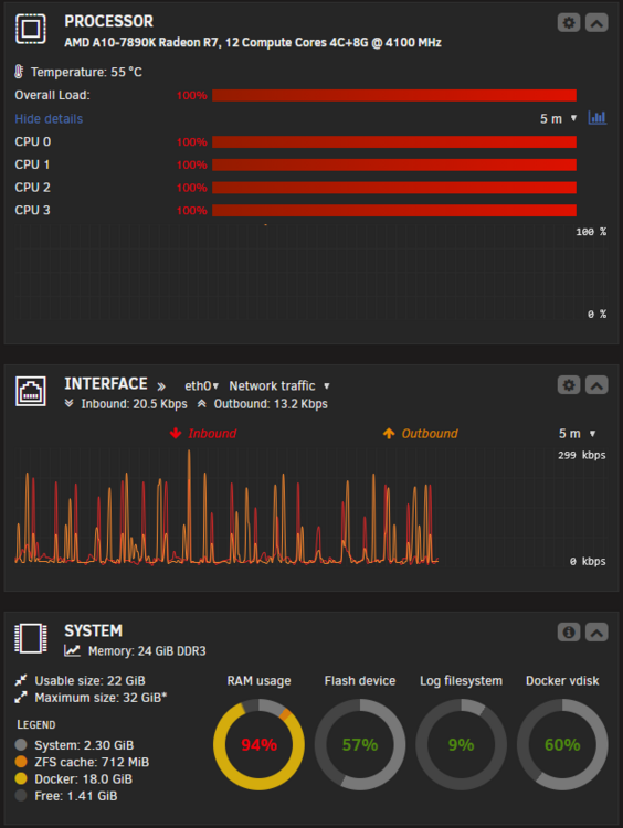

This is the second time I've realized that things aren't working correctly around the house, sat down at the computer, and discovered that the CPU is flat pinned at 100% and RAM is nearly maxed out (94% used last time, only 91% used this time).

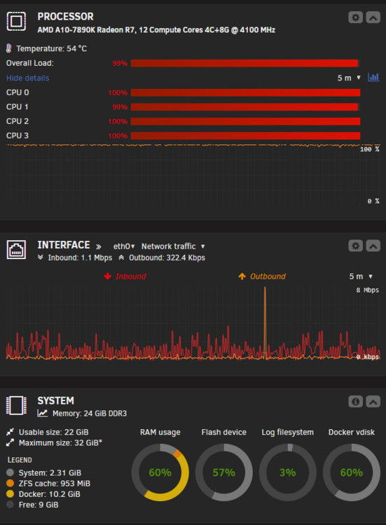

Yesterday afternoon, I came in from shoveling snow to find it was all locked up. I was able to get all my docker containers to shut down - it only took about 15 minutes for the server to respond and get them all shut down. I then restarted everything 1 by 1 and it was running fine. I came home from church today to find the same thing has happened

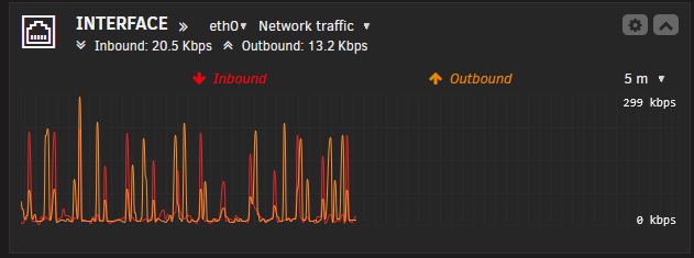

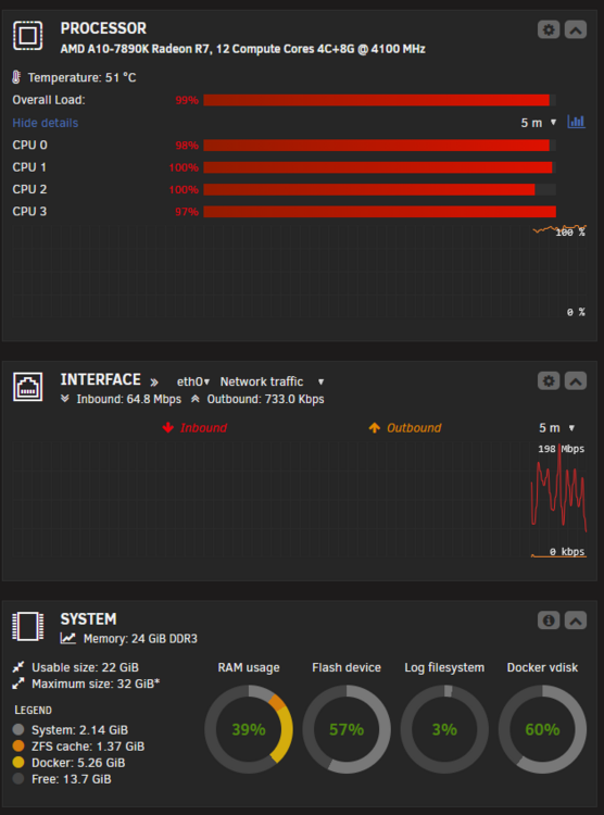

I'm also attaching 2 screen shots I took yesterday, and one today.
On the 2 from yesterday, you can see the network graph is scrolling based on the browser updating the graph, but it's not getting any new data.
On the one from today, I've added a couple of arrows pointing at tiny little spots of CPU graph where it might, possibly, have dipped below 100% utilization.

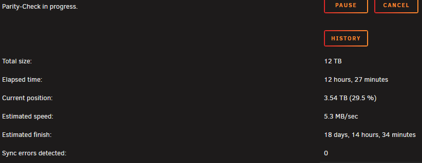

I know it's running a parity check today, but nothing has changed drive-wise in months, so that shouldn't be the cause of the issue, and it didn't start until ~1am this morning, so it couldn't have caused yesterday's lockup.

Additional update: Here's the current status of the parity check. I don't have 18 days to wait for it to finish at its current rate...
