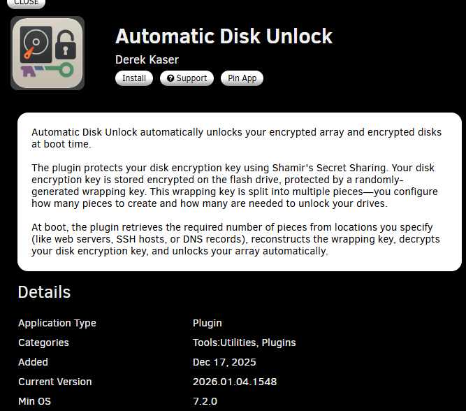

Solved by Kilrah
See this plugin
On 2/3/2026 at 8:31 PM, Kilrah said:
See this plugin
Looks like this plugin came at the right time. Thank you!
