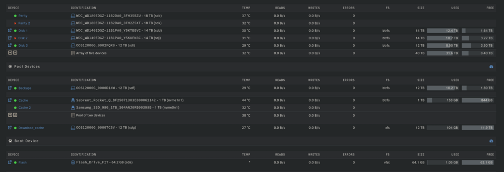

SMART for parity2 and disk2 looks OK, though neither have had recent (or any) extended self-test completed.
Can't tell anything about filesystem without the array started in Normal mode.
Do that and post new diagnostics.
Emulated disk2 is mounted so should be OK to rebuild on top.
Do any other disks show SMART warning (👎) on the DASHBOARD page?

no, all are green, except Parity 2, Disk 2, which are disabled.

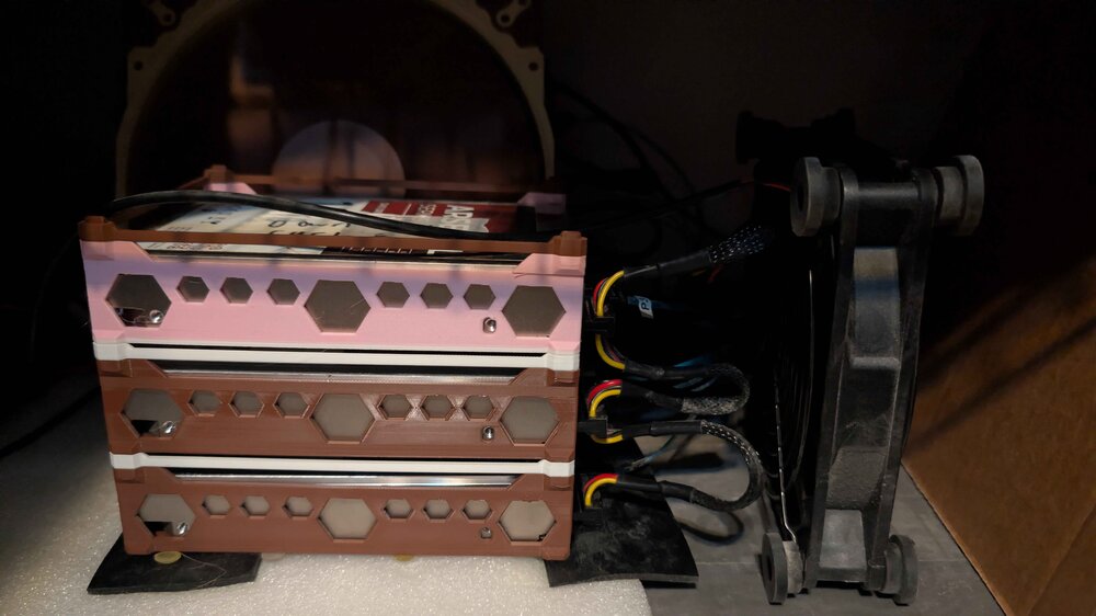

Its possible, but I've got the internal case fan, Mini Desktop, and an external Fan pointing into the system, along with fans pointing at the array itself.

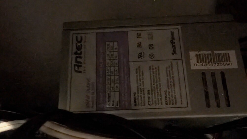

How are these disks powered? Any splitters?
Ideally, no more than 4 disks per PSU cable. MOLEX-SATA splitters are better than SATA-SATA splitters.
All cables must have enough slack so they aren't pulling on the connector. Don't bundle data cables.
An external PSU to molex -> sata power, 3 per, for a total of 6 drives. (7 now,4 on one, now that i've got an another drive precleaning, just in case)
35 minutes ago, Wurmatron said:
Mini Desktop
2 minutes ago, Wurmatron said:
external PSU
I think I'm getting the picture now.
What can you tell me about that PSU?
Antec 350w, you think its the PSU? never even considered that. Note this PSU is to power the 7 drives. (Was 6, and still had issues)

Not sure. Rebuild, parity check, turbo write (if you use that) runs all disks at the same time.
I have 7 HDD on my main server with 450W PSU
ok, its least you where able to give me a direction when I had none, others just constantly fighting issues.
May be worth me cheking the power requirements of each drive and comparing to what the PSU says it can output, and see what I have leftover.
