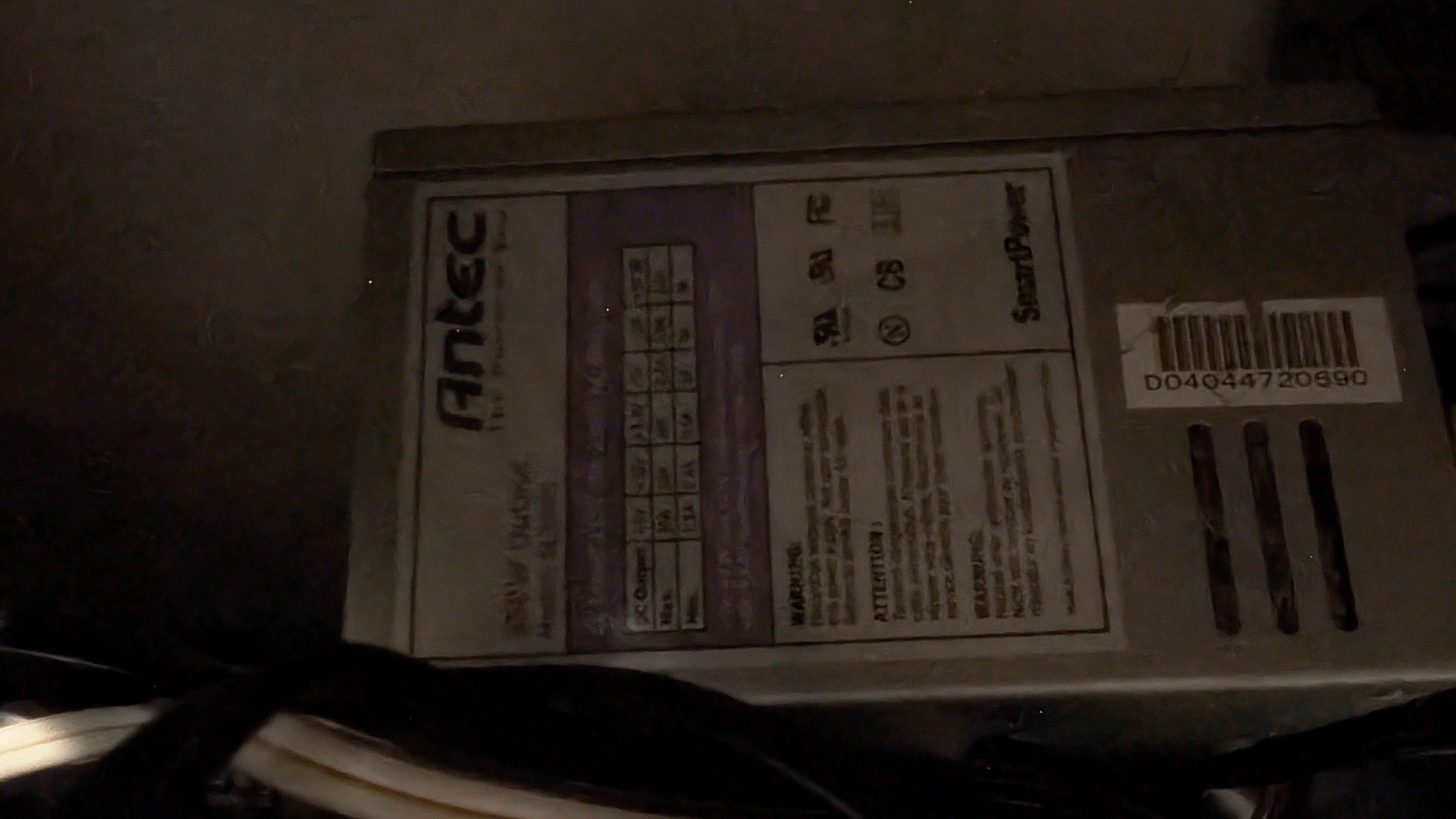

  2. Antec 350w, you think its the PSU? never even considered that. Note this PSU is to power the 7 drives. (Was 6, and still had issues)

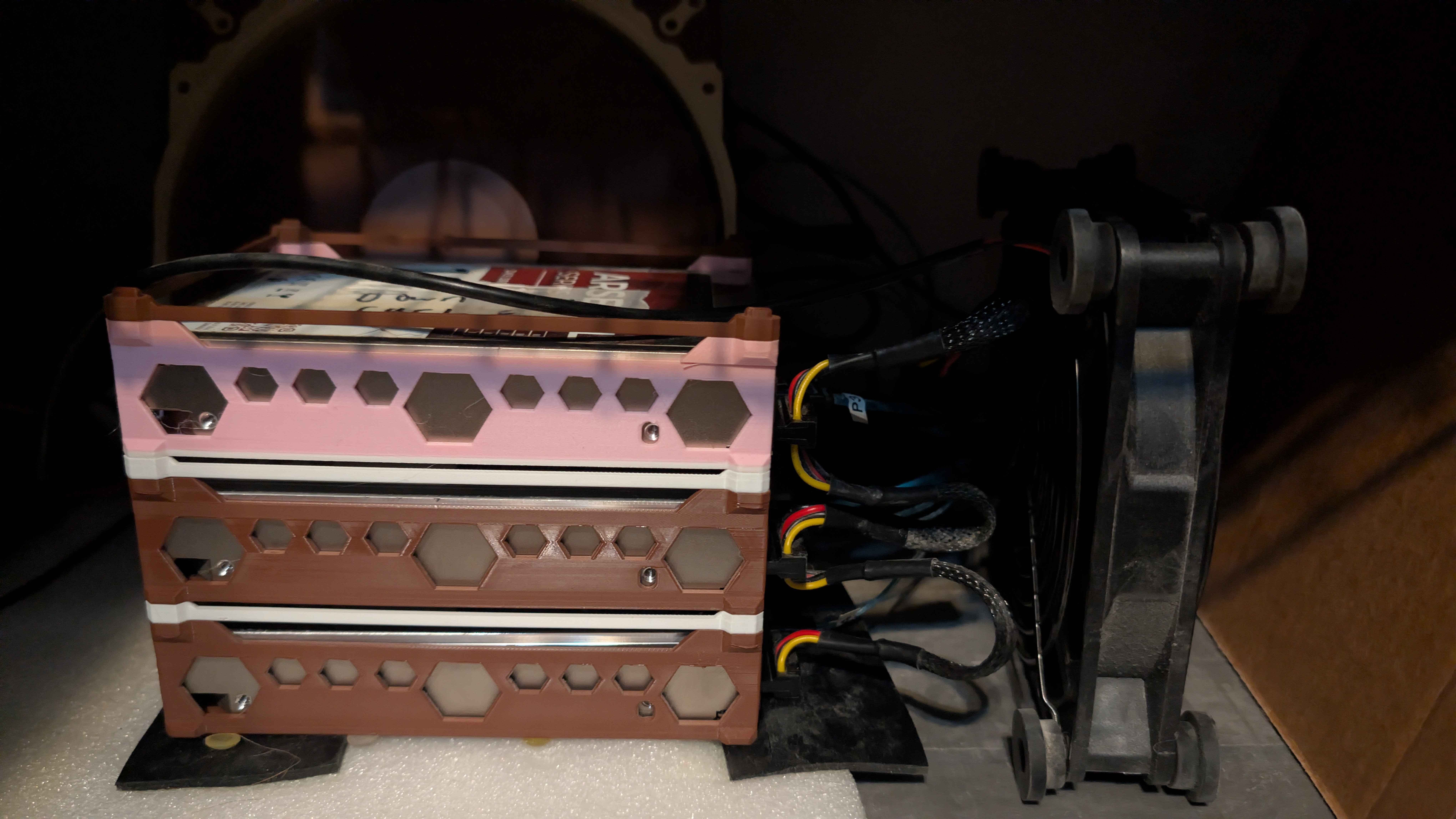

  3. An external PSU to molex -> sata power, 3 per, for a total of 6 drives. (7 now,4 on one, now that i've got an another drive precleaning, just in case)

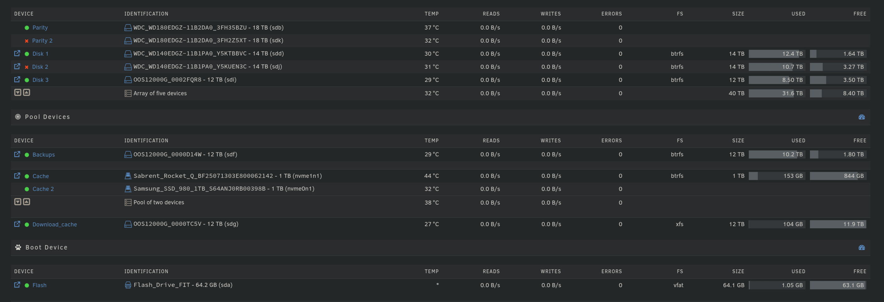

  7. no, all are green, except Parity 2, Disk 2, which are disabled. Its possible, but I've got the internal case fan, Mini Desktop, and an external Fan pointing into the system, along with fans pointing at the array itself. You think its a good idea to rebuild or should I run the extended test first.

  9. Wurmatron changed their profile photo
