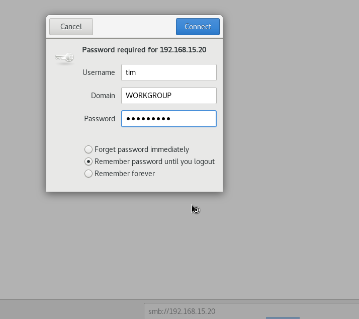

I have an Almalinux 8 VM that connects to the share in the GUI, I provide user name and password (and domain) and after completing that window, I get an error:

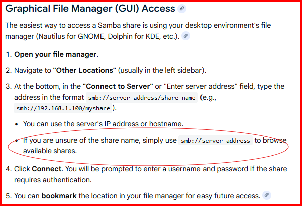

Google Gemini didn't have any new advice I had not already tried to offer....

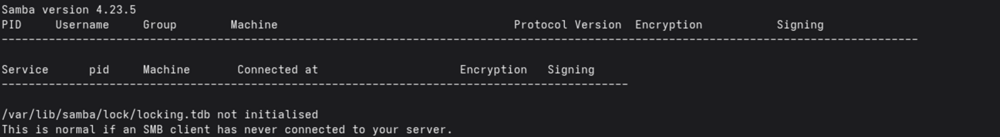

On the Fedora box, I noticed that it needed to be updated and SMB started working after the update. But I pulled the smbstatus in case there was a trend.

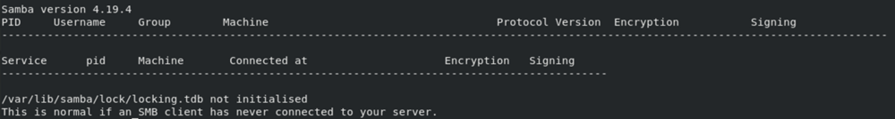

On Fedora, Samba versions is 4.23.5
On Almalinux, Samba version is 4.19.4

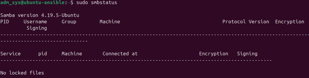

On Ubuntu (which always worked) smbstatus was not installed, but after installing it, it was 4.19.5

I also tried to just browse to the file share in Almalinux and was prompted for a username/domain and password
but still recieved and error:
I'm continuing to research this a a almalinux specific thing at this point. I tried installing Dolphin file manager and that produced different errors but did not work none the less.

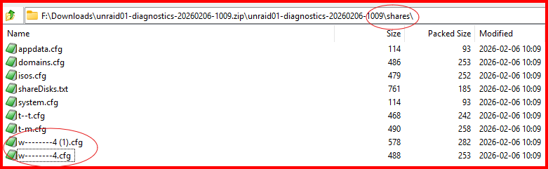

OK. Looked at the Diagnostics file and found this when looking a the 'Shares':
Now looking a the two configuration files in a test editor:
I am not sure which share you are try to access (The anonymization of the diagnostics files finds some useful info from us but I would suggest that you may have to clear up this situation.) There should be a 'CLEAN UP' button on the SHARES tab. Try that first and see what it does to resolve this situation. Each share should have a first level directory on some disk on the array of one of the cache pools.

Great catch! I'm still getting use to the nuances of the platform. I did run the cleanup task (button) and pulled diagnostics again to ensure it was cleaned up. The display did say 1 share was cleaned up.
It would have been a great story if it worked after cleaning up, but I got the same results. I was able to successfully netcat to the server on port 445 so I know its not a layer 2 problem.
