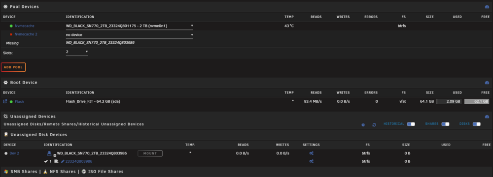

Started noticing BTRFS errors on NVME cache. drive showing as missing/unassigned.
started with a dockerimage corruption. noticed BTRFS errors on my BTRFS NVME cache pool. while the array was running it showed both as green. when i stopped the array (after moving everything off the cache to change to ZFS) it showed my second NVME drive as no device. I also notice its showing up in the unassaigned devices. If its can see teh device, why isn't it able to be used in the pool?
Not sure if it means my drive is dead or just the filesytem got corrupted and its not sure what to do with it? Like i said, no data is on the pool. suggestions to move forward? attached current Diagnostics and when i pulled diagnostics after the dockerimage corruption.

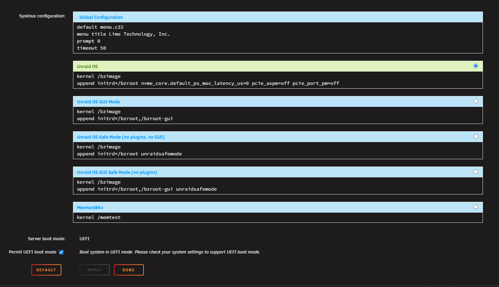

One of the devices dropped offline, try this, on Main click on the flash drive, scroll down to "Syslinux Configuration", make sure it's set to "menu view" and add this to your default boot option, after "append initrd=/bzroot"
nvme_core.default_ps_max_latency_us=0 pcie_aspm=off pcie_port_pm=off
e.g.:
append initrd=/bzroot nvme_core.default_ps_max_latency_us=0 pcie_aspm=off pcie_port_pm=off
Reboot (or power cycle the server if just a reboot doesn't bring the device back) and then see if it makes a difference.

I gave that a try. still not showing. I'm not gonna be physically at its location to try a complete power cycle for a few days, but I did reboot. it shows as unassigned but unmountable. I guess that means its just dead? Fun time for a 2TB drive to die lol

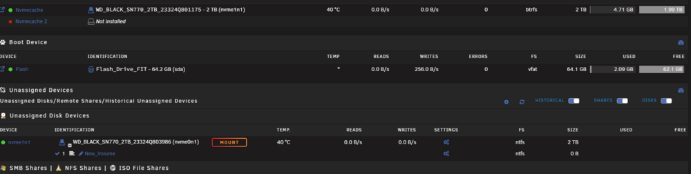

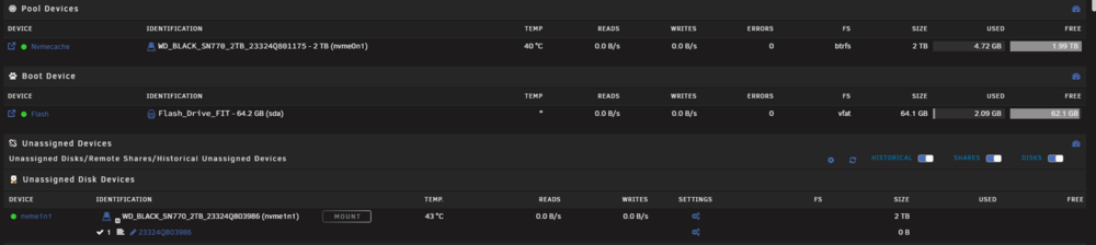

ok, I got the ssd onto a windows machine, deleted the volume in disk management and recreated a new NTFS volume. I installed it into the server and Its now showing up as mountable. my problem now is I'm not sure how to make unraid reformat the drive to use BTRFS so i can add it to my cache? screenshot+diag attachedScreenshot 2026-02-12 161040.png
crusty-diagnostics-20260212-1612.zip

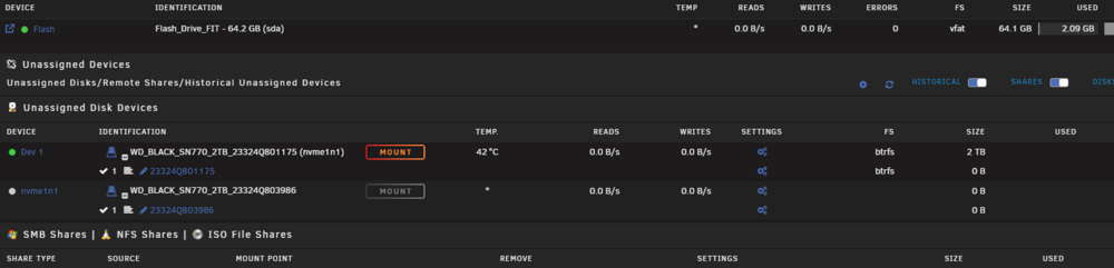

ok i did, seemingly, the same thing again, and this time it seems to have formatted the drive when i started the array. i think I'm good to go. gonna post diagnostics again if you could check if everything is looking ok.
crusty-diagnostics-20260212-1634.zip
The device wasn't correctly added to the pool, since it was degraded, it may require some manual intervention, first reimport the pools wiht just nvme0n1

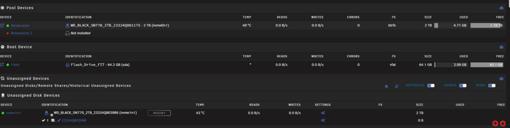

OK i believe I did that as instructed. even though i made it 1 slot it still says its not an uninstalled nvme2?
crusty-diagnostics-20260216-1107.zip
This is expected, now with the array running type:
btrfs balance start -f -dconvert=single -mconvert=dup /mnt/nvmecache
When that finishes, type
btrfs dev remove missing /mnt/nvmecache
Then reimport the pool again, same as above, and it should now only show 1 device.

ok, i did that and then removed the pool, readded the pool with 1 slot and added nvme0n1, it started and seems fine.
crusty-diagnostics-20260216-1523.zip

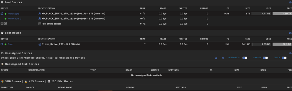

Edit: I found what you meant- blkdiscard* did the rest and attached diag. looks like that worked to me! Thanks for your help with this!
