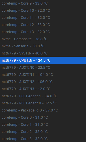

So I installed the Dynamix System Temp to monitor the CPU temps.
This jumped out to me... but this can't be right?
Those look like a false reading.
Hope so.
So I will start the array, watch the CPU temps. And hopefully that will give me an indicator of next steps.
Thanks again for your help!

I assume one of times happened between these two lines, and since there's no shutdown initiated, it suggests a hardware issue, PSU would be a good place to start; also, make sure the CPU is not overheating.
Okay, I think it is the CPU overheating. I was watching the temps as closely as I could, and keeping an eye on the CPU usage on the dashboard and after starting the array for several minutes, everything was fine... however the CPU usage spiked... and then shortly after the system shut down.
I have ordered a couple of new CPUs... I will install and try those when they arrive hopefully later this week. And mark this thread as resolved if it sorts it out.
