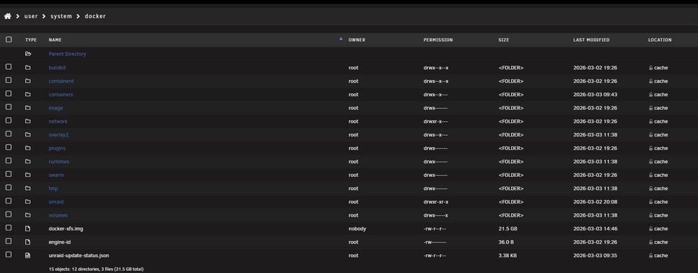

I switched the Docker data-root from directory to xfs vDisk. In doing so Docker created the docker-xfs.img file. As I originally had the data-root set to directory, docker created individual folders for all of the pulled layers and the containers.
My question is this: Can I delete all of the old files that are not not being used because docker created the .img file and now writes to this? If so, which files can I delete or all of them with the exception of the .img file?
The reasoning for this is because it takes up approximately 20gb of space on the cache.

Yes, you should be able to delete them.
If yoh want, you can "test that" by renaming the folder / moving the contents somewhere else, rebooting/restarting docker and seeing if anything changes for you.
But given you're using the image method, you should be able to just delete that folder as it's not being used anymore anyway.

Thank you, that was my assumption as well but I didn't want to pull the trigger without getting some feedback first.

Just wanted to follow up and let you know that I was able to delete everything in the /system/docker folder with the exception of the .img file and everything is working the way it should. Thank you for your input, it was very much appreciated!
